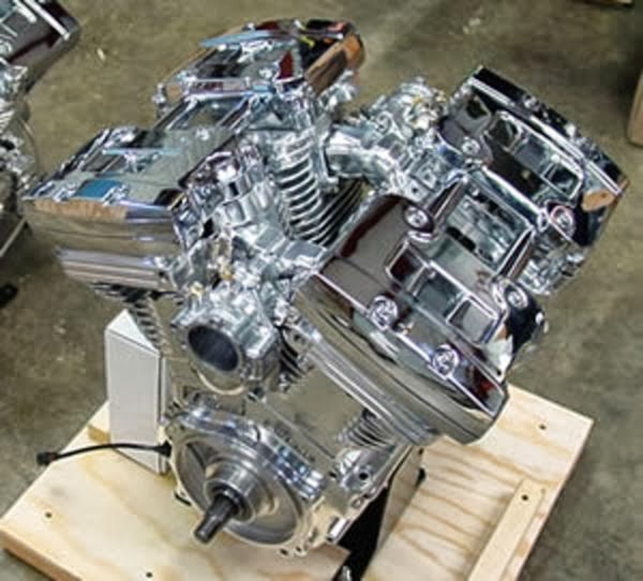

Pulled the 1.7L out of my 1972 914 the other day to chase down some issues ive been having trying to get the engine to turnover properly. and being the freedom loving harley davidson riding american i am (also with constant shit getting i recieve from my roommates) we've been throwing the idea of using an Aircooled V-twin 100cu in plus Harley engine as a powerplant to reduce weight and add power and i can't help to ask why haven't i seen this yet.
so far our idea is build a Flange on the Crank that bolts to an aluminum flywheel then the 914 transmission...
I'm open to ideas and criticism... (IMG:style_emoticons/default/flag.gif)

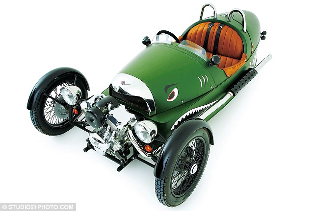

And as a heads-up I just read about the adaptation of the S&S engine to the new Morgan, and they found that the torque pulses from the big V-Twin hammered the drive train so much it broke things. They ended up using a rubber coupler between the engine and transmission to soften the blows.
(IMG:http://www.914world.com/bbs2/uploads_offsite/i.dailymail.co.uk-2618-1444306162.1.jpg)

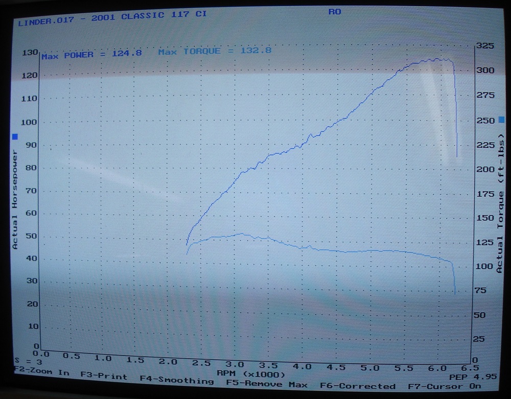

My touring bike has a built 117 ci engine or about 1920 cc. with a bike weight of around 800# and add another 450# of passengers and gear loaded for a trip = 1250# now it does run really good and has no problem exceeding 100 mph for extended periods. ( on a closed course obviously (IMG:style_emoticons/default/happy11.gif) ) having it pull around 2000+ lb car would be underwhelming. when you consider the barrels of cash I dumped into this engine to get it to this point, you would be better served to spend that money on rebuilding the 1.7 into a 2.0, a 2056cc or larger. and everything just fits in.
FWIW here is a copy of my Harley 117 dyno run.. top line is HP read on left. bottom line is torque read on right.
rev limiter is set at 6250 thats why dropoff at end.

Wow, that's impressive torque. I've never seen a Harley (or S&S) graph before. Very cool.
That's a nice readout for a Harley....

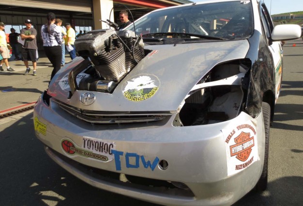

Something like this:
(IMG:http://www.914world.com/bbs2/uploads_offsite/cdn.rideapart.com-1143-1444349677.1.jpg)
That is a Toyota Prius with a Harley motor in it. They call it a "ToyoHog Hybrid-Davidson". It was built for the 24 hours of Lemons racing series. It is the slowest, loudest thing on the track.
Here is a video of it running. We were there watching it race.
https://www.youtube.com/watch?v=yK2AxFpOh14
Fun idea, but if I remember right, it kept eating clutches.
