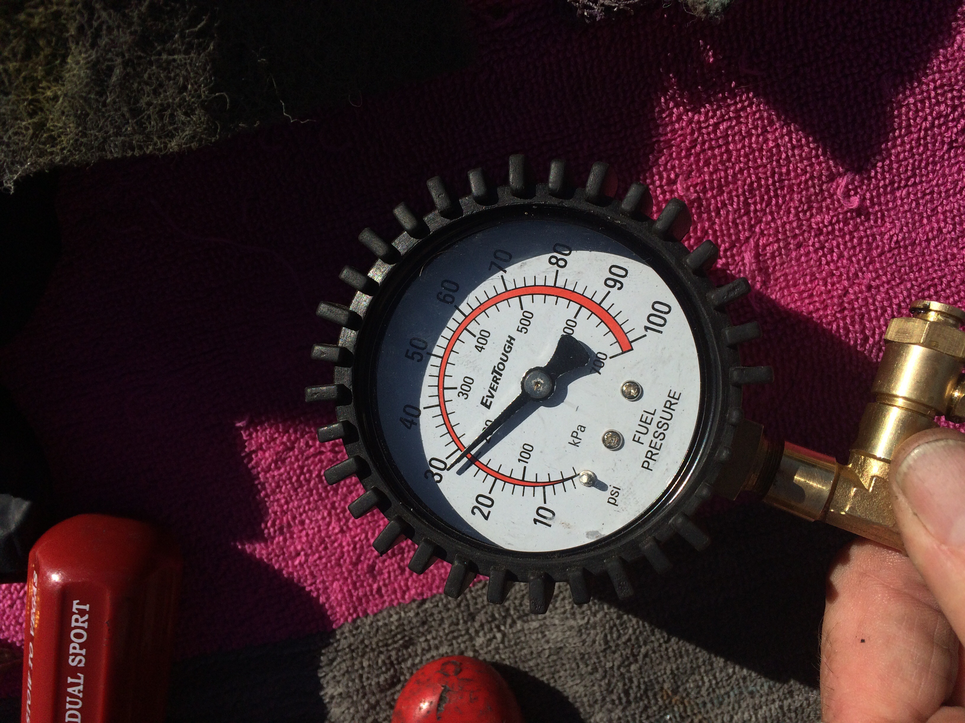

I re-routed the new lines ( almost everywhere) and installed the "Y" as in the above pics (at the fuel pump) ....
29 lbs !
Wow ... Smooth . Idles . Got power .
Super happy . Thanks to all for information.
