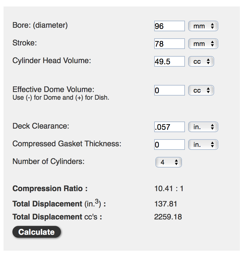

head chamber volume in CCs?
what is bore and stroke?
Jetsetsurfshop

QUOTE(sean_v8_914 @ Nov 6 2015, 04:55 PM) *

QUOTE(Jetsetsurfshop @ Nov 6 2015, 07:52 PM) *
Are concern started because the PO shaved the heads. We are going to a bigger cam and need to add valve pockets.
My experience ,valve pockets only add 2cc-4cc max. , your cam choice
is going to determine what C.R. you should setup ,
10cc dish pistons would give you 9.5cr , valve pockets & a little chamber work, might
get you 10.2 maybe 10.0cr ,
tighter deck = snappier throttle response (IMG:style_emoticons/default/smile.gif) ,
CB calculator
http://www.cbperformance.com/v/enginecalc.html

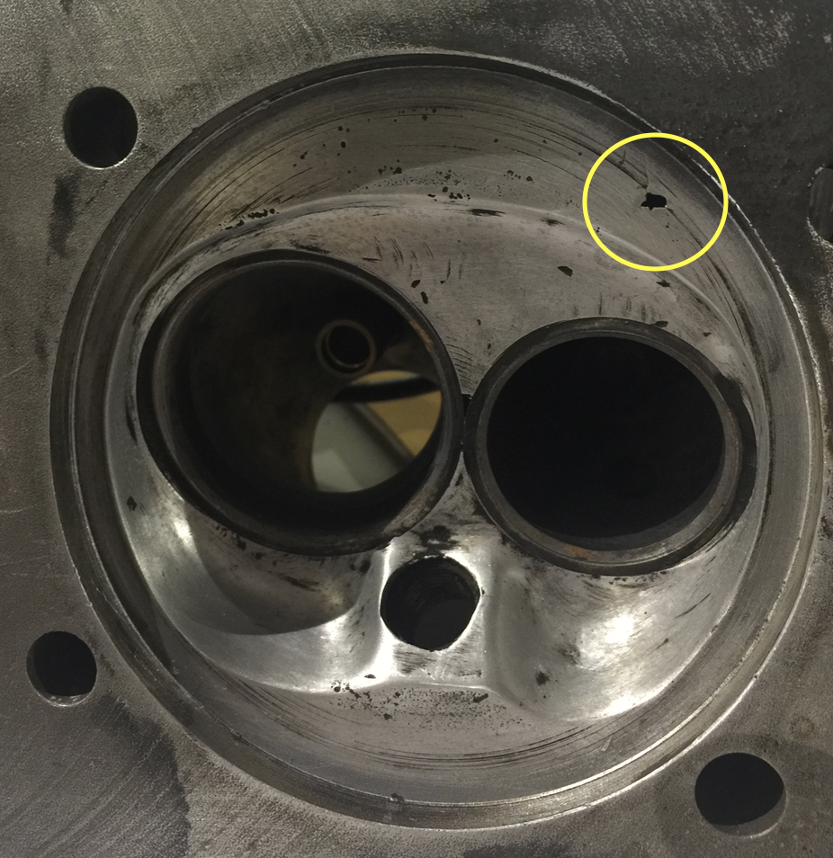

For illustrations of how fly-cutting the heads can result in exposing the exhaust studs, see the cross-sections on this thread:
http://shoptalkforums.com/viewtopic.php?f=1&t=71523
--DD
Jetsetsurfshop
post Nov 9 2015, 04:03 PM
Posts: 815
Joined: 7-April 11
From: Marco Island Florida
Member No.: 12,907
Ok, let me see if I can address everyone here.
First off, its for a track car and we only run 98 octane fuel. So the having a compression of 10 to 1 wasn't a issue. It was what we wanted. I think I said it wasn't me that flycut the heads it was the PO.
Pin hight is already into the oil ring already and I want the compression ratio high.
I dont know who did the heads but they have monster valves and there's R.J. initialed on them.
last thing to address is that i will never cut your heads down this low. What Sturay and Dave said is correct. Check out the picture. The hole was there when we rebuilt it last year. We stuck some JB weld over the hole and ran it in dozens of HPDE's and one 14 hour Chump Car race. When we pulled the head the JB weld was gone and the exhaust stud worked its way out a little bit. We could of just pulled the head and did a quick repair but as a race engine we wanted to see the bearing and camshaft wear. (the web cam was pretty beat, fyi)

Find someone who can TIG weld that hole shut, grind smooth and move forward.
(open it up with a carbide burr first so the hole is well exposed)
Jetsetsurfshop
post Nov 10 2015, 04:55 PM
Posts: 815
Joined: 7-April 11
Member No.: 12,907
QUOTE(Racer Chris @ Nov 10 2015, 07:48 AM) *
Thanks for the advise. (IMG:style_emoticons/default/beerchug.gif) On it.
