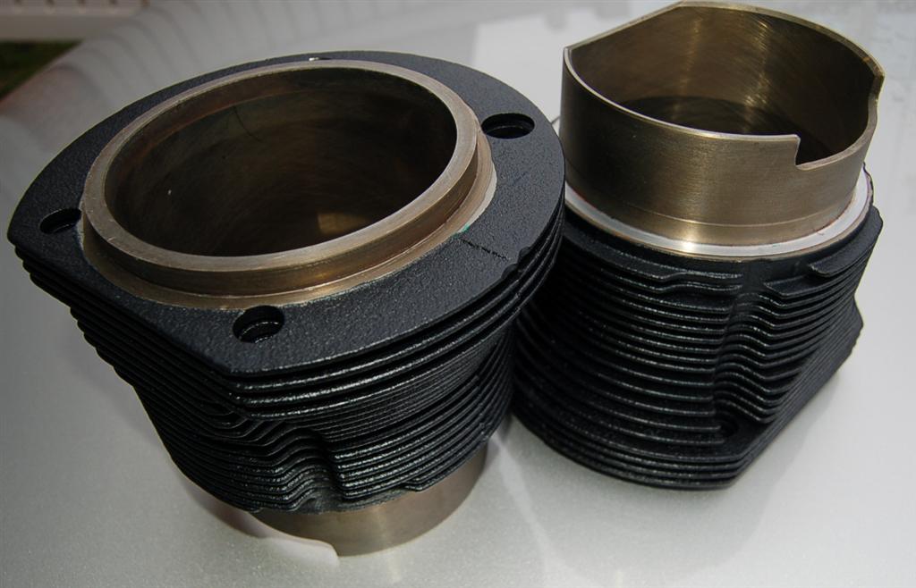

I am getting going to get ready to put a 2056 FI engine together for a daily driver. Trying to decide if the cost is worth the difference. Biral are supposed to run 20 % cooler. Porsche used them for a couple of years and moved on to coatings.

Cost difference is about $80 dollars for set or $20 per cylinder. Biral cylinders are cast iron with aluminum fins. Stock cylinders are all cast iron.

QUOTE(r_towle @ Nov 14 2015, 06:39 PM) *
Do it for 80 bucks...no doubt.
Not to go too far off topic here, but how do the aluminum fin set get bonded to the cast iron cylinder ?
The iron cylinder is cast first, and then the aluminum fins are cast around that. Finally, the iron cylinder is machined to spec. When complete, a biral cylinder is a single contiguous unit. It can also be rebored no problem.
They are lighter than iron cylinders obviously, and dissipate heat better.

914Sixer

I have AA pistons on my 356 motor, 1720 big bore. They seem to be holding up well. Went up there to check out there operation as they are local. Seem to be good people.
There is no slippage on Biral since the aluminum is cast onto the iron sleeve, which has ridges to keep the formed aluminum in place. 356 cylinders were biral from the factory. No problems with this.
PotterPorsche

I have heard of earlier low-cost birals having slippage issues. I dont' know if it was AA, though.
I don't think I'd bother for a street-driven 2056, myself. Cast-iron has proven itself for that config over and over again.
