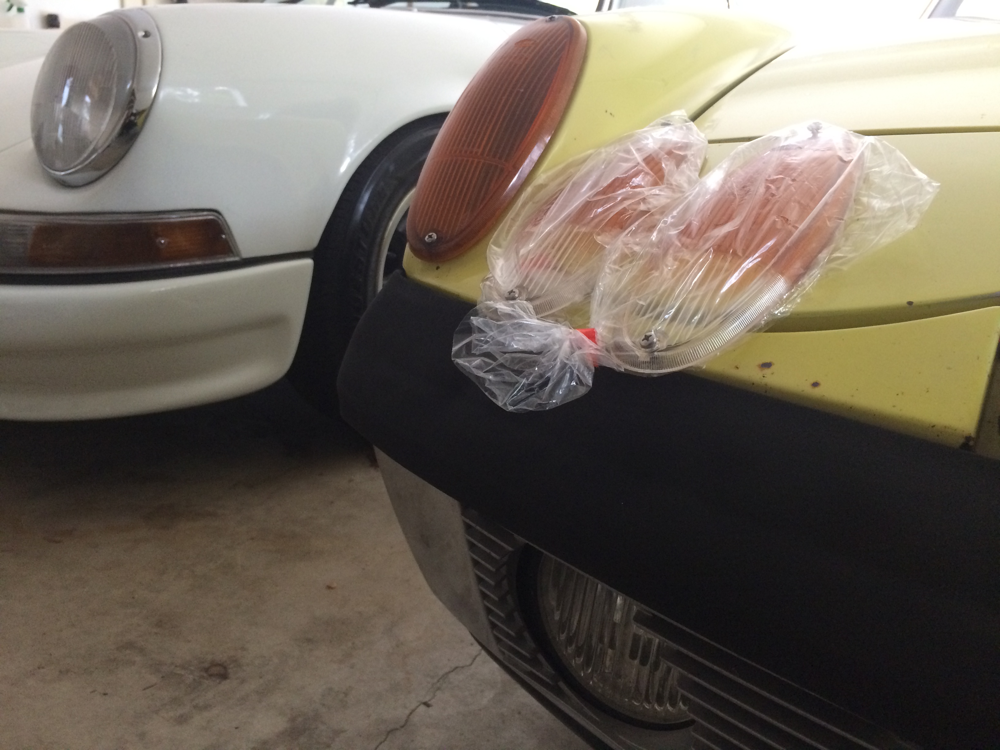

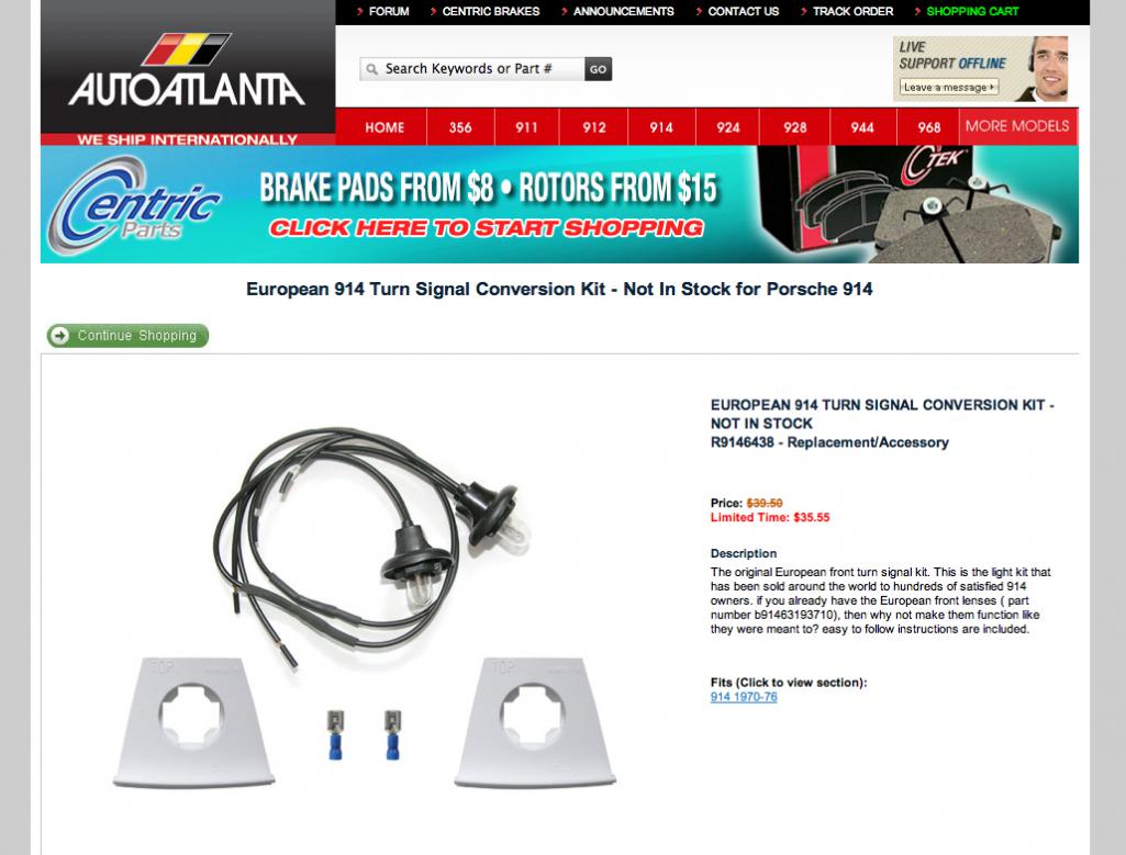

A while Back I got this NOS front european turn signal leans kit.
Now I want to do it properly, and convert the bulbs from one to two.

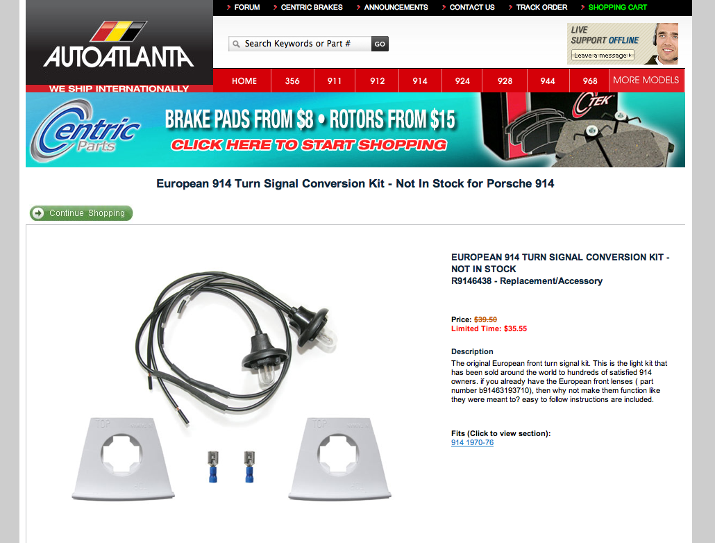

I saw this Kit on AA (and I like to avoid AA as much as possible) and I wonder, if it is any good? Also it is out of stock… (IMG:style_emoticons/default/dry.gif)

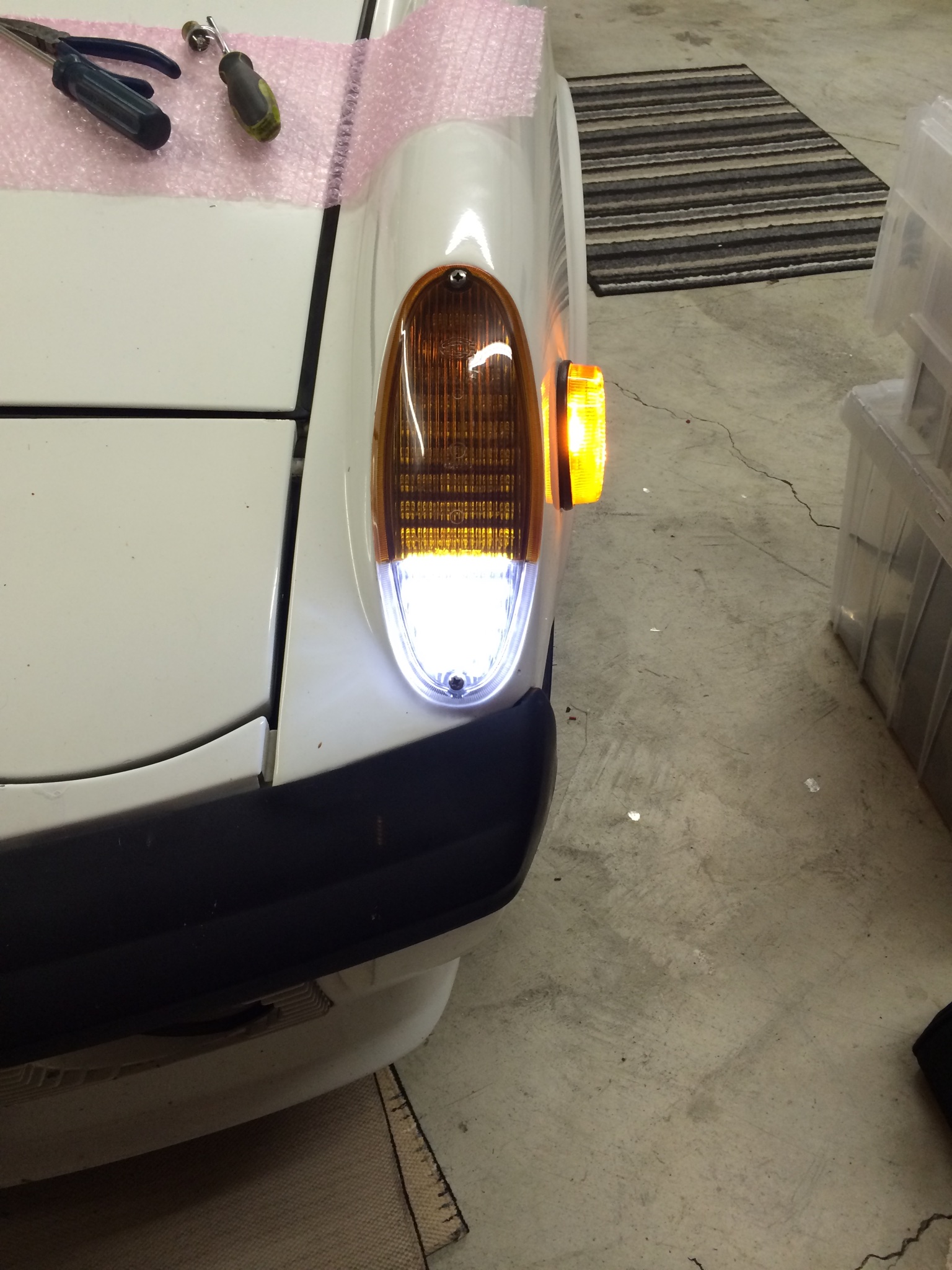

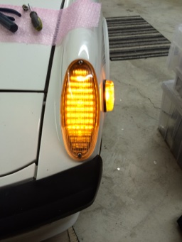

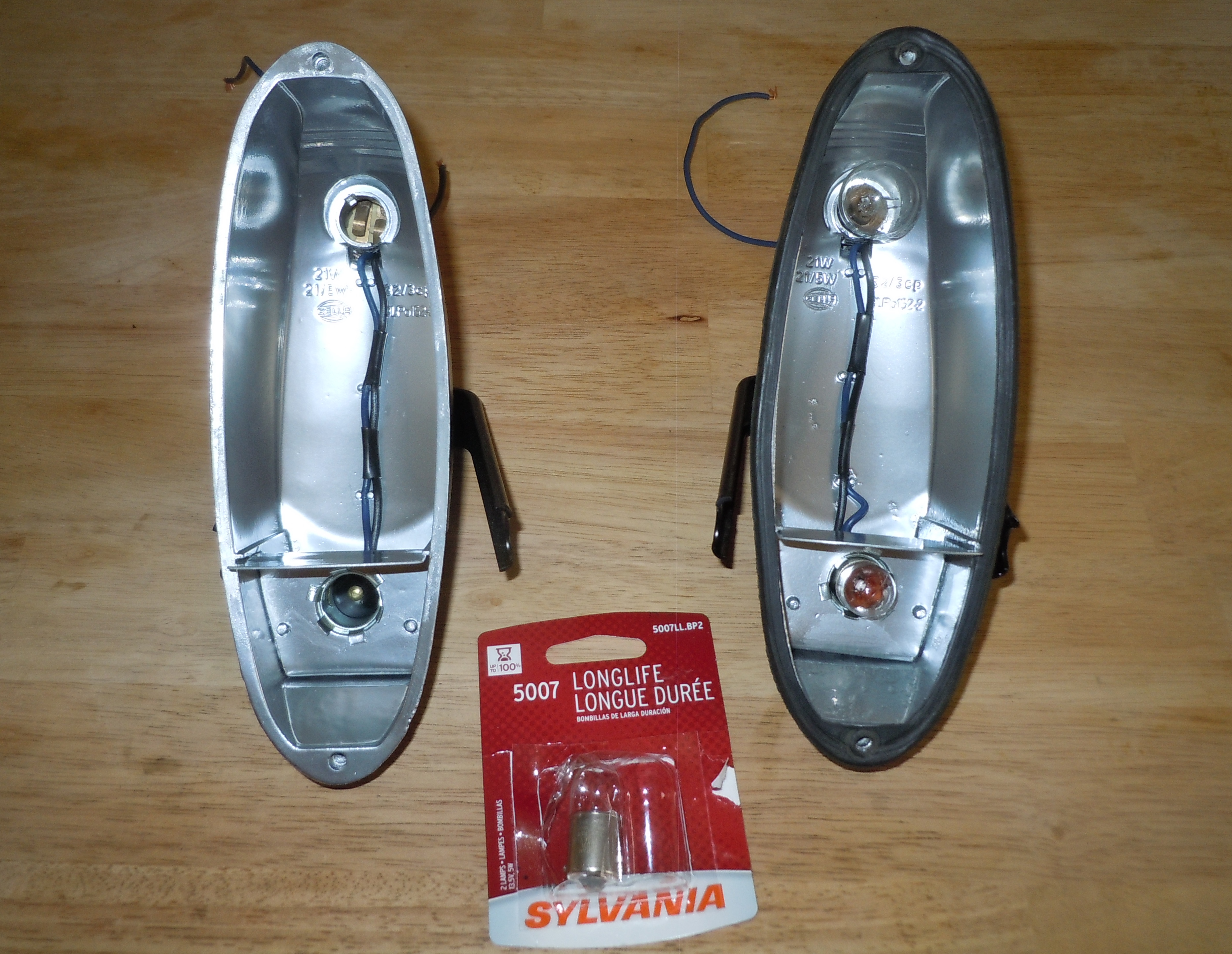

Easy to make your own.Attached Image

If Spoke makes them again that is the best. The kit like Camp and AA sells is marginal. I have a set I didn't use and would give it away free for shipping and that would be next to nothing...

QUOTE(SKL1 @ Nov 28 2015, 04:40 AM) *
Correct these kits are disappointing,a poor fit into the stock housings,joins in the wiring that make them hard to run, I also found them not very bright and changed to larger lamps which was an improvement.
Had I known I would have bought the metal housing ones on German ebay,they appear to be more like the originals (IMG:style_emoticons/default/confused24.gif) .

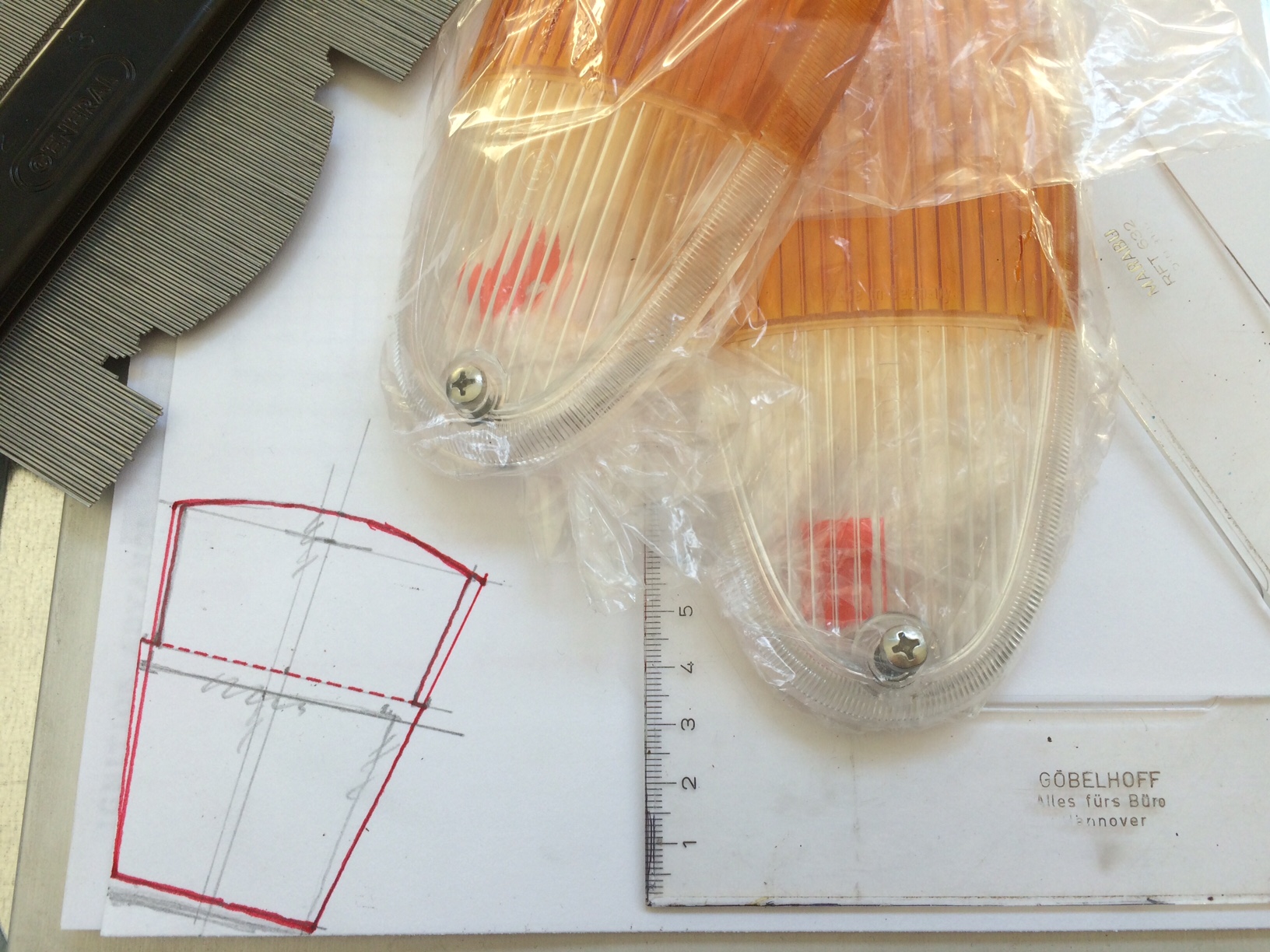

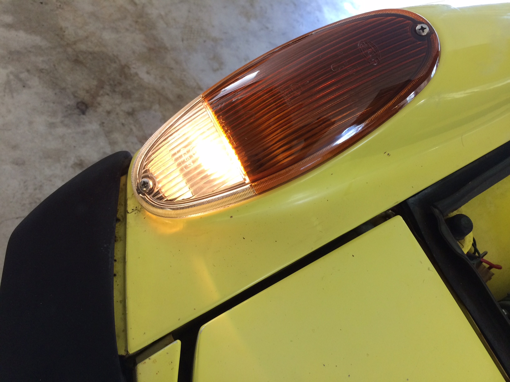

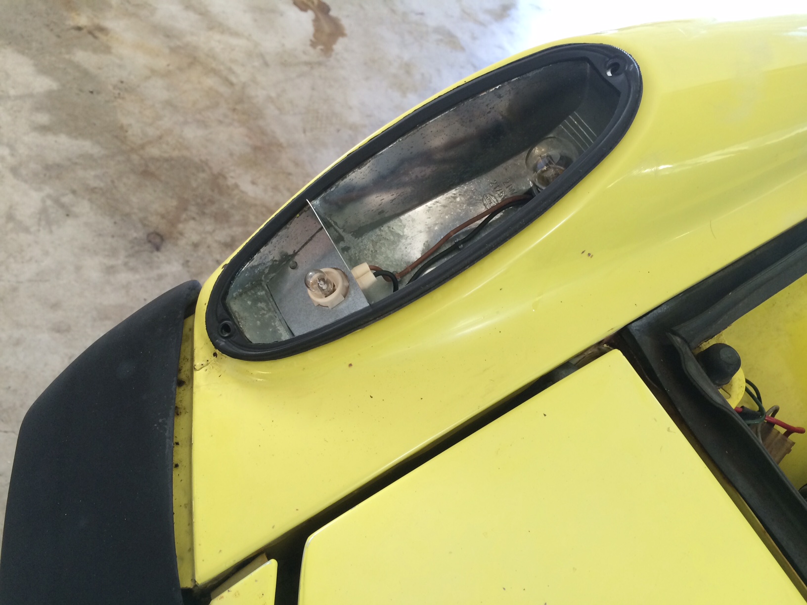

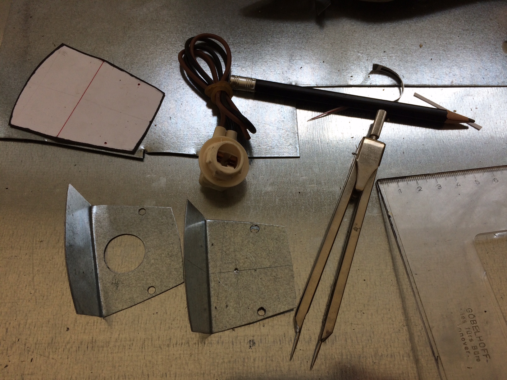

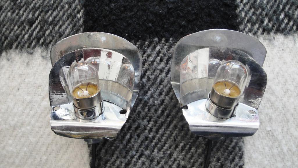

So after you all gave me such great advise, I just decided to make it myself...
Here are some Pictures:

QUOTE(CG-914 @ Dec 29 2015, 08:04 AM) *
I like your DIY ingenuity but what is that little metal thingy with the pointed ends? Have not seen them since the '70s... Maybe came in the tool kit?
Is your bulb as bright as the Spoke LED solution?
I need to do what you are doing. Thanks for the thread!
michael7810
post Dec 29 2015, 12:54 PM
Posts: 1,082
Joined: 6-June 11
From: Scottsdale, AZ
Member No.: 13,164
Wonder how much of a difference it would make if you wrapped the new sheet metal with foil?

QUOTE(Hank914 @ Dec 29 2015, 01:17 PM) *
A compass ?
Not included in a tool kit
bandjoey
post Dec 29 2015, 03:31 PM
bandjoey
Posts: 4,935
Joined: 26-September 07
From: Bedford Tx
Member No.: 8,156
Model shops sell 'real' chrome paint for more shine
It is a compass. I got it out of my dads architecture stuff, I'm sure he has it till the 70s...
They are pretty bright right know, it is galvanised sheet matel so it reflects the light pretty good.
