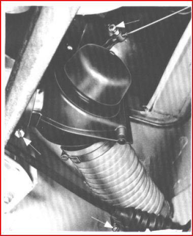

Porsche Workshop Manual shows arms on top:

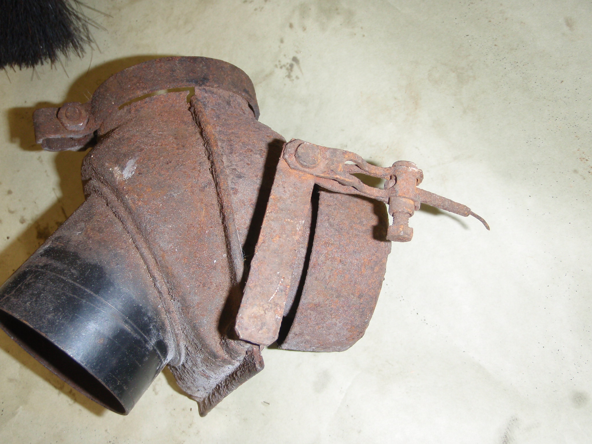

I can't tell from your picture, are your arms two pieces? They are two piece with an elbow in the middle. If you only have one part of the arm, your cables are going to be to short. And you won't have the loop that the barrel nut slips into that is on the end of the outer arm. Just a thought...

Good and krusty, but it's all there.

QUOTE(Gint @ Jan 6 2013, 02:23 PM) *
Well thats what good old New England Driving will do for your parts! These came off of a Maine car. Almost everything had to be cut off for restoration.

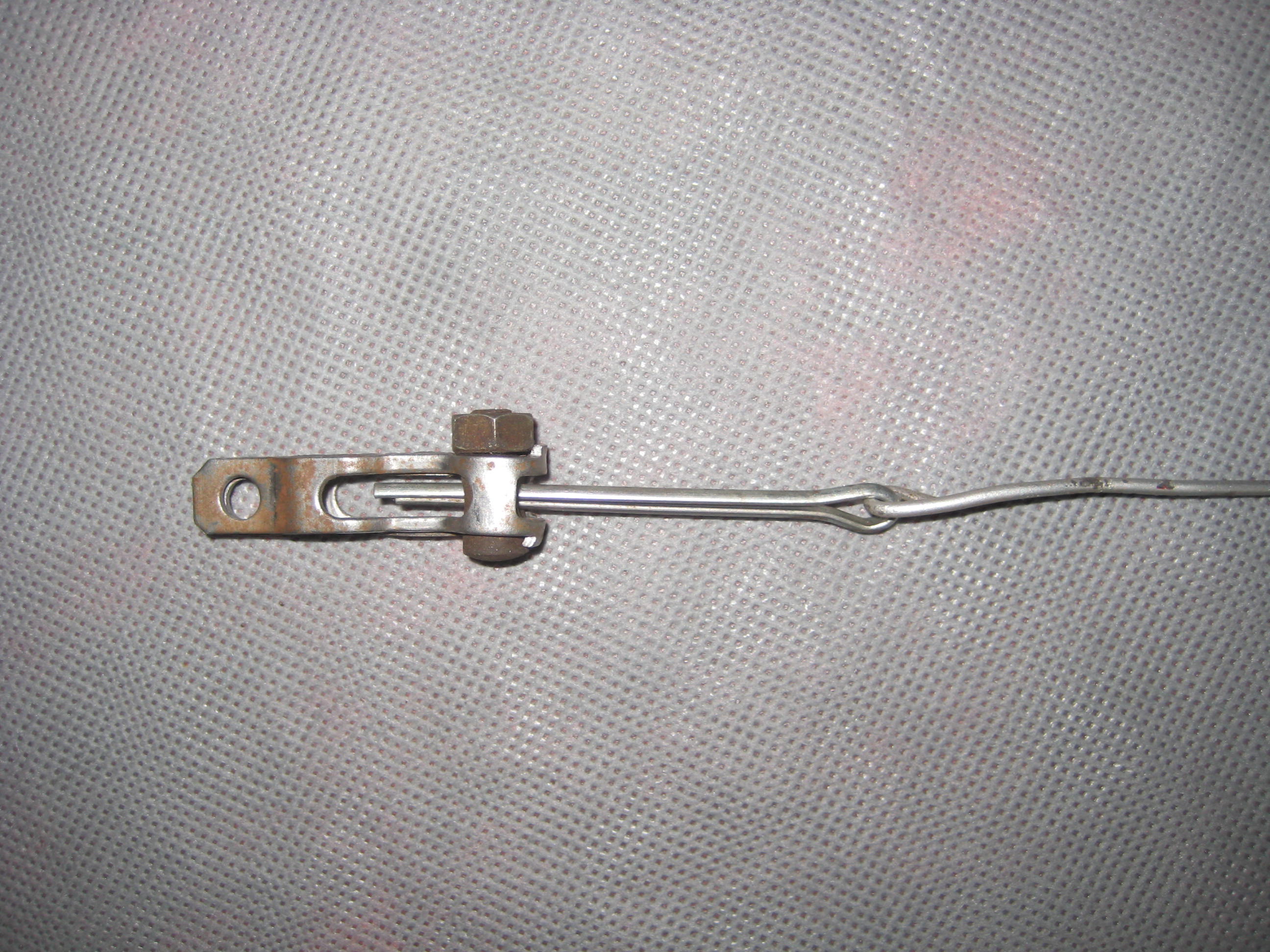

Use a long cotter pin to replace missing wire ends.
The cotter pin goes through the barrel nut.
The broken wire end is looped through the hole in the cotter pin.
Easy fix.

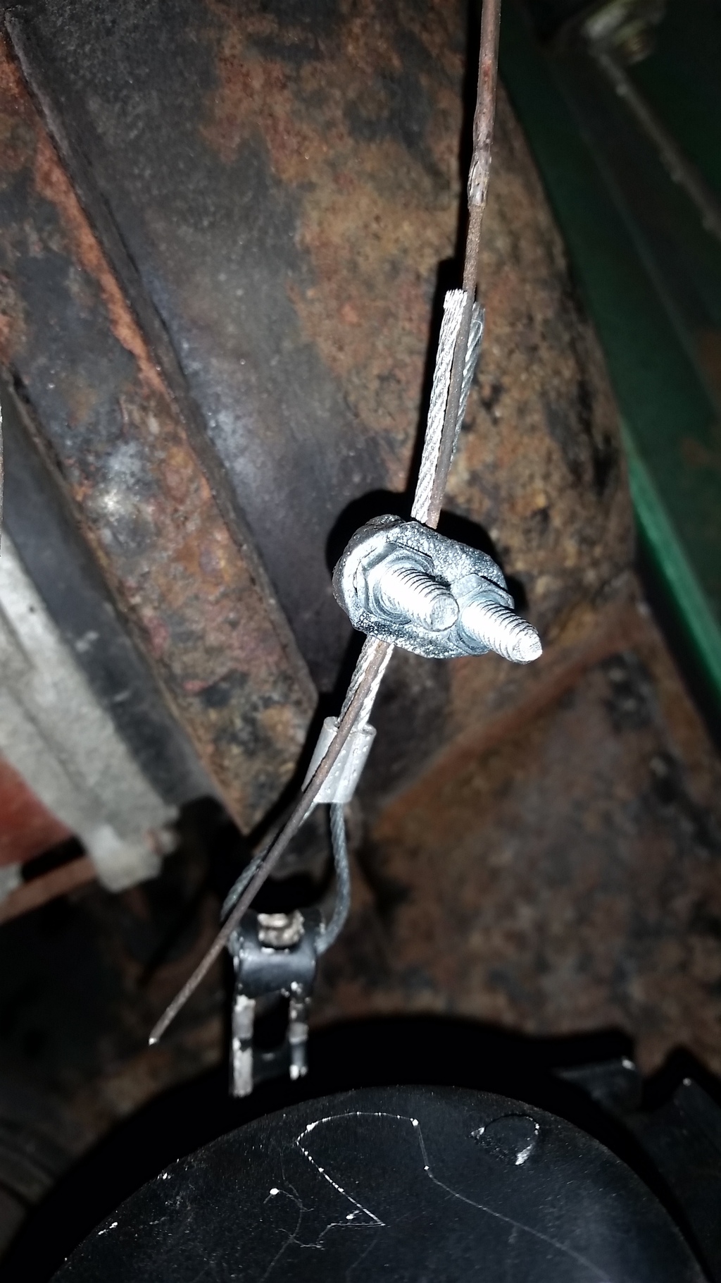

I don't usually post pics of my work but this qualifies for at least honorable mcguyver mention. I used @Spoke's idea of a piece of cable and u-clamp and @Barefoot's idea of crimp sleeves, used cable ferrules. So far works fine - I'll buy the real parts if it fails!
(IMG:http://www.914world.com/bbs2/uploads_offsite/i1240.photobucket.com-18519-1448645408.1.jpg)
