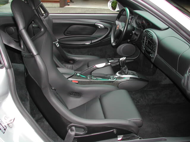

I've always been a fan of the 996.2 C4S, great looking car. I would love to have one as a daily driver (or daily park-er in my non-driving case). It would make a great family hauler for car events and stuff. The 914 doesn't work well taking the wife and kid.
BTW the interior looks great with the lower console delete (gives it a more '911' look in my opinion):
