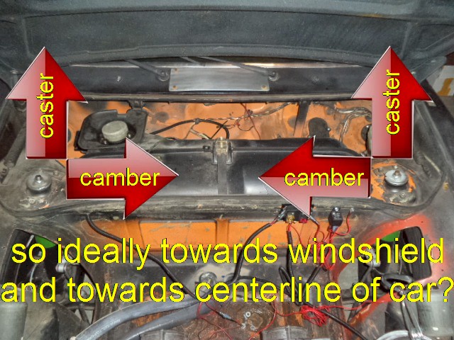

do I have this right for front?

Just don't max out your "toe-in" (adjusted at tie-rods) - it has to be measured. Your Inward facing arrows will adjust for negative camber. From what I've been told you want anything between 1/8" OUT for AX and zero to 1/8" IN for street and road racing applications. Regarding the caster...you're correct.

QUOTE(jimkelly @ Nov 28 2015, 08:03 AM) *
Yes, you have it right.
The key is one side will go less than the other.
You need to match them, so pull one side back to however far you can get the other side.
Move tower, set car on suspension, roll car back and forth about 3 feet, and bounce it up and down, then measure.
It takes a bit of time, but it's all fairly simple.
Rich
