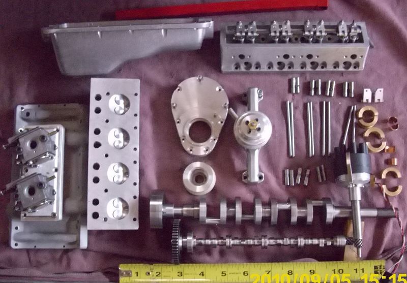

You can make anything you put your mind to. . .
My Chevy V8, most from scratch.
Crank took 2 weeks, cam 1 week. . both from solid round stock . the
roller rockers were the hardest because I needed 16 identical. .

QUOTE(toolguy @ Jan 4 2016, 09:04 AM) *
That's impressive!

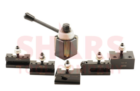

I think I'll be getting this set:

http://littlemachineshop.com/products/prod...20Tools%20Lathe
http://www.yellowpages.com/orlando-fl/mach...hop-tool-supply
These are some basic tools to get started,do try to be a csob as a money pit is right in front of you.

I'm guessing the lathe has no toolpost holders,which is why you're looking to purchase a set.
You won't need a large capacity,3/4" will suffice.
(edit)I see in the photo up top,the post you have will do fine for your application.
The quickchange holders are for production speed and repeatability,can be useful for toolroom applications,setup speed.
