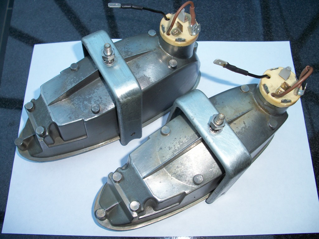

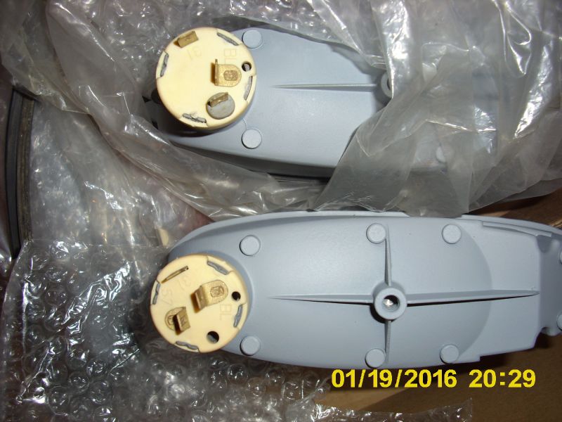

The lower white portion is the parking lights. . Yellow is turn.
In a real Euro light bucket, the top [turn] connector is a single filament
socket, The spade wire connectors have a different physical arrangement than a USA bucket.
Euro bucket is on the top in the picture, notice the single spade with the insulated base. . this is the lower [white] light lead

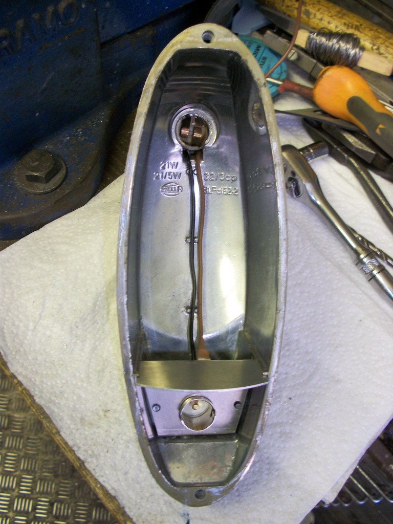

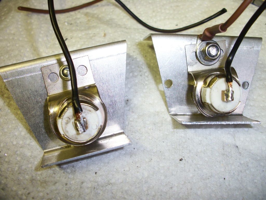

Fabricated bulb holders
(IMG:http://www.914world.com/bbs2/uploads_offsite/i265.photobucket.com-18255-1453290894.1.jpg)
Fitted into housings
(IMG:http://www.914world.com/bbs2/uploads_offsite/i265.photobucket.com-18255-1453290894.2.jpg)
Cables fed through existing holes inside insulated part of housing
(IMG:http://www.914world.com/bbs2/uploads_offsite/i265.photobucket.com-18255-1453290895.3.jpg)
Change amber lens to split clear/amber
Feed power to new bulb from removed marker lamp cable. I only ran extra earth for peace of mind. US lamp housings have pins cast to hold the extra power cable. I heat shrunk over old terminal thats made redundant to prevent confusion in what to reconnect. Use standard twin bulb in amber position but only one filament in use (otherwise its a bigger job to change bulb holder)
You can check out in more detail in my Build off challenge thread as its updated !

Mine were awful, covered in stone guard, tar, sand and dirt.
White spirit and a brass bristle detail wire brush got them like you see in the pictures.

what type of bulb / bulb holder is this using please?
GeorgeKopf
post Aug 28 2021, 07:46 PM
Posts: 255
Joined: 9-February 21
From: Princeton, NJ
Member No.: 25,186
I think I found those 1156 bulb holders.
https://www.amazon.com/BA15s-Bayonet-Socket...3163&sr=8-3
or
https://www.amazon.com/gp/product/B00R50E8W...DKNY9&psc=1
Looks like they have been bent up to parallel with the plate.
