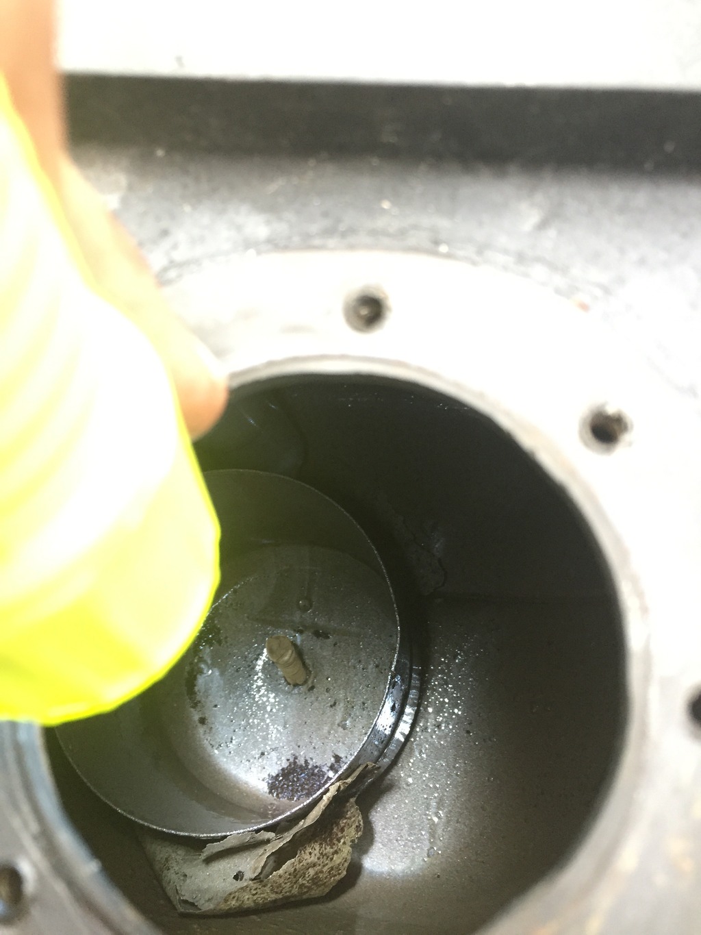

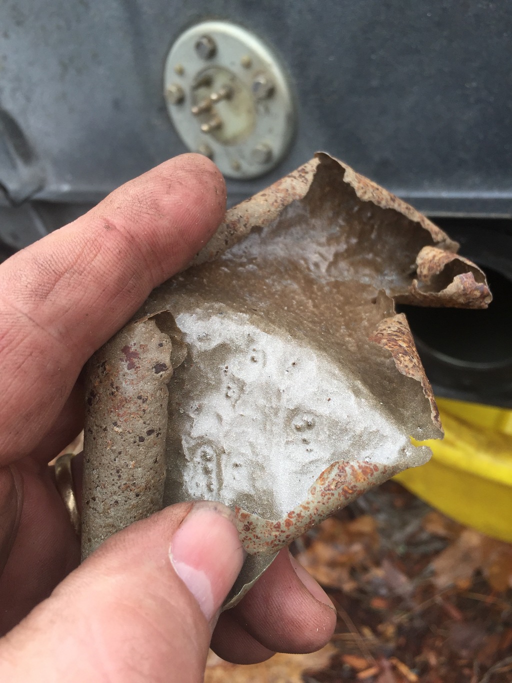

I'm going through this now with my tank, the PO has it coated with POR-15 and I pulled the tank to replace the lines and found this...
(IMG:http://www.914world.com/bbs2/uploads_offsite/i219.photobucket.com-19045-1453385103.1.jpg)
(IMG:http://www.914world.com/bbs2/uploads_offsite/i219.photobucket.com-19045-1453385103.2.jpg)
my tank is currently with these guys getting striped and cleaned and they also have a coating process and I have chosen not to have it coated.

I assume you mean you are not having the inside coated? That was my original intention but given the pinhole leaks I did not really have a choice.
