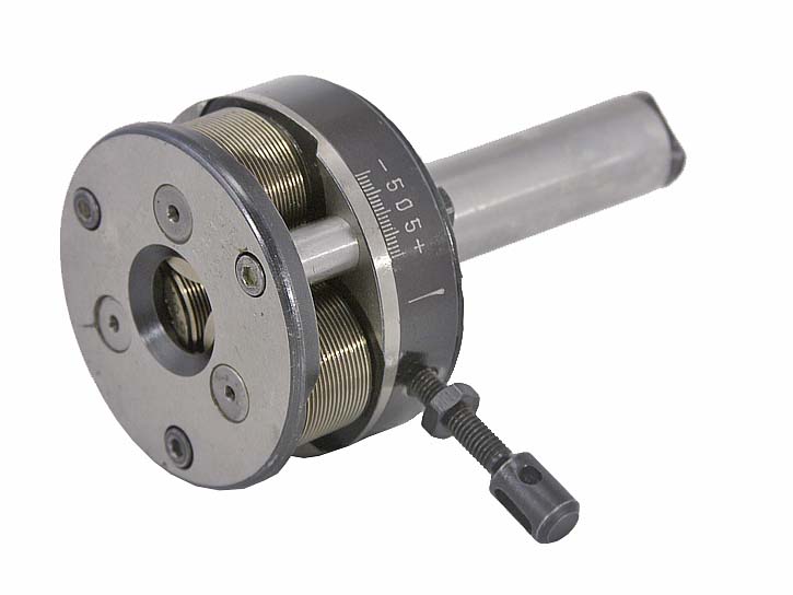

Broaching or shaping,rolling or milling?
https://www.google.ca/search?q=spline+shapi...c27AjEQ_AUIBygC
https://www.google.ca/search?q=rope+thread+...rolling+process
https://www.google.ca/search?q=spline+milli..._IjncQ_R52HM%3A

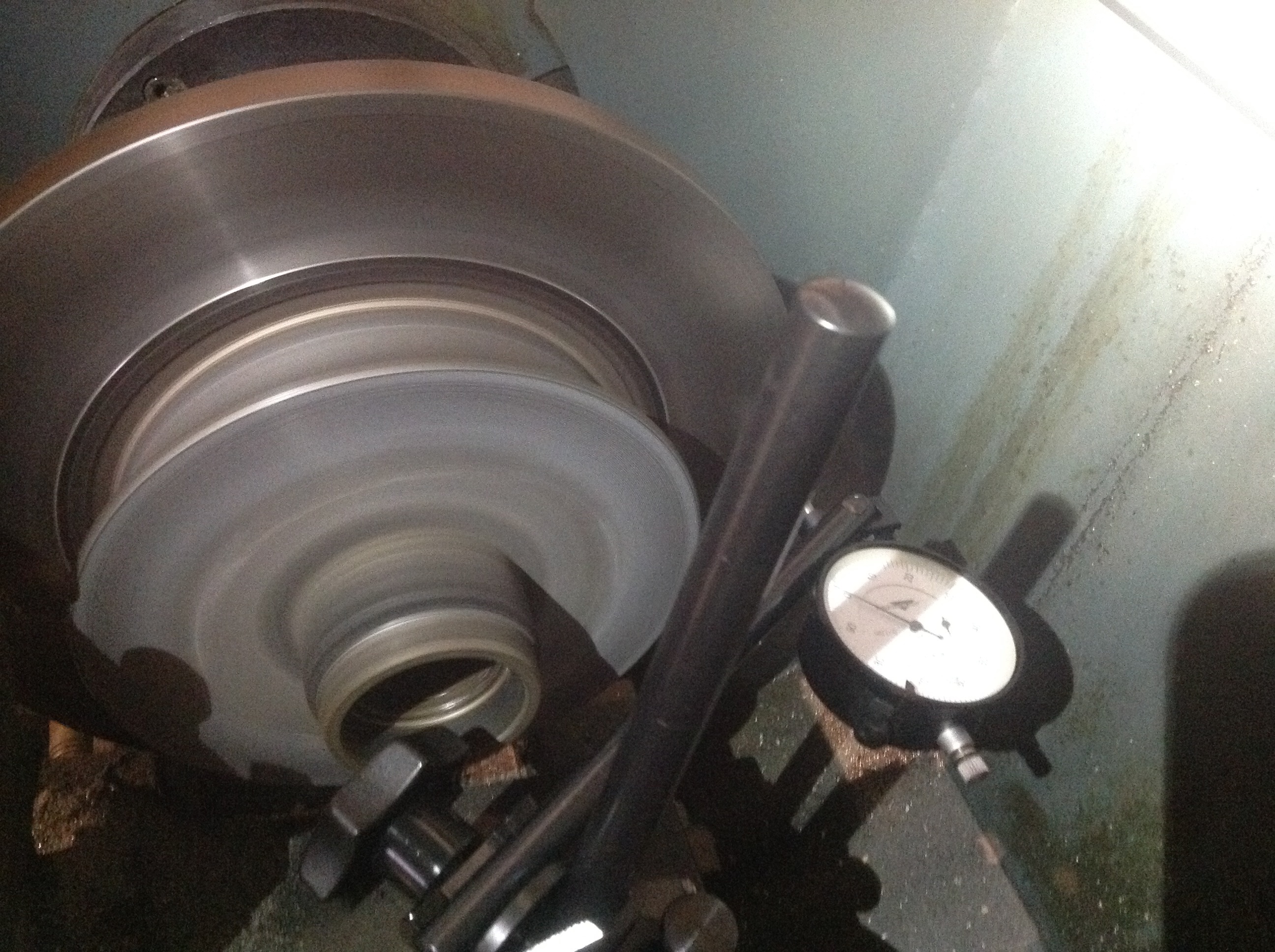

Observations from the mind of a beginner on the lathe:
Not having quick-change tools with adjustable height is complete bullshit. That will be corrected shortly.
The "simple" task of chucking a lug nut is not simple at all. It's almost impossible to get them to spin true. I have discovered this is because the bolt head and the threaded shaft are not necessarily manufactured on the same axis. This makes the "easy" task of turning a flat shoulder out of the conical seat very difficult if you want it to be perpendicular to the axis of the threading.
With the (?) tooling I found with the lathe, I can face steel at about 1mm per pass at 260 rpm. If you get greedy or impatient and go for 1.5mm per pass, you will be looking for another tool.
I ruined a parting tool, so I need more information on its correct use. Once I ruin the tip on a parting blade, how do I fix/sharpen it again? Can I?
On a positive note, I was able to put that brake rotor I ruined back on the machine. I got the wheel face turning within .001" and was then able to make the braking surfaces do the same. On my previous effort, I had managed to turn the outer face to a runout of .006" and the inner face to .01". Ouch. (IMG:style_emoticons/default/laugh.gif)

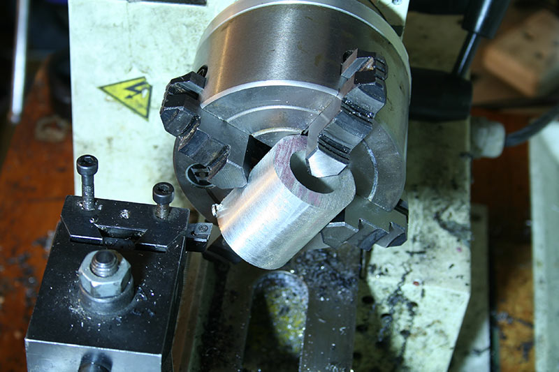

I like to use what's called a "dial test indicator" for setting up stuff on a lathe.... different than a "dial indicator". The feeler nub has less range of motion but it springs back to position on its own.
About the issue with the lugs having multiple axis for the heads/threads, you can use a 4 jaw independent chuck, vs the universal 3 jaw. They take longer to set up but more accurate. The test indicator becomes very handy with an independent chuck.

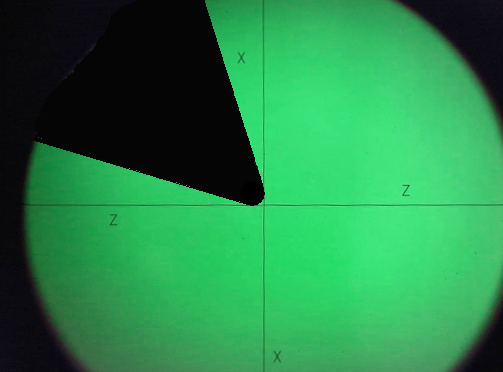

Most of all these are all solved techniques,doing it for like,forever.
https://www.google.ca/search?q=wartime+wome...OF9vsdonD5SM%3A
(edit:2/23/16)
https://www.google.ca/search?q=carbide+inse...Nqs2bbXrH_-M%3A
The nose radius of the tool in the picture is not the IC of the tool.
The nose radius is a variable to which compensation is applied on manual,nc and cnc machines,when radii or slopes are machined.
In general,a nose radius imparts it's form to shoulder intersections when using manual machines.
For a larger shoulder radii with a smaller nosed tool,'stair-step' the large rad using trigonometry calculations of gradually finer resolutions.

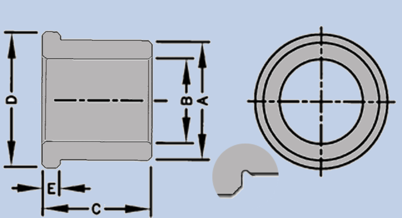

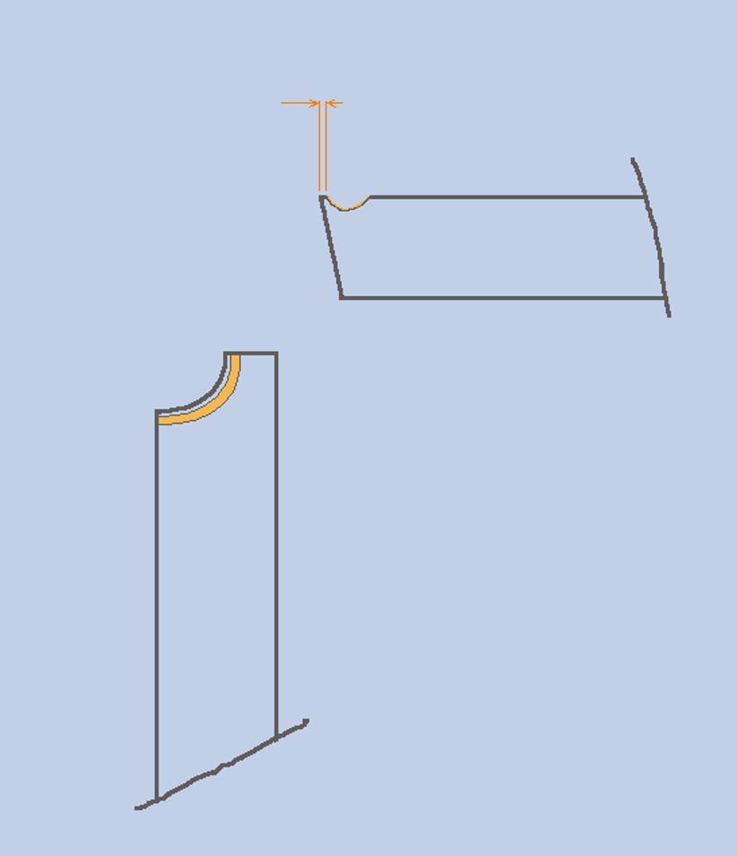

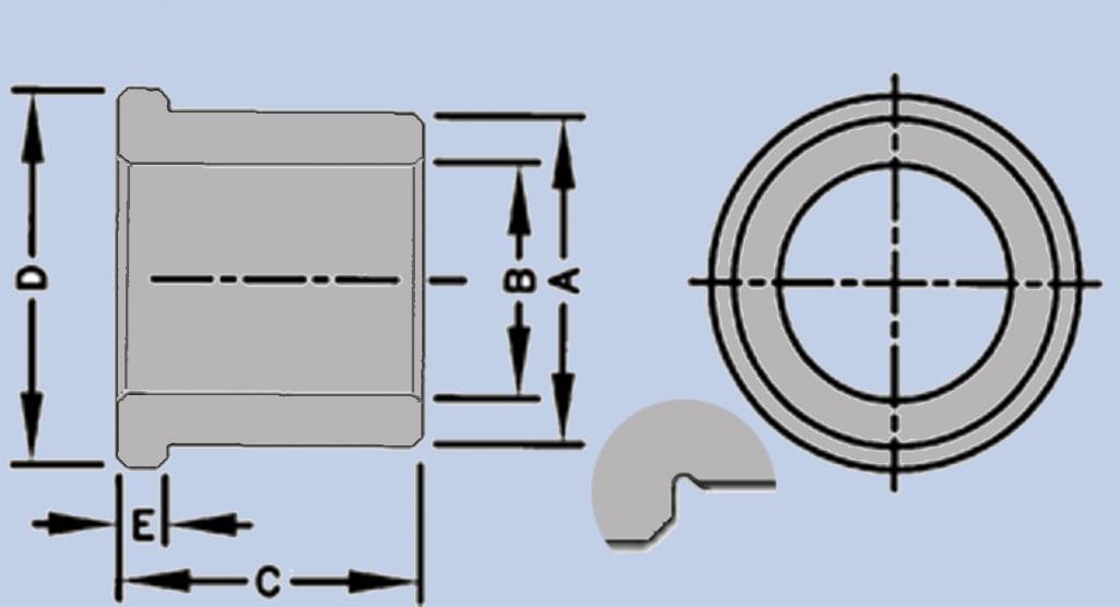

Making your own bushings is a handy skill.
Turning(cryogenically) dry-ice or nitrogen frozen rubbers and plastics calls for hss tool grinding and diamond honing.
Form tool geometry for those materials and some light metals requires high positive rake.
A carbide ball tool in a die grinder can create a groove in the top surface of the hss shank,a kind of 'moat'.
The relief flank is then ground to give a .005/.007" wide top face and positive chip rake.
With some practice and a toolmaker's microscope,a <16rms finish can be achieved.

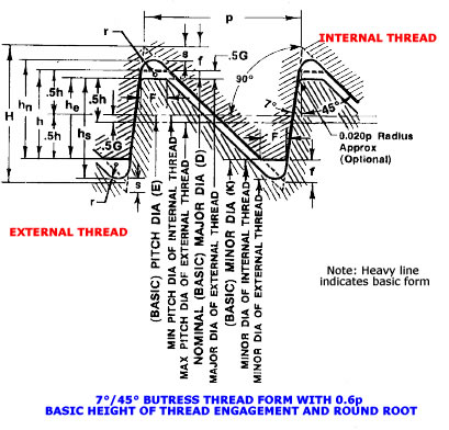

Thread rolling for fun.
https://www.google.ca/search?q=thread+rolli...I0PmuZ6LetkM%3A
Thread turning on a lathe:
https://www.google.ca/webhp?sourceid=chrome...urning+on+lathe
Pitch diameter,metric,thread series,3-wire measurements and calculation of fits.
https://www.google.ca/webhp?sourceid=chrome...d+specification
Need to know.
