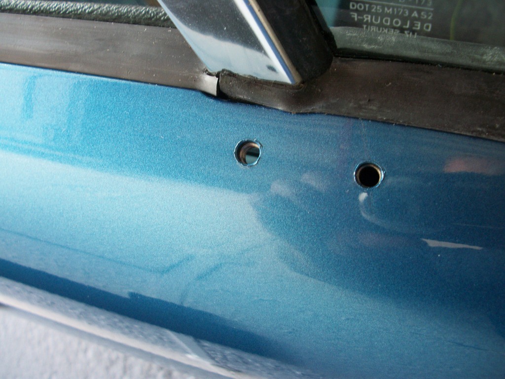

Use the internal punch method to mark the exact positioning, drill from outside in ever increasing drill sizes 2.5mm up to 6mm to check you’re not drilling off centre and cutting into the captive thread. (If you go off centre you have time to recover it at small drill diameter using a swiss rat tail file to get you back on track).
(IMG:http://www.914world.com/bbs2/uploads_offsite/i265.photobucket.com-18255-1454575232.1.jpg)
