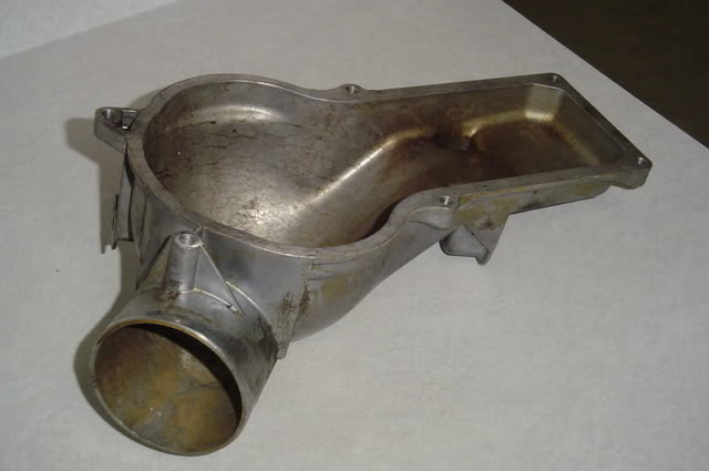

The CIS can be flipped around 180 degrees and will fit with some extra work. New hard fuel distribution lines would need to be bent, but that is quite doable. The engine lid latch may need to be removed, possibly replaced with racing-style tie-downs.
Other people have fit the CIS by notching the rear trunk wall (a la the Chevy conversions) or even by notching and gluing patches into the CIS boot itself!

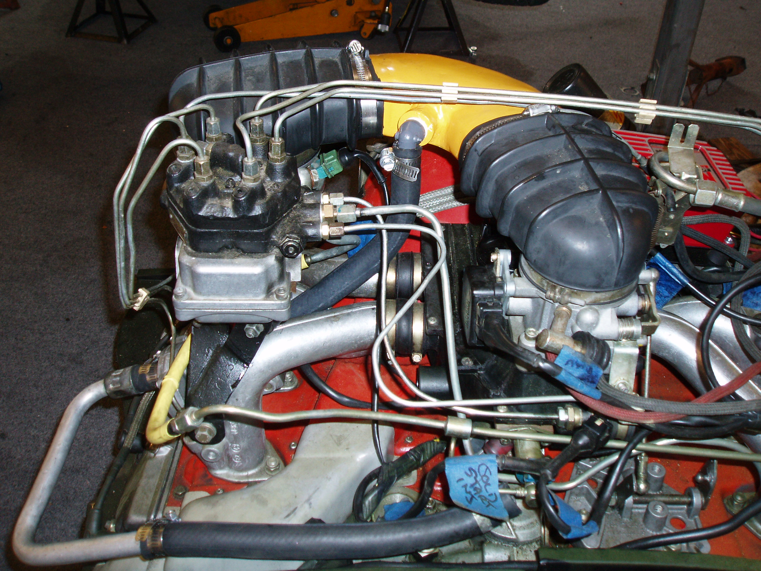

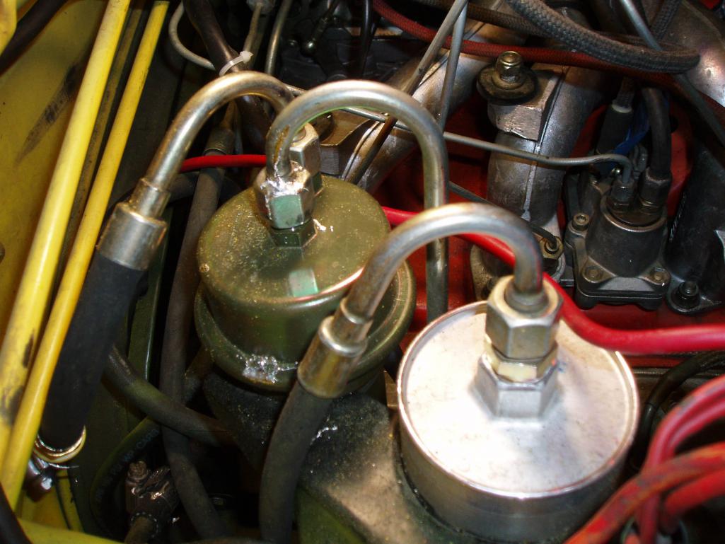

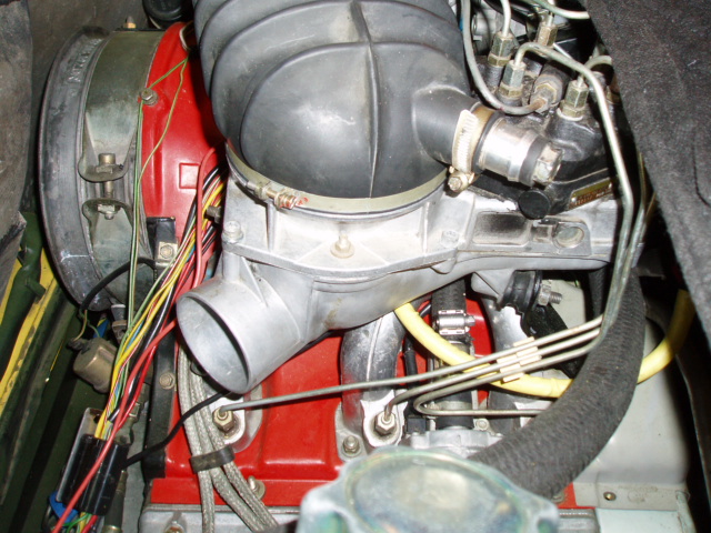

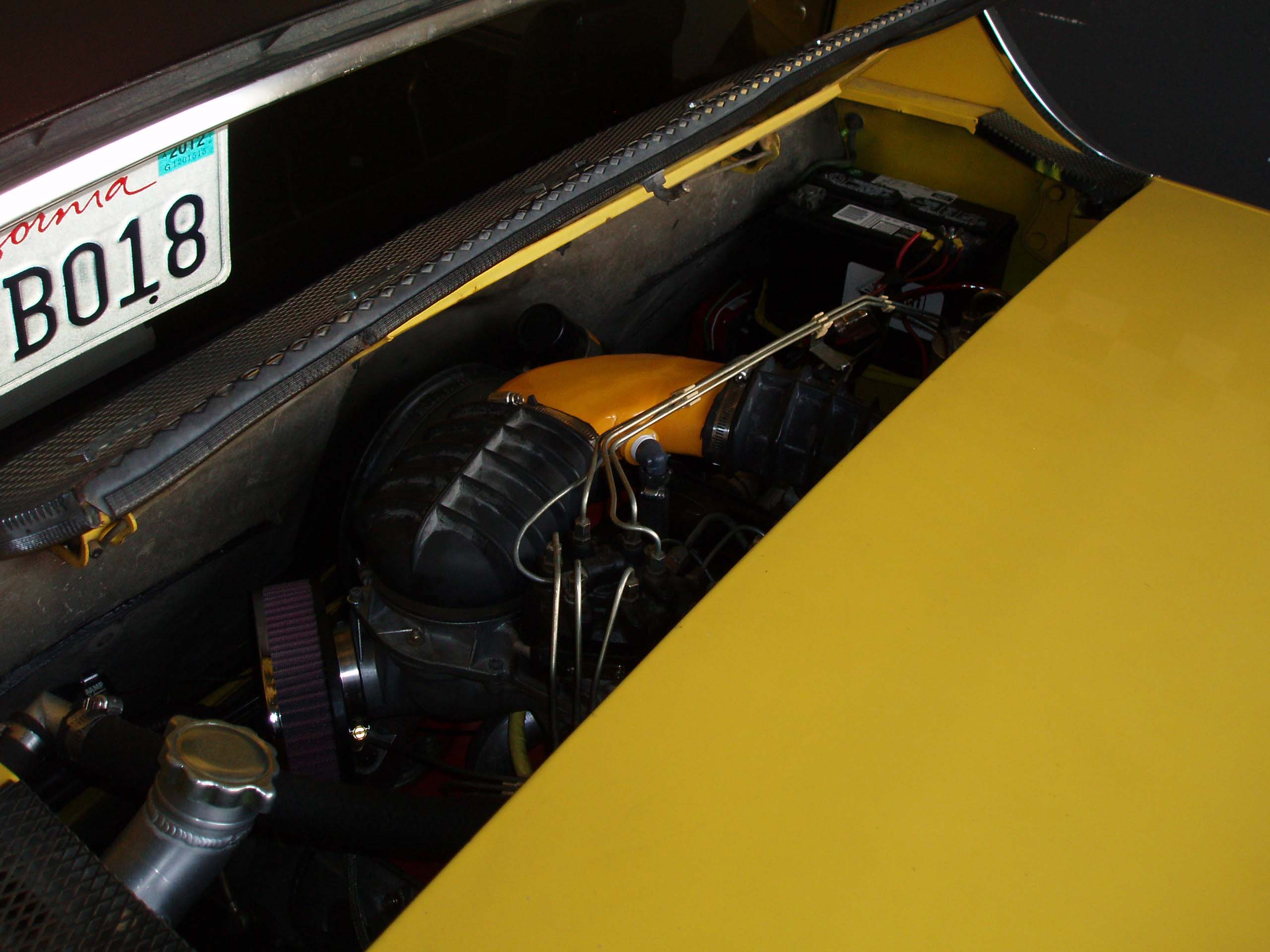

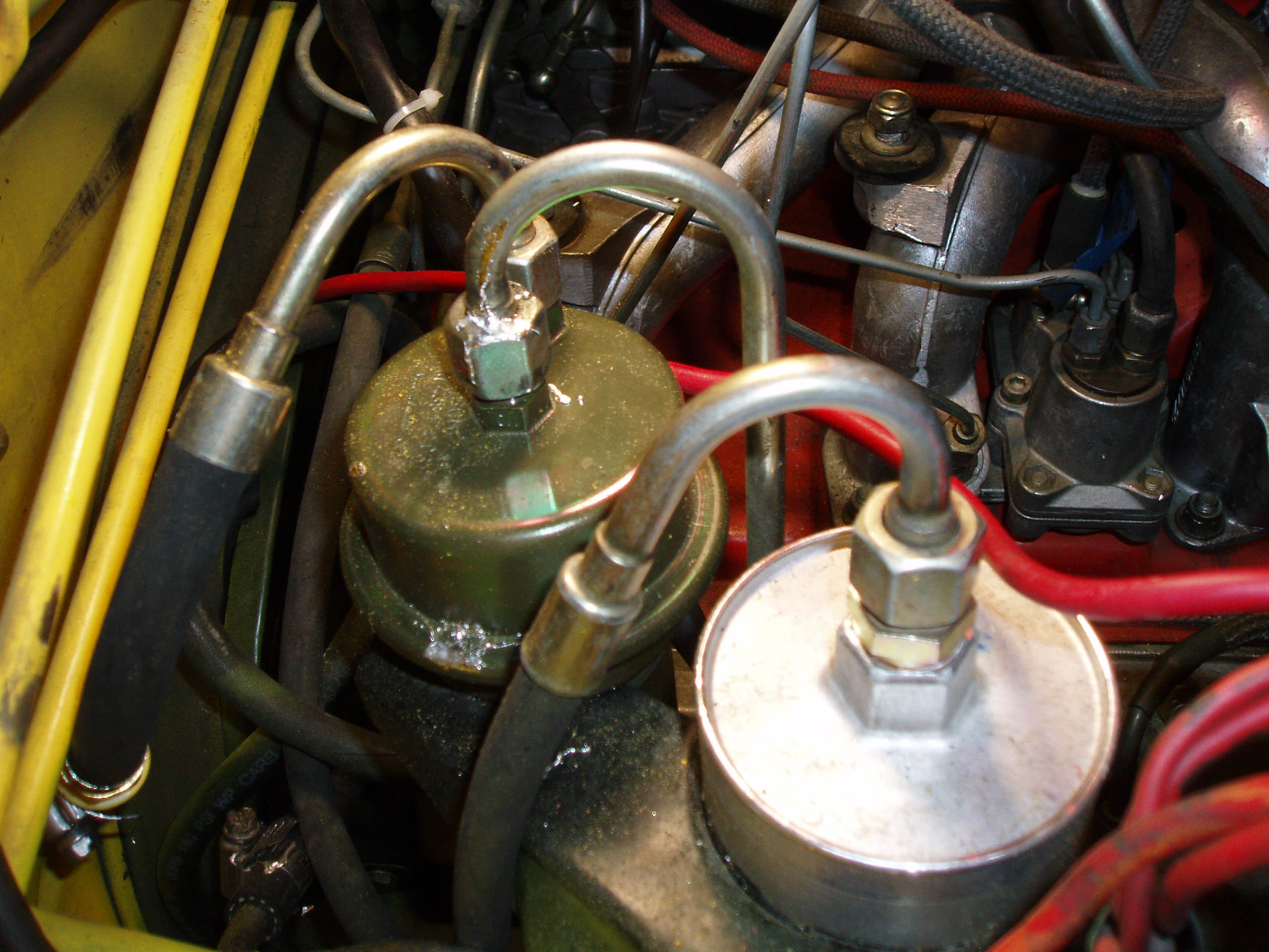

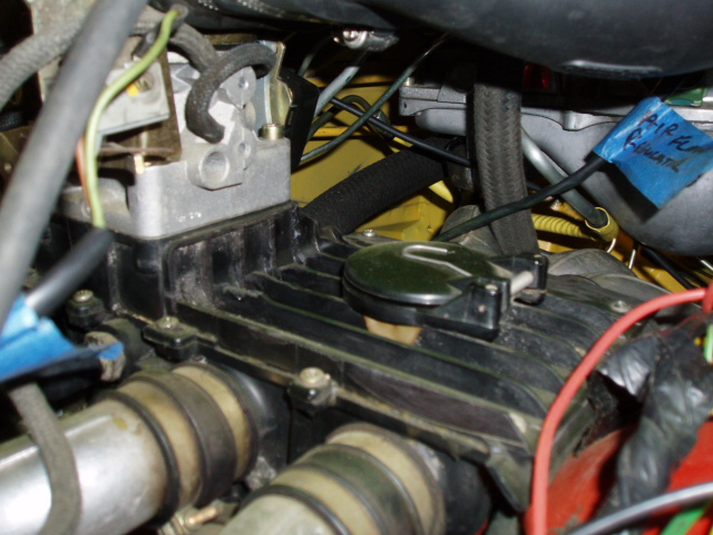

Here is what I did with my CIS! No cutting.
No need to replace the flywheel. You need the clutch, pressure plate and flywheel ring gear. I bought mine from PMS.

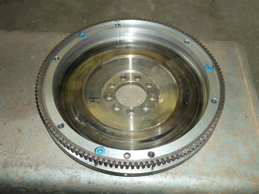

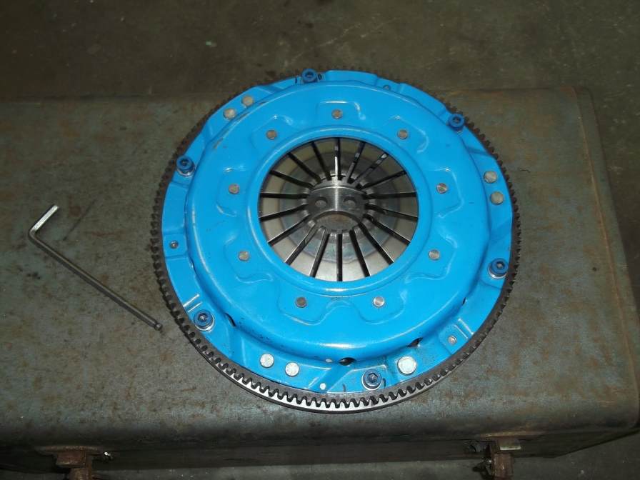

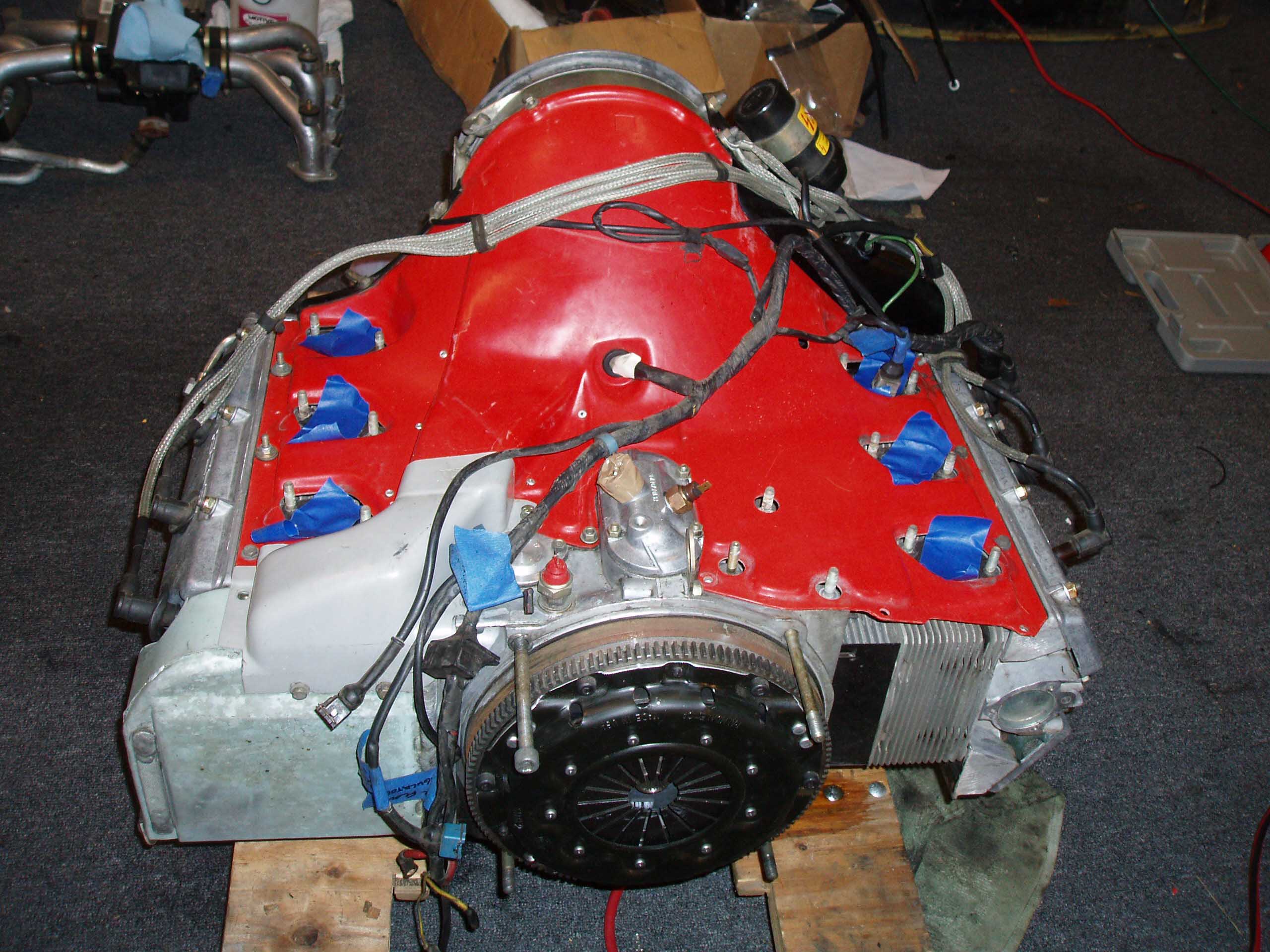

I built my own clutch set-up the flywheel is stock, ring is modified VW and the PP is a 228 HD VW bus, disc is a sachs 228 bus as well.
(IMG:http://www.914world.com/bbs2/uploads/post-26-1361729996.jpg)
(IMG:http://www.914world.com/bbs2/uploads/post-26-1361730017.jpg)
(IMG:http://www.914world.com/bbs2/uploads/post-26-1361730039.jpg)

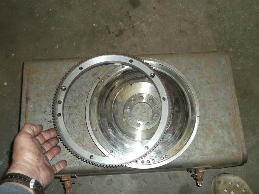

The only thing I'll say is bad with the KEP or my clutch assembly is it starts to get a bit heavy. Below is an attempt to lighten it up a bit.
Between the ring and the flywheel I think I got close to 5lbs off off it.
I ended up with the same weight as a stock 914/4 assembly.
Of course everything was then balanced.

QUOTE(porschetub @ Feb 6 2016, 11:44 PM) *
Been on PMS site and thought there was a conversion flywheel for this engine swap?as silly as it sounds can I engineer a 215mm flywheel to nine bolt crank and fit that,torque figures are not hugely different from say a 911T or 911E of that era.
Flame if you like but I don't want to go to the larger clutch/flywheel and the changes required to get the thrust bearing movement corrected,as in push clutch to pull clutch action.
The stock SC flywheel is 225mm that will fit a 901 (914) and 915 transmission.
Next size up is the 245mm flywheel and it's too big for the above, so you are into the 930 or G-50 transmissions which are major work and money to put in a 914.
BTW there are 2 flywheels for a 3.0, early is a small pilot hole, later is a big hole with a pilot bearing holder.
The early flywheel can be used on all 3.0, but only the late crank has the 3 mounting holes for the pilot bearing holder.

Jeffs9146
post Feb 8 2016, 01:06 PM
Ski Bum
Posts: 4,062
Joined: 10-January 03
From: Discovery Bay, Ca
Member No.: 128

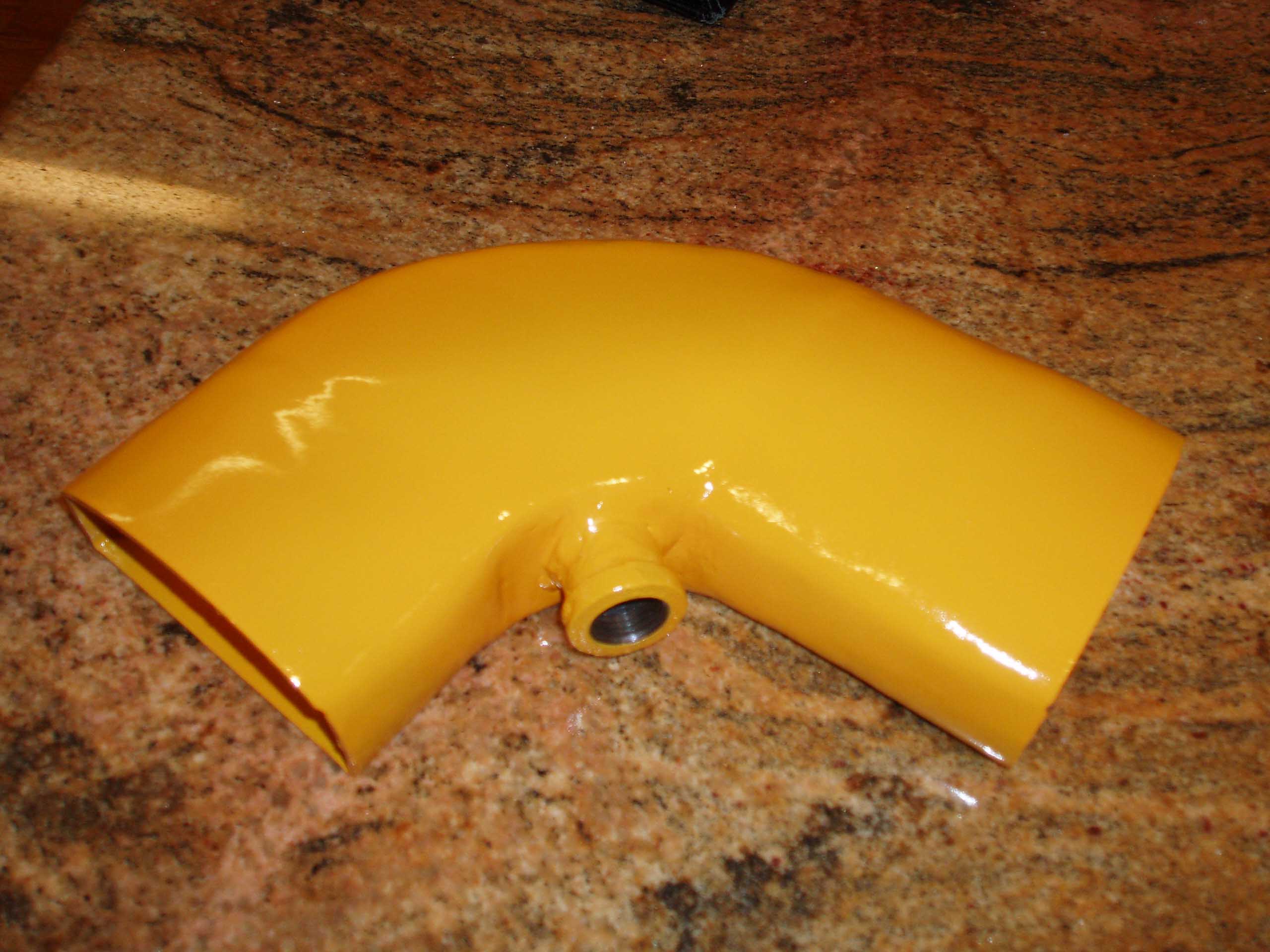

so transposing the injection gives the clearance required with the deck lid Jeff ?
Sort of!
I used a grinder and removed the filter top of the stock air cleaner. Then I turned the AFR and mounted it on an early Volvo 242 injection intake. I made some mounting brackets to hold it at the correct height and welded up the yellow elbow myself. I also removed the AAV and other not needed vacuum valves.
So yes with a bit moving and fabricating you can avoid cutting anything.
