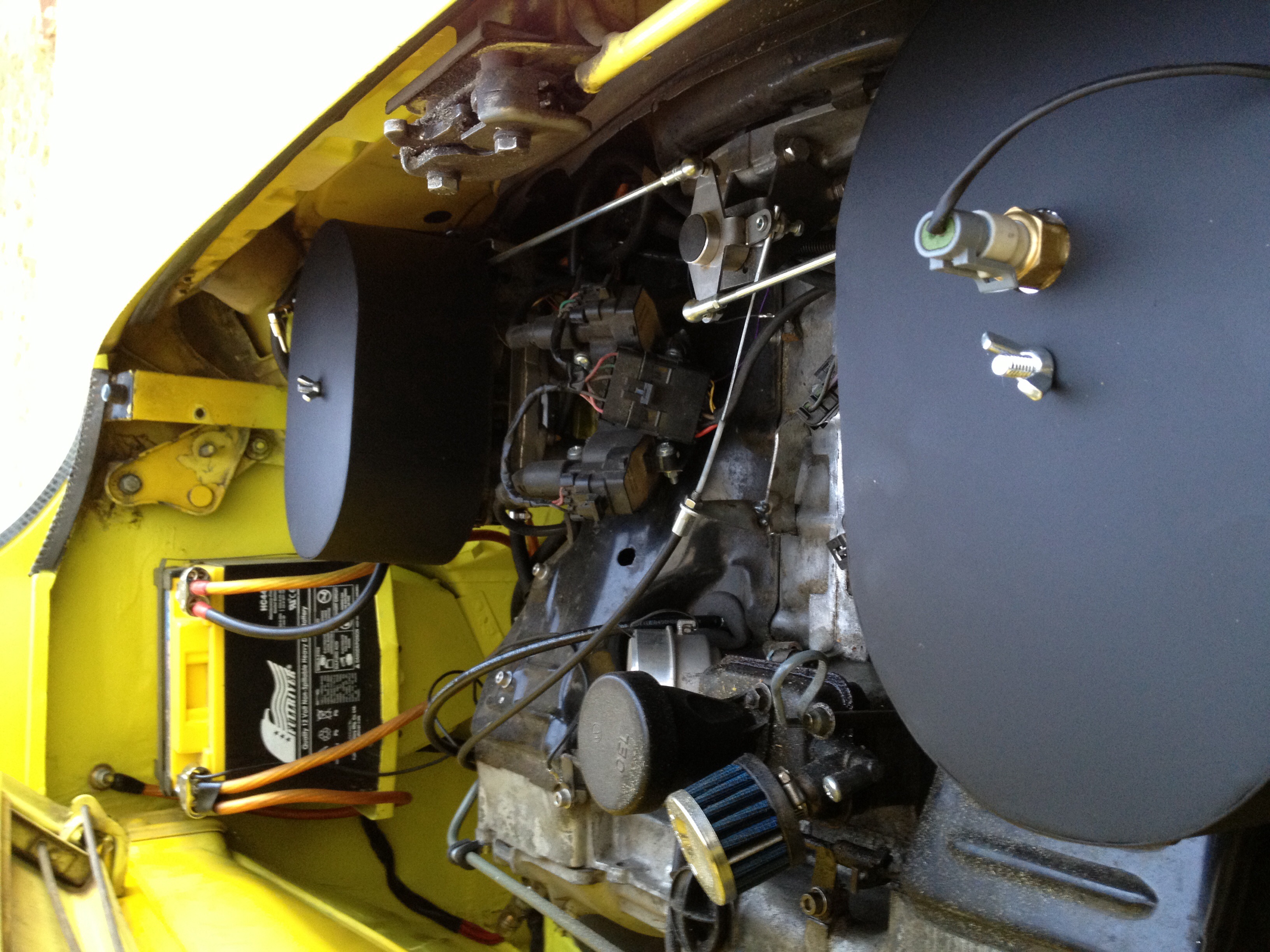

Nice, clean installation but seems to be a solution in search of a problem. IMHO. Normally, I would not disagree with Mark, however don't throw away the cross bar linkage. It can be modified easily. There was a thread on how to do this some years ago but I can't find it. I did mine and there is absolutely NO play in the linkage. Here's mine.

QUOTE(Elliot Cannon @ Feb 8 2016, 01:21 PM) *
Hate to tell you this, but I don't like your linkage.
For one in this pic the angle of the connecting arm puts a large thrust (side) load on the carb, it will cause premature wear.
A crossbar linkage can be done, but I rarely see one I feel is acceptable. Except for the Gene Berg for a type 1, I've never seen a good crossbar set-up out of the box.
(IMG:http://www.914world.com/bbs2/uploads/post-7407-1454955688.jpg)

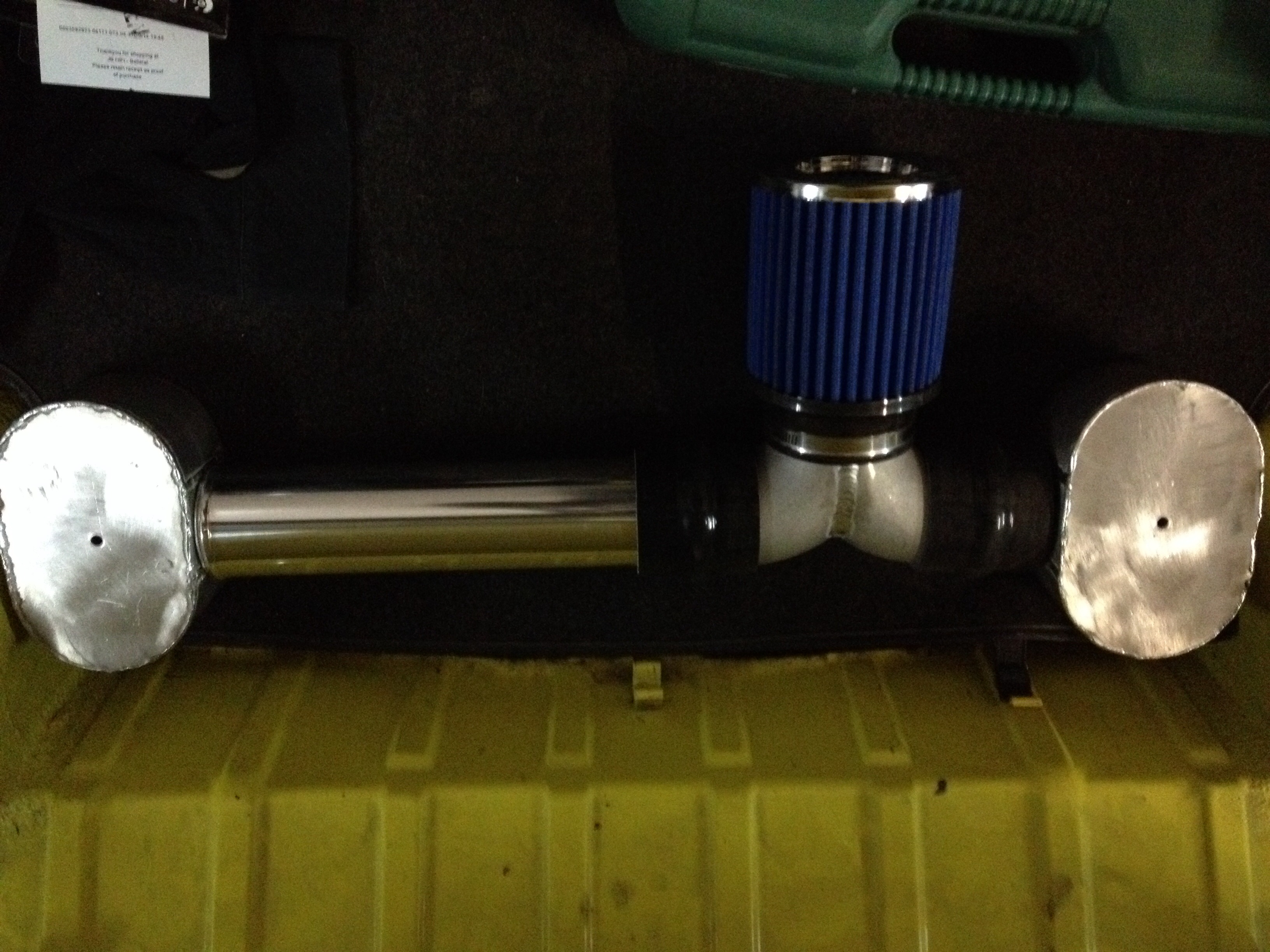

QUOTE(McMark @ Feb 7 2016, 08:50 PM) *
CSP Bellcrank
looks better that the cross bar for sure. I just can't bring myself to buy a $300+ Tangerine throttle linkage. looking for alternatives
Harpo

QUOTE(Mark Henry @ Feb 8 2016, 03:41 PM) *
Yah,
I don't like your linkage either.....not that I have personally seen your linkage.
Also, why is it all red in there? Did you run out of black pain?
The big issue I had with any cross bar linkage is the engine expands when it gets hot.
I measured mine and it was not trivial.
That expansion is not accounted for in a cross bar linkage, th cross bar just gets loose.
I ended up with Foleys cable system and it really is a one shot deal, set it and forget it.

My linkage has been like this for over 10 years. Never had a problem with carb wear. I had lots of red paint laying around. Engine expansion?? The cross bar is threaded on each end, the bolts (some use shoulder bolts) are screwed into the end of the cross bar and fit snugly in the heim joints but can slide slightly. Never had a problem with expansion. The linkage is adjusted so both carbs reach WOT at the same time and at the same rate. I can see where it can be easy to criticize this set up just from the way it looks. I have threatened to change it many times but if it works (and it does) why change it? (IMG:style_emoticons/default/laugh.gif) Besides it was pretty cheap to do which in my case was the motivating factor. (IMG:style_emoticons/default/smoke.gif)

Trust me, if you take a little time to set up a CB linkage, it's more than adequate for your 120hp push-rod H4.

Perfect thread for "how to learn never to post anything on 914World". (IMG:style_emoticons/default/biggrin.gif)

QUOTE(Series9 @ Feb 8 2016, 07:29 PM) *
And then keep setting it every couple months. And then buy a new one in a couple years when it wears out. (IMG:style_emoticons/default/barf.gif)

This is another interesting tread, you gotta give the Dub House credit for attempting to create a better mouse traps.

Here's the thread I followed to improve my linkage. http://www.914world.com/bbs2/index.php?sho...c=91831&hl=

Kinda seems like an intake for forced induction.

Looks like one of my weekend projects from early last year.
My mate has a dyno and we were playing around with noise and trying to tame a shitty map signal.
Ended up going Tps for the ecu anyway so I took it off again.

The shouldered bolts Elliot mentioned eliminate the spring loaded ends the CB units come with. Bolts like the original Wietmister? and the one Triad used to offer. You set the end play when the engine is hot and the bolts/jam nuts lock it in place. Very effective. I wish I had never gotten rid of the Triad linkage I used to have.

How about:
Loose the ITBs, attach the intake directly to the manifolds, and source a single throttle body from a 3.2 (or similar).
Then, it's a mod with a purpose and there's no more linkage debate.
