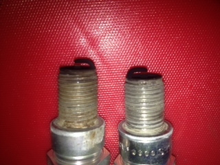

MAY HAVE FOUND IT....
Went to remove the #3 spark plug, expecting a tight fit and OOPS>>>> (IMG:style_emoticons/default/screwy.gif)
I did not have to break the torque at all. the plug was NOT TIGHT. Might explain why the CHT registered cooler than usual too. and even why it happened going up a hill. The head actually got hotter than normal and everything loosened up... ya think?
Did the same for #4 and it was plenty tight. Both plug are JET BLACK.
both are NGK BR5es and gapped at 0.7mm so that is good. Wasn't there a photo array of plugs somewhere? I found one that says the dry black soot can be from over idling.... My car does idle too high.
SLITS

http://www.classic-car-magazine.co.uk/arti...uide_chart.html
Soft, black, sooty deposits easily identify this plug condition. This is most often caused by an over-rich, air/fuel mixture.
Check for a sticking choke, clogged air filter, or a carburetor problem - float level high, defective needle or seat, etc.
This may also be attributed to weak ignition voltage, an inoperative preheating system (carburetor intake air), or extremely low cylinder compression.

QUOTE(SLITS @ Mar 17 2016, 03:49 PM) *

I would suggest you put it together again, new plugs.
Drive for a week, examine plugs.
First, hunt down any and all vacuum leaks at hoses and injectors.
If super rich again, unplug cold start injector.
Re-route fuel line around cold start injector
Cap injector to ensure no new vacuum leak.
Drive it again for a week, check plugs.
You will be fine without the cold start injector.
It's getting warm and I don't need one up here...colder than you.
You can find this pretty fast if you have a valid AFR that is clean and working.
