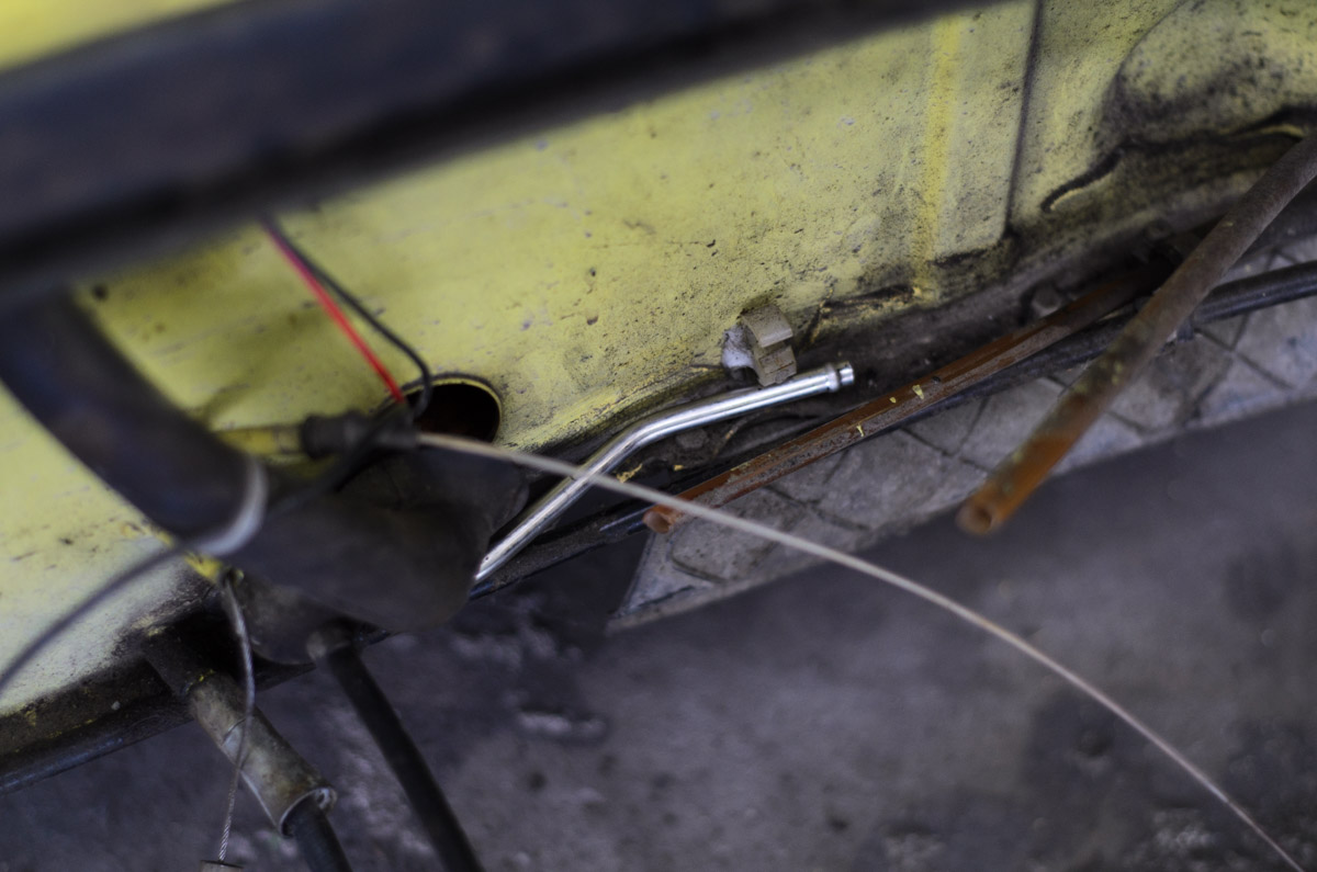

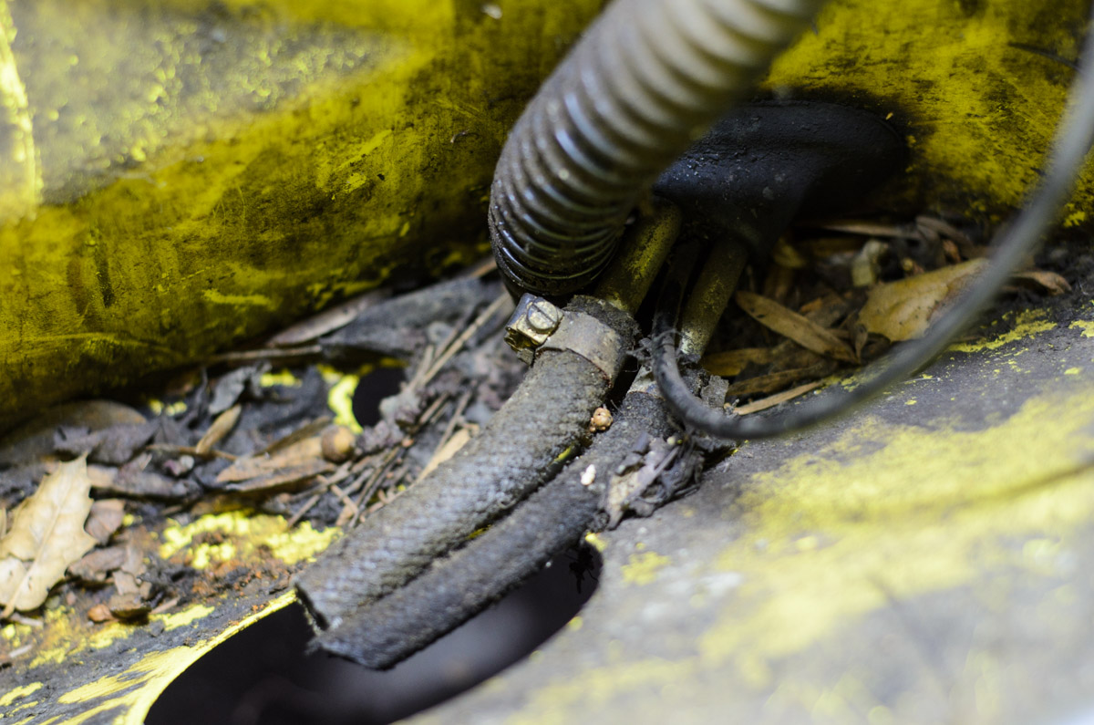

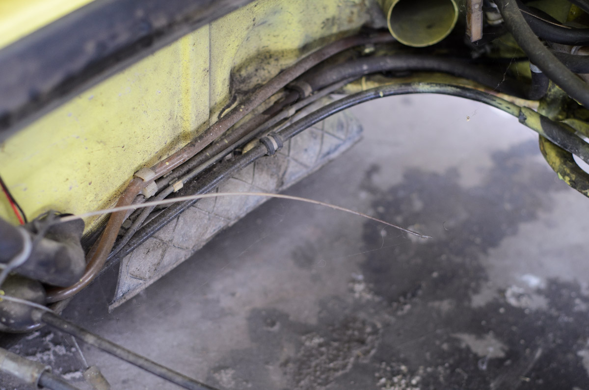

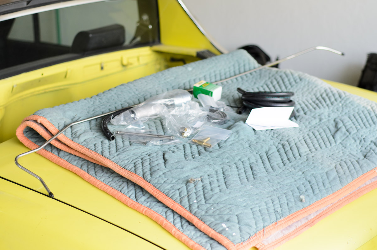

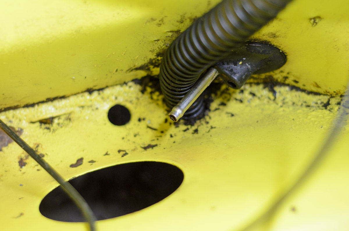

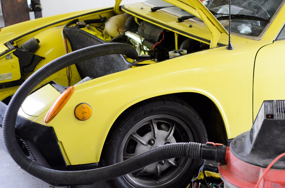

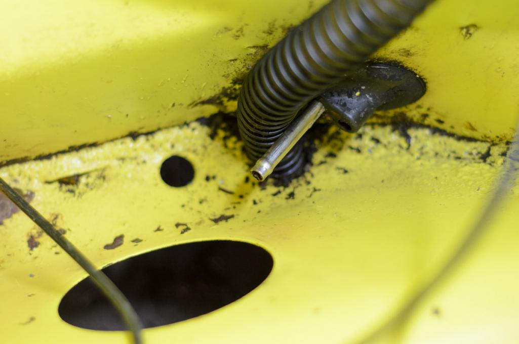

Spent a portion of Easter Sunday in the garage cleaning the fuel tank area and installing CFR's SS fuel line.
Dirty!
Suck
Clean
Kit:
Progress:

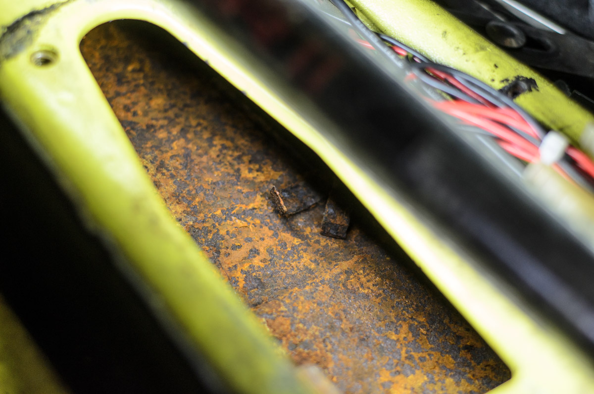

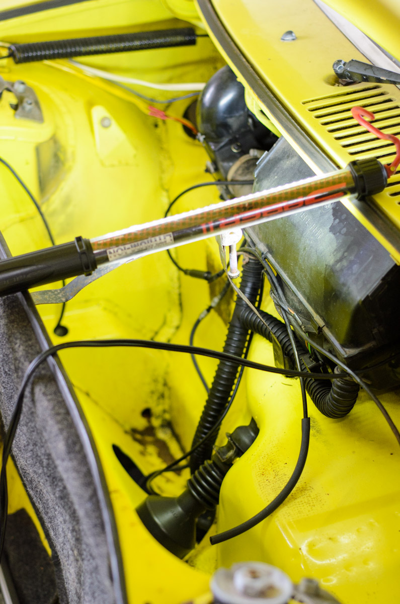

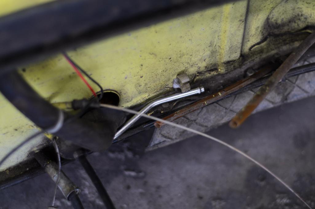

Not pleased with the amount of rust I've found in the center tunnel. Is there anyway I can treat this now so that it doesn't worsen without having to pull the wiring harness?
McMark
post Mar 28 2016, 02:31 PM
Post #29
914 Freak!
Posts: 20,180
Joined: 13-March 03
From: Grand Rapids, MI
Member No.: 419
Keep water out. Without moisture, the rust will stay just like that.
r_towle
post Mar 28 2016, 02:39 PM
Post #30
Custom Member
Posts: 24,705
Joined: 9-January 03
From: Taxachusetts
Member No.: 124
go to Eastwood and get the rust conversion stuff, with the spray wand (long one)
Then you can spray in the converter, let that sit for a while.
Once that is done, I would personally spray in a top coat of whatever you want...
Rich

post Mar 28 2016, 03:03 PM
Post #31
Sonoma County Gear Head
Posts: 2,034
Joined: 8-January 03
From: Santa Rosa, CA
Member No.: 108
QUOTE(McMark @ Mar 28 2016, 01:31 PM) *
Wondering how water got in originally. Maybe have been a DPO thing. Car's been in the garage almost the entire time I've had it. Hmmm..
Thanks!
RoadGlue
post Mar 28 2016, 03:05 PM
Post #32
Posts: 2,034
Member No.: 108
QUOTE(r_towle @ Mar 28 2016, 01:39 PM) *
Rich
Good idea. Have no idea how I'd get a topcoat on though. Wonder if the conversion products would be hard on the wiring as it's going to come into contact with whatever I try to spray in there.

RoadGlue
post Mar 28 2016, 03:41 PM
Post #33
Posts: 2,034
Member No.: 108
This looks like it might work for the center tunnel:
http://www.eastwood.com/internal-frame-coa...ray-nozzle.html
r_towle
post Mar 28 2016, 08:27 PM
Post #34
Custom Member
Posts: 24,705
From: Taxachusetts
Member No.: 124
Use a similar spray want to blow paint in there.
I hav never seen a tunnel that was not rusted.
RoadGlue
post Mar 29 2016, 09:39 AM
Post #35
Posts: 2,034
Member No.: 108
QUOTE(r_towle @ Mar 28 2016, 07:27 PM) *
Thanks for your help Rich.
I'll order that product. I think I'll wrap/protect the exposed areas of the harness the best I can and all will be fine. I'm thinking glow in the dark paint for a top coat! :-) Ok, maybe just bright white.
