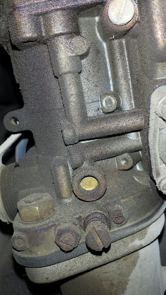

I guess before I buy a rebuild kit, I need to know what carbs I have. Can anybody positively identify these, or let me know how I go about identifying them?
I have been assuming they are Weber 40's. If that is the case, will this kit work?
https://www.cip1.ca/ProductDetails.asp?Prod...de=ACC-C10-5542
Would I need anything else on top of what is supplied in the kit?

i cant faintly make the"web" stamping on the picture as for the size you should look on the side of the carburator it should have the weber stamping and the size of it
(on the kit part im not too sure)
Also if you dont have expierence rebuilding carbs and somethings fails you will have to rebuild it again. (most likely)

They're Spanish webers (if you look closely at the carb base says made in Spain). Now, wedge your phone/mirror down on the other side of the carb and in the same location it'll have some letters/numbers stamped in that say 40 IDF 70 or 40 IDF 71 if they're 40s. If they're 44s, it'll say 44, etc.
Only other way to measure is to pull the carbs off, which if you're rebuilding them, you're going to do anyway. Then measure the individual throats at the bottom.

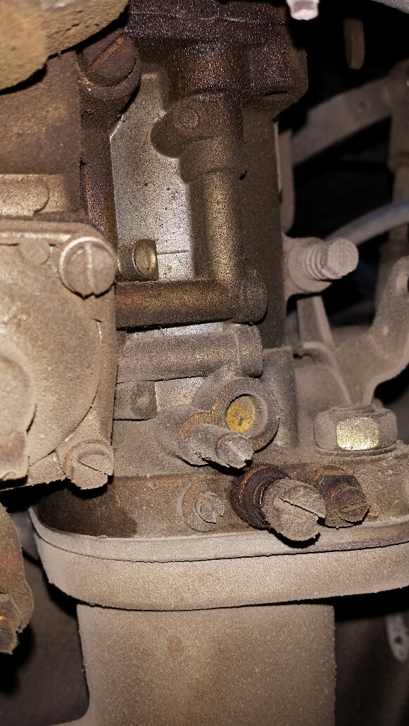

Is this the right location? I don't see anything, but perhaps it's grimed over.

I've seen it stamped there once before, perhaps I was wrong. If you're rebuilding them, why not go ahead an pull them off and have a closer look? If still no stampings are visible, measure the the diameter of the bottom of the throats.
FYI, most Weber 36, 40 and 44 kits should include all gaskets, regardless of carb size. You order them and select the right top gasket once you get the kit in front of you.

Spray clean them on the car to get the right numbers off of them.
Use standard carb cleaner in a well ventilated area.
An old toothbrush will also help.
