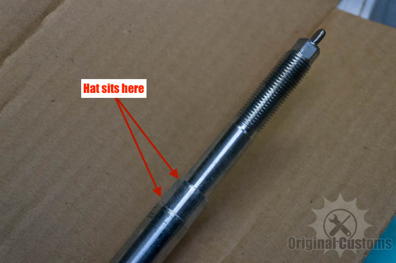

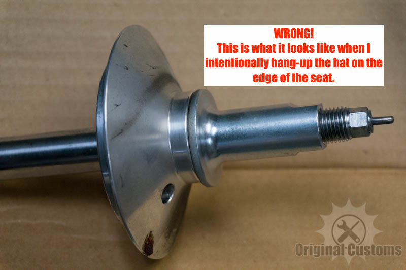

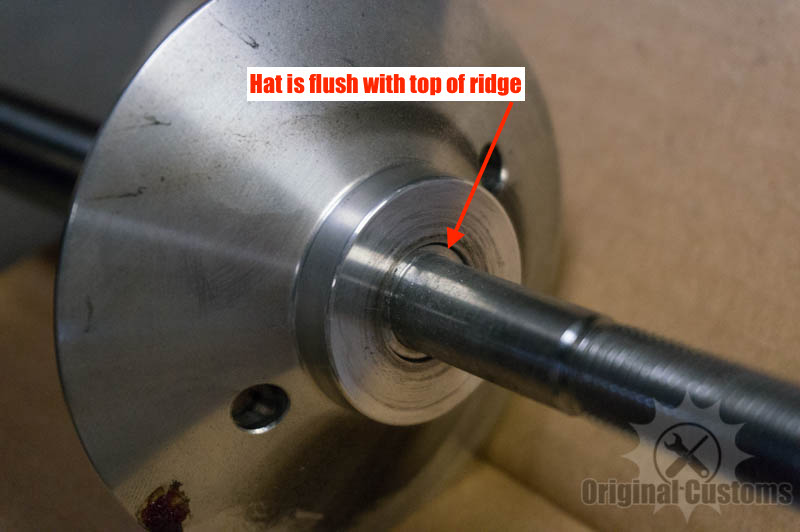

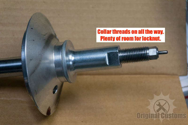

I pulled apart a spare set of Koni 8241 1050SPORT shocks with Ground Control adjustable springs to see exactly what was going on here. I tried to include a lot of pictures here so you can compare what I'm seeing with yours.
There is a 'ridge' section on the shock shaft that the spring hat is supposed to seat on. I was able to tighten the top collar-nut with the hat catching an edge and not seating correctly. And I included a picture of how much thread is showing when that problem happens. Looks quite a lot like what you're seeing.
It also took a bit of effort to knock the hat off the 'ridge' when I first disassembled it. So if the machining on the hat/ridge isn't quite matched, your hat may not be seating all the way. Check that the top of the 'ridge' is flush with the hat (see picture).
