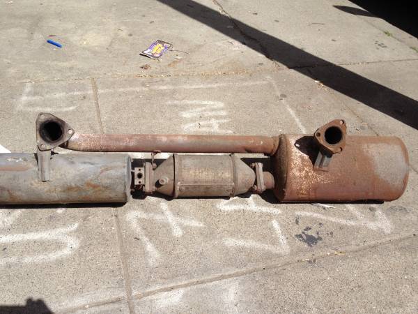

PS just found this photo on CL, its FS is you want it:
http://sfbay.craigslist.org/sfc/pts/5515698159.html
