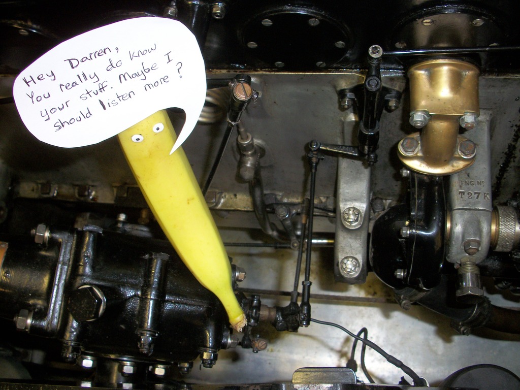

This runs from pre second world war to current cars. I have a collection of finished restored cars (my life’s work) and cars stacking up to be restored. These kinda chart and document the history of car evolution. This evening after work (and working on my 14) I thought I’d share some in relation to linkages which people think I don’t have any experience with.
From Edwardian times throttle linkages have evolved from large heavy solid metal bars, thru dainty rods, on to wire cables and now FBW.
I have cars with all of these examples that I’ve restored. The very early cars were exceptionally crude but very ingeniously and beautifully engineered. Throttles didn’t always start off under your foot, they were on hand wheels (like a steam train), hand pull levers, and attached to the most odd things in the cabin. Foot pedal accelerators started to become the norm very early in the 20th century (although they first appeared before 1900) each car manufacturer had their own idea. What was common however is the ingenious methods to connect their throttles to the carburettor.
For a time even some manufacturers had part throttle on the floor as a pedal, idle throttles on the steering wheel and choke/start throttles on the dash!
Basically 3 sets of mechanical linkages to one single carb, each pulling on a different lever via the most elaborate “watchmakers” engineering. The simplest ball joint would have phosphor bronze cup bushes each side with tension springs inside the ball joint to give fluidic contacts between ball and cup, take up wear over time and be ever reliable. The basic bell cranks were cast in the finest steels, to Victorian aesthetic designs with white metal or bronze bearings, some even incorporating automated oil feed systems built into the car.

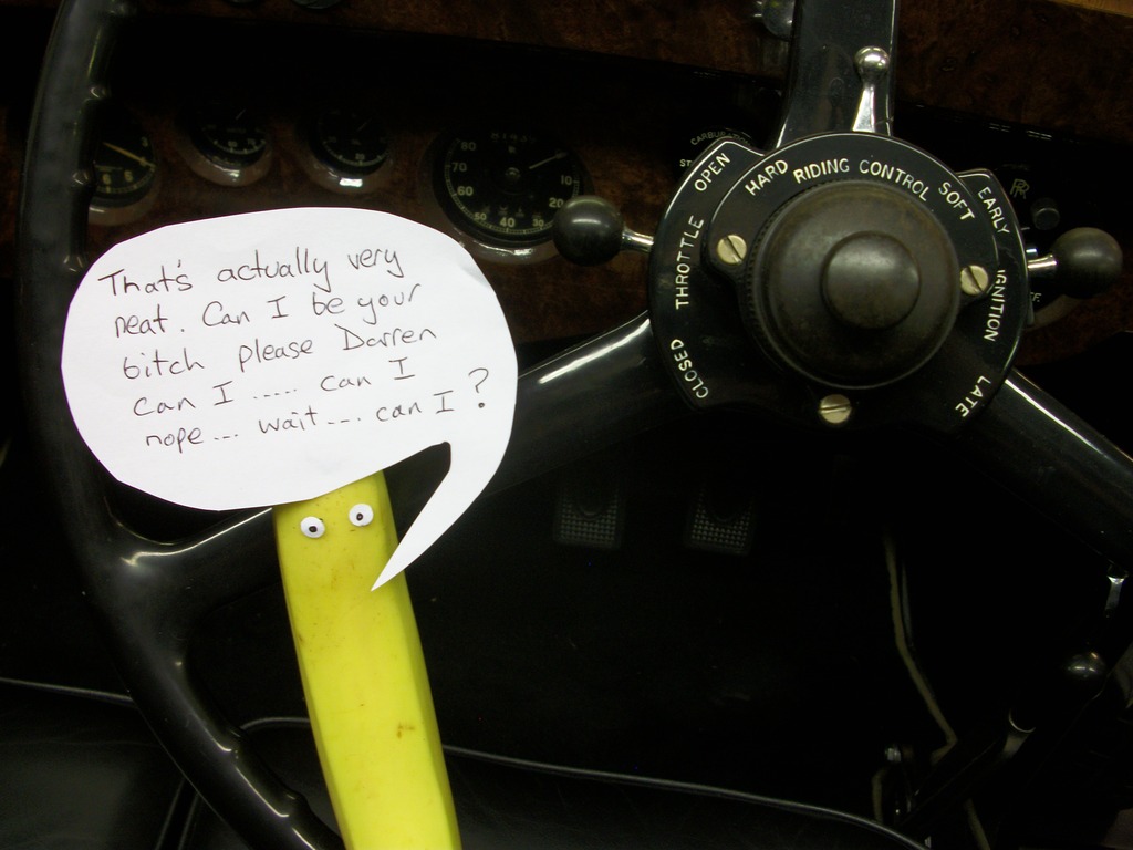

Not only were throttles done this way, timing advance was too. In tonights pictures I’ve taken, I chose an early 30’s car from my collection so that you might recognise some basic parts. This is when distributors started to look like what you’d recognise as distributors and so on. In the early days of motoring there were no vacuum advance or centrifugal advance of the ignition timing, so you had to twist the distributor by hand, while driving. Some manufacturers like Bugatti had the distributor poke through the dashboard at you to make it easy to adjust your timing, others created more linkages for you to push and pull or slide when you were driving. Again different manufacturers chose different methods it wasn’t standardised, but all involved mechanical linkage.
Some even back in the 1920’s had ride control (adjustable suspension) via adjustment of oil pressure to the dampers (shocks if you will). Guess what, more linkages around the car.
These are days before hydraulic brakes, so yet more rods and linkages across the chassis with clever mechanical transitions to take into account suspension movement and steering while using brake rods. The car I’ve chosen in the photo actually has another set of rod linkages for a brake servo which works of a dedicated clutch plate on the side of the gearbox at 90 degrees to the motor drive clutch. In certain gears this mechnically engages with the footbrake lever to a collection of additional servo brake rods giving greater mechanical force to the front brake drums.
So all in all this car is linkage-tastic, you might say. And boy was it a challenge to dismantle, restore and set back up as a result. I learnt a hell of a lot on this car alone.
Here’s some of the basic linkage controls on the steering wheel. You can also just see the carb start lever on the dash behind the throttle open position on the wheel.

The way it works is with a set of ever decreasing diameter tubes within tubes all the way down the steering column.
The largest tube is the steering itself which has the worm gear attached in the steering box at the bottom. The other tubes run trough oil seals and bearings to exit out the bottom of the steering box in the engine bay.
These have levers attached that connect to numerous control rod linkages that go off in this case to….the top one turns the distributor for ignition timing, the next one goes to a linkage and bellcrank which actually passes right through the engine block between cylinders 3 & 4 in this straight 6 to reach the throttle lever on the carb. The final link goes off to connect to the 4 dampers one on each axle which stiffen or soften the ride.
(IMG:http://www.914world.com/bbs2/uploads_offsite/i265.photobucket.com-18255-1463170009.2.jpg)
There are also two separate rod linkages to this car’s carb that run from the foot accelerator and another from the dashboard start throttle.
All in all you can imagine it’s a real handful to drive this thing.

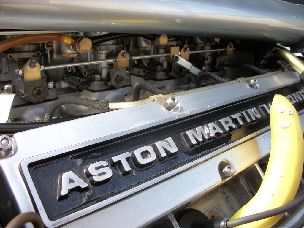

So this morning I took a walk down to my garage and took off a few dust covers to carry on with the evolution of the humble throttle cable story.
I pondered a while on which cars to show you that would illustrate changes, and settled on jumping 40 years forwards into the 1960’s.
Solid rod linkages were common on all makes of pre-war cars as I’ve commented on already.
This is ok when your engine is low power and hard mounted in the chassis. Just think of the old vintage car movies where the engine shakes the car and its occupants roughly when idling along.
As things progressed the high end manufacturers did much modification to dynamically balance their engines and included torsional dampers and such like before they conceded to flexible mounting their motors and accepting at idle and on acceleration they’ll move.
This was the Eureka moment that threw the solid throttle linkage from pedals to carburettors into depths of history and the age of the Bowden cable throttle was born.

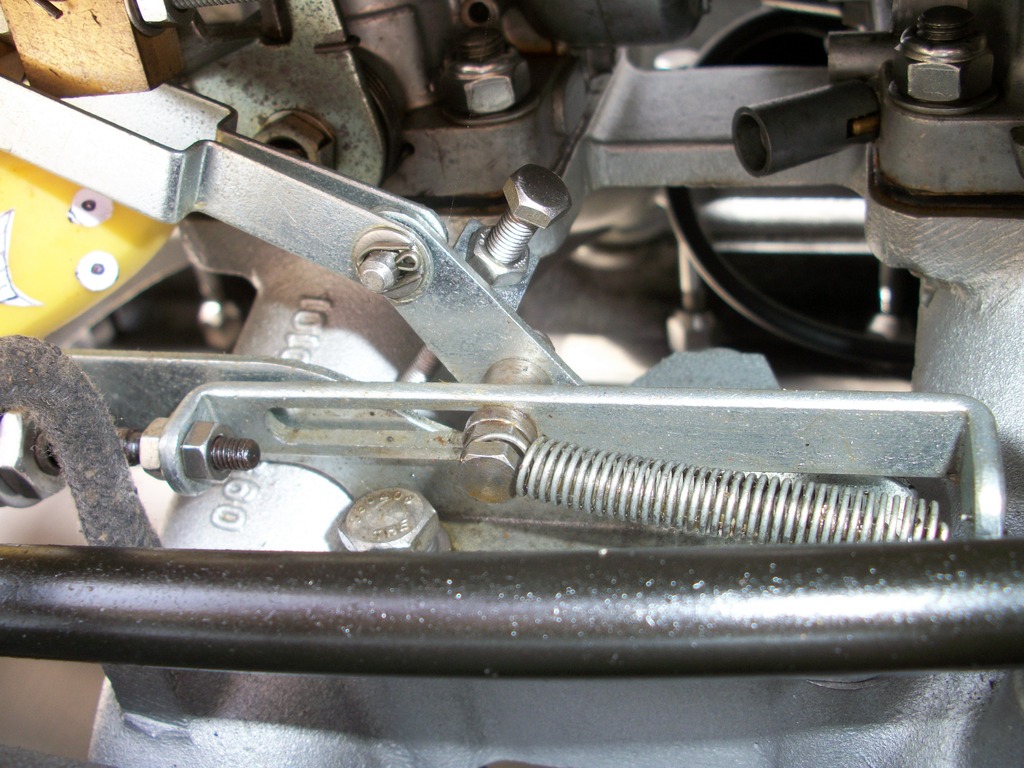

But just before we make the jump, I’ll show you an example of how engineers who knew the deficiencies of the cables dug their heels in to overcome rocking engines with solid rod throttles.
In this example a Cardan shaft is used with a solid flexible plate coupling at the end it leaves the bulkhead, and a sliding rose ball joint at the end it mounts to the bellhousing.
(IMG:http://www.914world.com/bbs2/uploads_offsite/i265.photobucket.com-18255-1463227831.1.jpg)
This allows for a solid accelerator mechanical link to be achieved between the fixed body of the car (and gas pedal mount) and the motor which very cleverly doesn’t pull or push on the throttle itself as the engine is free to rock.
This is then linked in the traditional way with rods and ball joints to another interesting mechanical transition bell crank that incorporates a kick down device in this automatic transmission version.
(IMG:http://www.914world.com/bbs2/uploads_offsite/i265.photobucket.com-18255-1463227831.2.jpg)
Finally linking multiple carburettors with finite adjustments. Note the manufacturers choice in weighted self lubricating brass connection blocks that build in a pendulum safety factory to compliment the return springs in a failure mode. Not infallible (nothing is) but boy if you can see and understand the detail and reasoning behind the design you have to admire it.
(IMG:http://www.914world.com/bbs2/uploads_offsite/i265.photobucket.com-18255-1463227831.3.jpg)

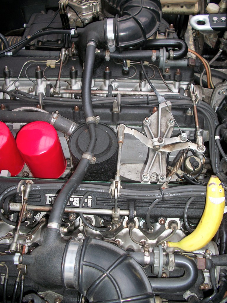

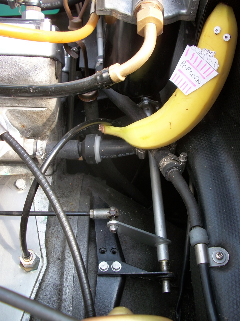

So jumping forward again to the 1970’s where our 914’s live, I chose another of my cars to show a little further throttle evolution relevant to the aftermarket carb conversion of a 914 where this thread has its origin. Having opened a few hoods, this car has a Bowden cable from gas pedal to engine and then the linkage is split to service two sides of the motor.
(IMG:http://www.914world.com/bbs2/uploads_offsite/i265.photobucket.com-18255-1463227832.4.jpg)
Again the design of choice is cable to main engine link, then solid link bars & rods to the destination. In this picture it’s worthy to note that the pivot points of the linkage rods are run in ball bearing races, and the tie rod ends have wire locked ball and socket ends to combine and reduce any play in the system between the banks.
All in all it provides as best it can an intrinsically safe and adjustable linkage with devices to remove mechanical wear and friction. I’ve rebuilt this twin cam & the previous V8 and I can tell you again, that they have taught me a great deal.
