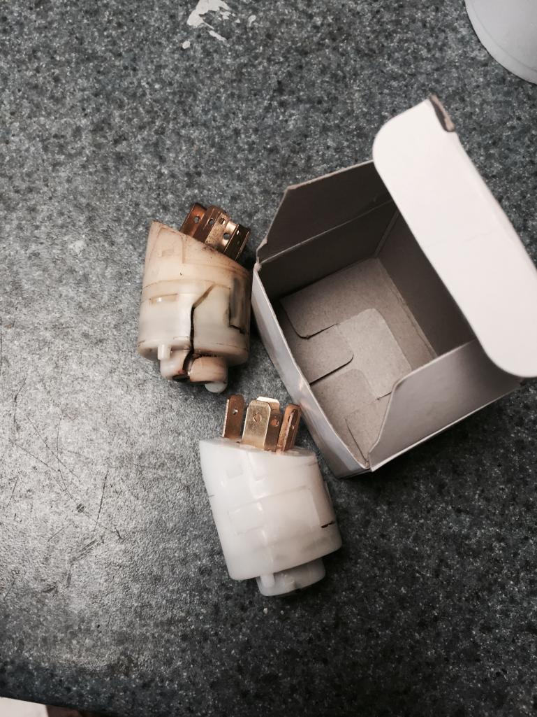

What's that expression..You get what you pay for? (IMG:style_emoticons/default/biggrin.gif)
I ordered a cheap one from Pelican and it broke/shorted during testing on install.
McMark put a better one in for me (after diagnosing and confirming the old one and "new one" were bad and causing the no-start). However, I don't recall or have the part #.
That was 2 years ago
Good luck! (IMG:style_emoticons/default/beerchug.gif)

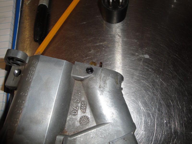

What's everyone doing to fasten it into the column?
New switch doesn't have little loop for the retaining screw?
Need to change out the one in Mark's car.
76-914

QUOTE(cary @ May 17 2016, 03:57 PM) *

Cary,
75-76 uses a different switch than the one in the picture. Can get a picture on it later.

One got melted in a monster unfused short. (IMG:style_emoticons/default/barf.gif) (IMG:style_emoticons/default/barf.gif)
The other was out of the project car. Neither have an X with key on. Not much help.
I've learned so much in the last 5 days my head is about ready to explode.
I have a new early version on the shelf. We just drilled and tapped a 1/4-20 set screw.
Tapped on the upper fat side. That should keep it from getting pulled out when unplugging the harness.
