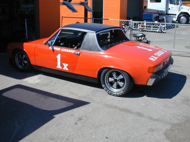

John - thanks. There's also a 23x8x15 slick that is designed for a 7" rim (which I have).
http://www.bobwoodmantires.com/gyeagprod.htm
The potential problem is the section width is 10" (huge). My rear fenders are significantly rolled and pulled already, but no cutting/flares.
I remember seeing Topper Chasse's 914-6 with (I think) these tires installed. His rears did not appear to be sliced or pulled much more than mine, but I'm not sure.

Chris, if I remember the x-section of the tire correctly, the side walls stick out about 1/2 inch over the tread width. The tread width is 9.5 inches or so on the 9x23 and 8.5 on the 8x23 and they both fit on 7 inch rims fine. I'd recommend trying to find one to bolt it on front and rear to see how they fit. I think Topper's rear fenders are pulled like mine were and it is hard to see just how much that is. When I put the 9 inch flares on I gained only about an inch and a half of clearance since mine weer pulled a lot. If you run the slicks I think you'll never go back!!
