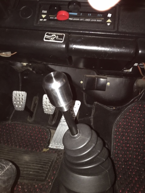

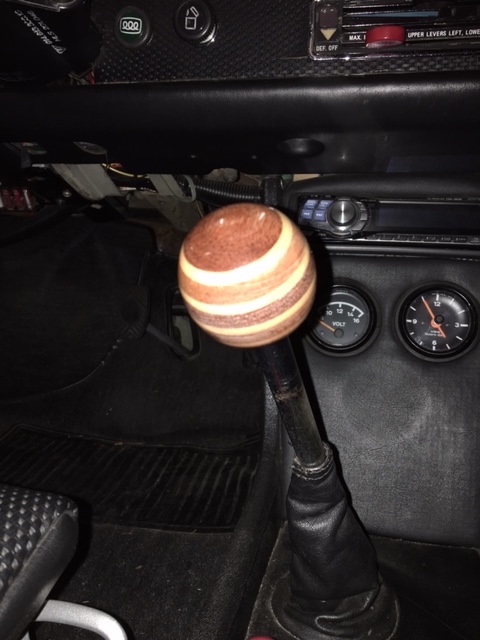

I've had great luck with crush washer-mounted knobs. For me this is what I'm running in case you haven't closed the door on crush washers...
From Vacca Rabite, nice feel, excellent craftsmanship, very nice feel in the 914.
From a machinist friend who custom turns out of stainless or aluminum, this is stainless, nice heavy feel and comfortable for the 911 shifter position.
