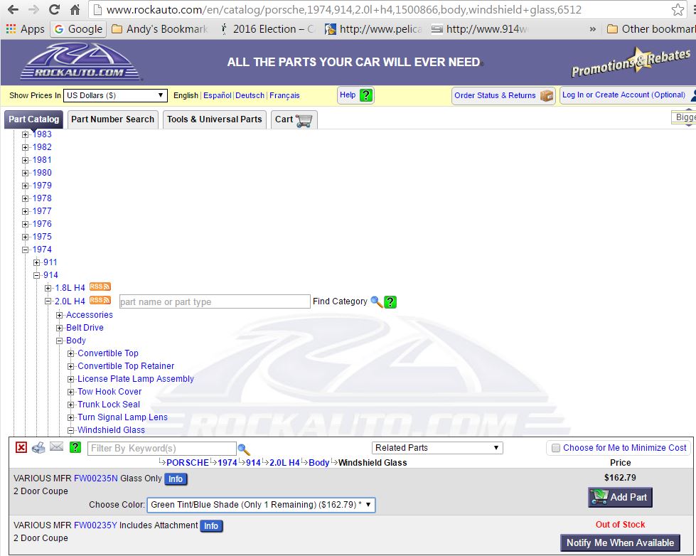

RockAuto claims to have them and they send overseas. It's under 'body' - link for a '74, may be more in other years.
http://www.rockauto.com/en/catalog/porsche...ield+glass,6512
