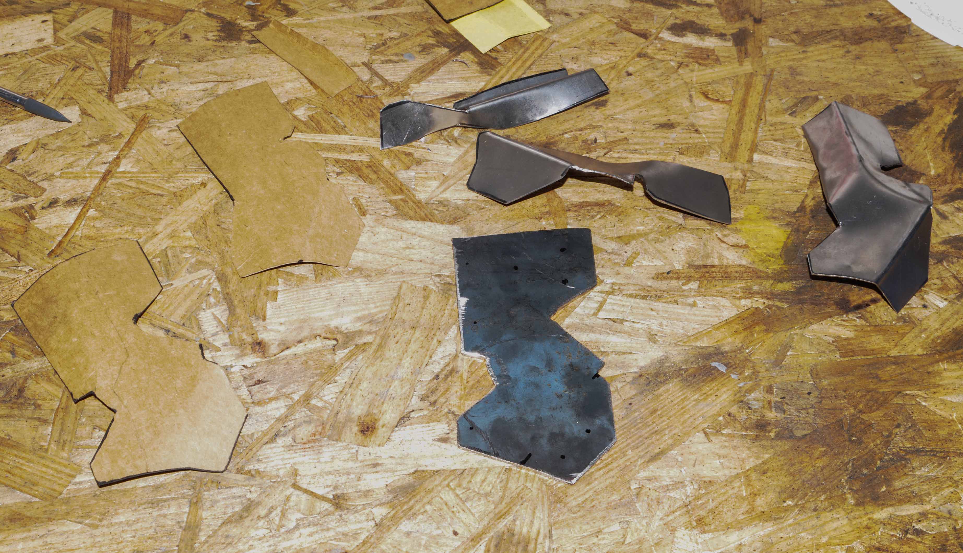

After multiple cardboard experiments and a test with 20 gauge, I actually think the single piece is the way to go...

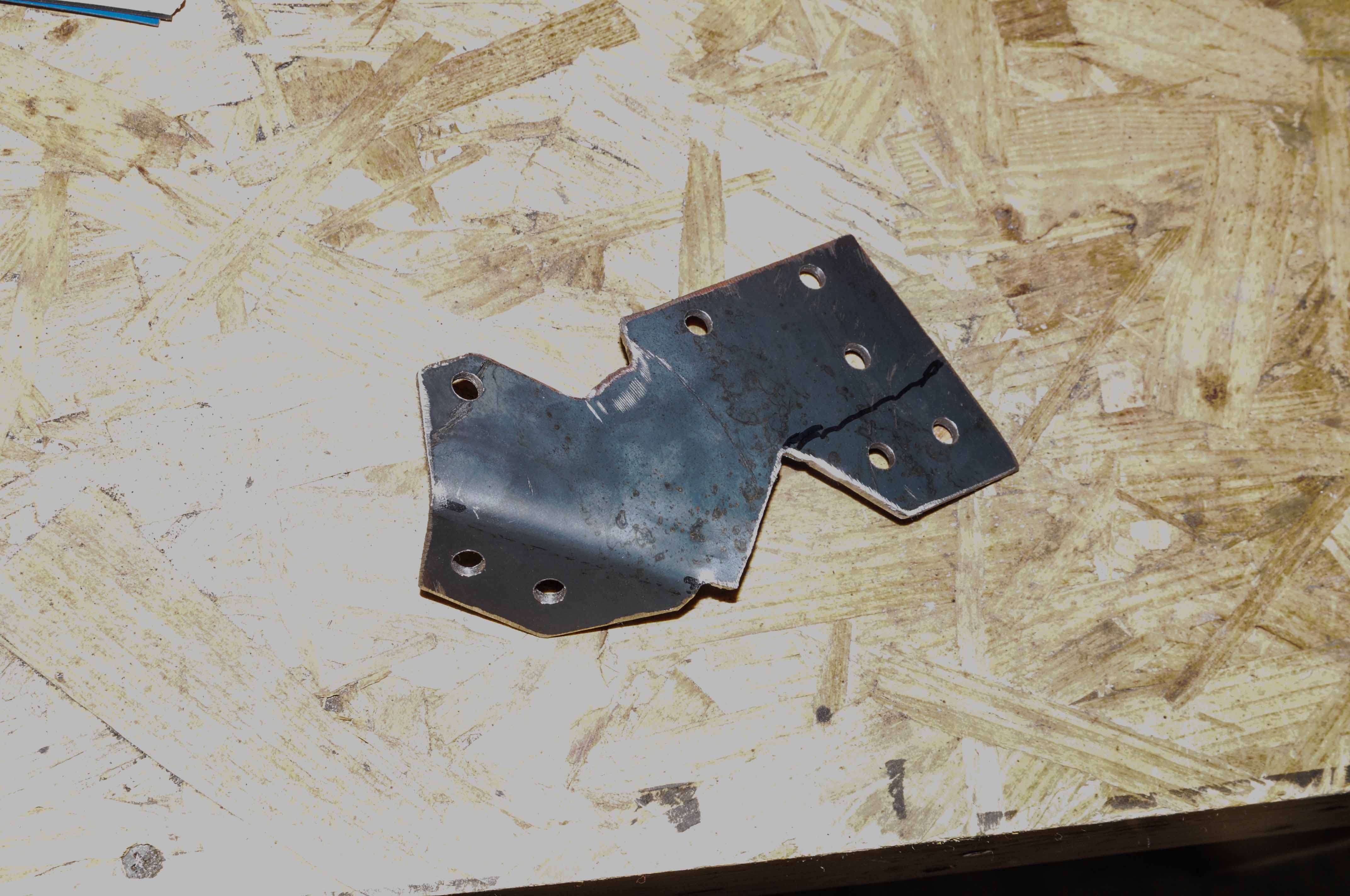

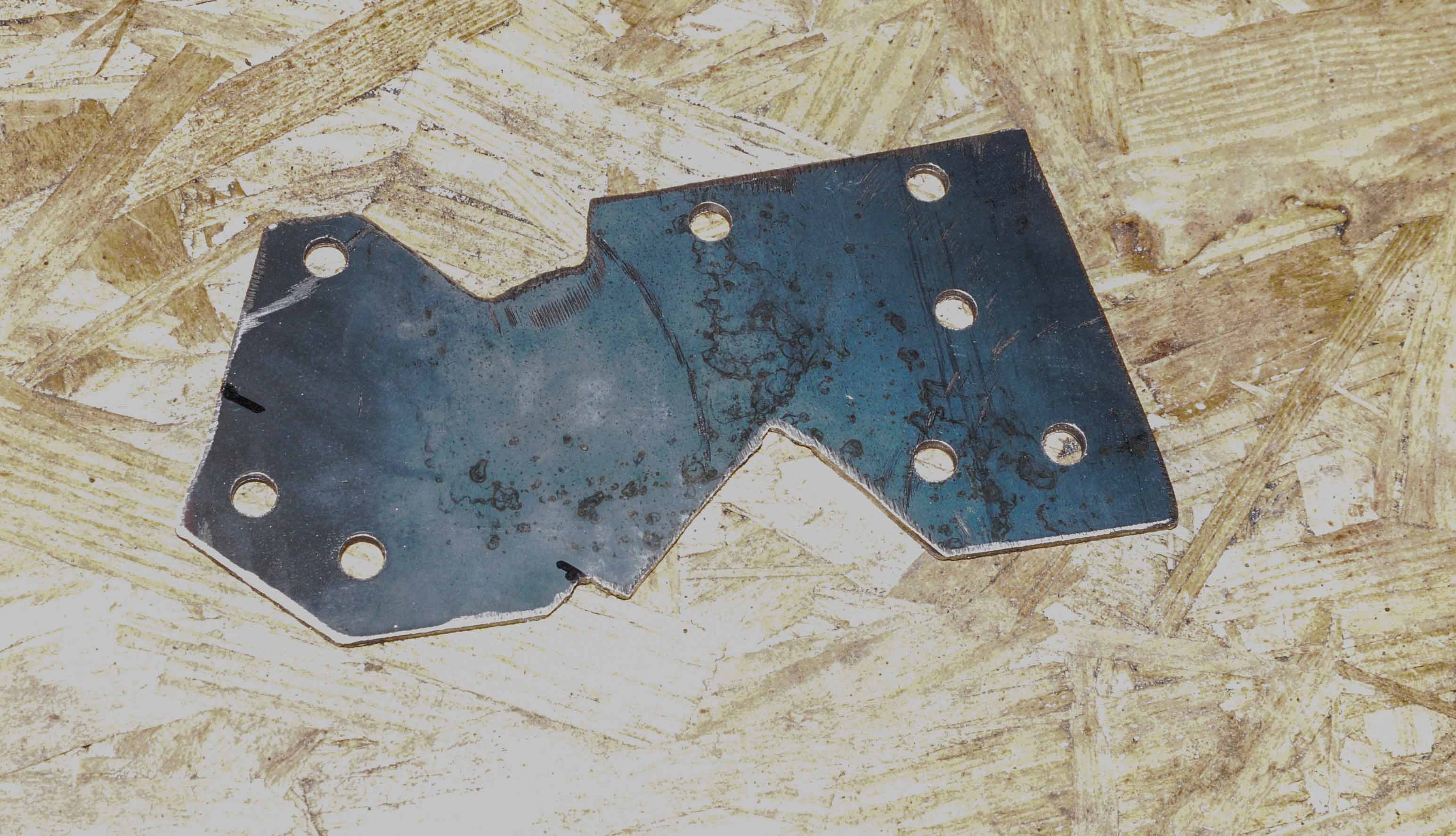

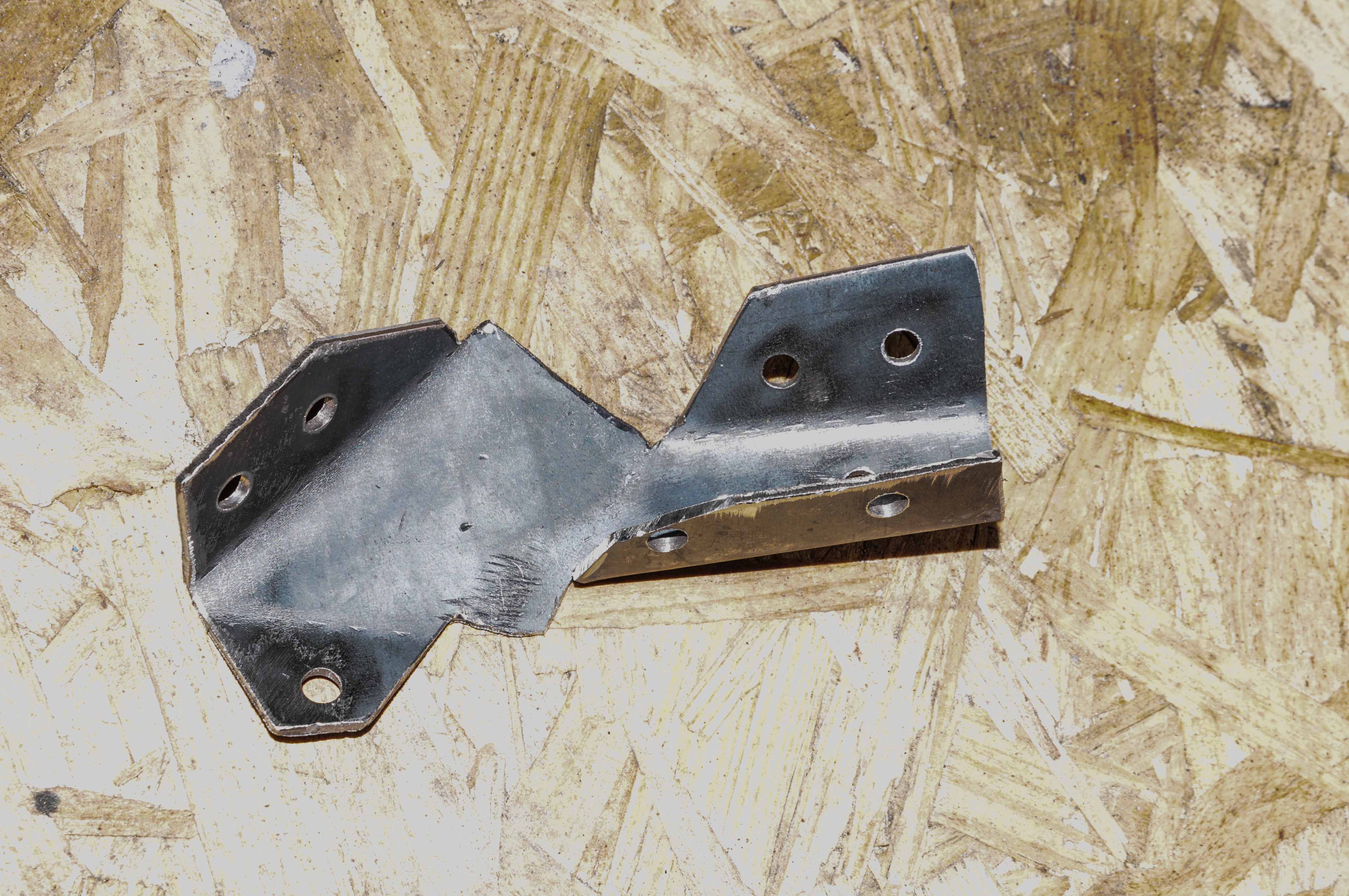

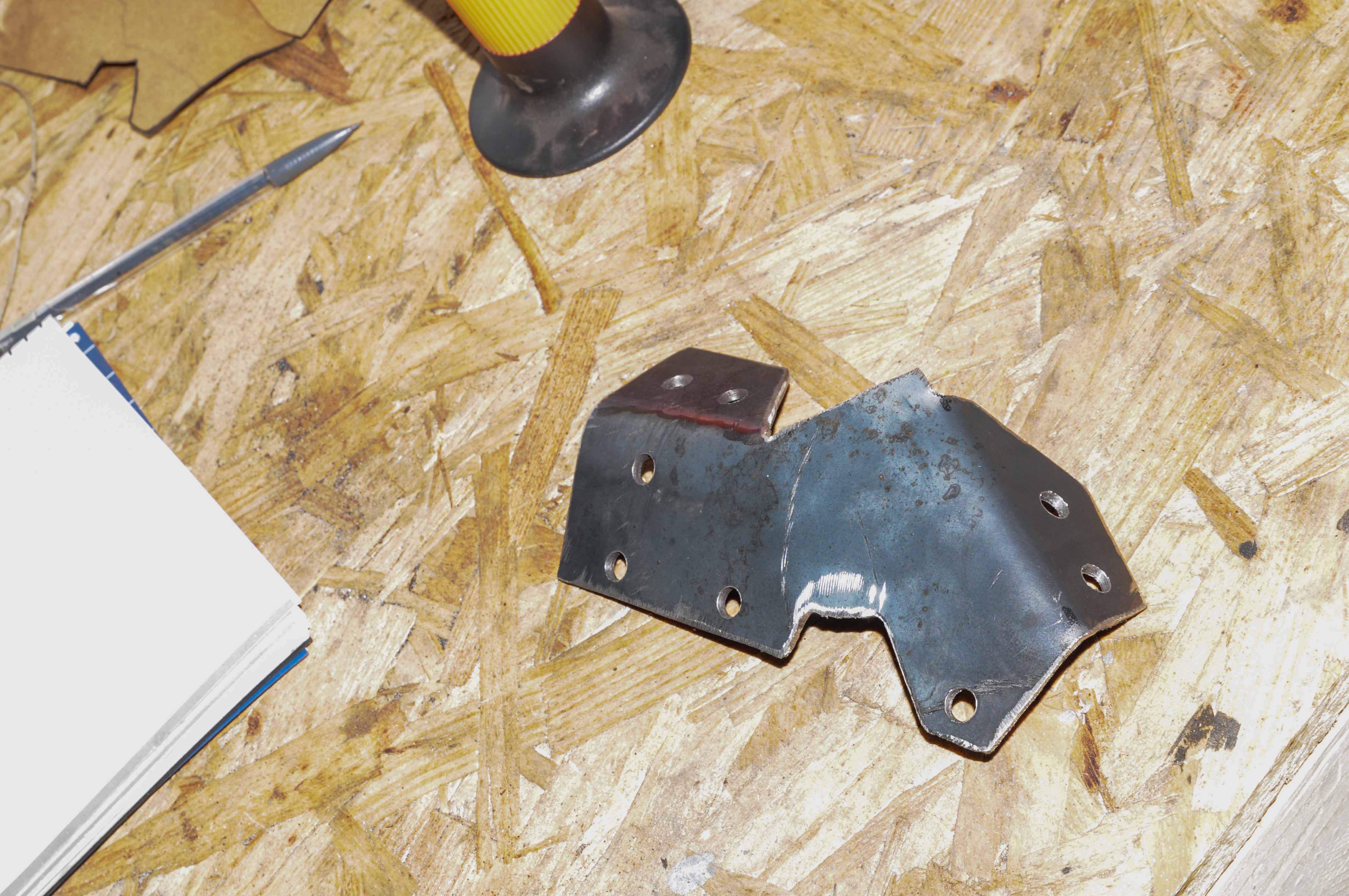

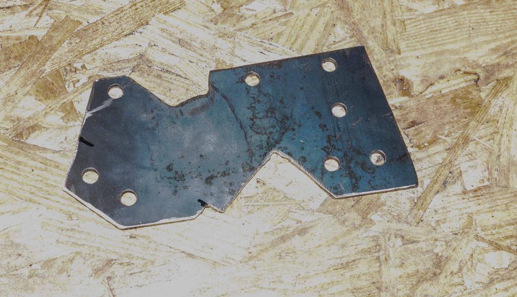

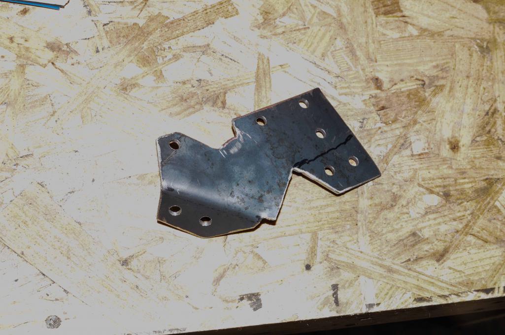

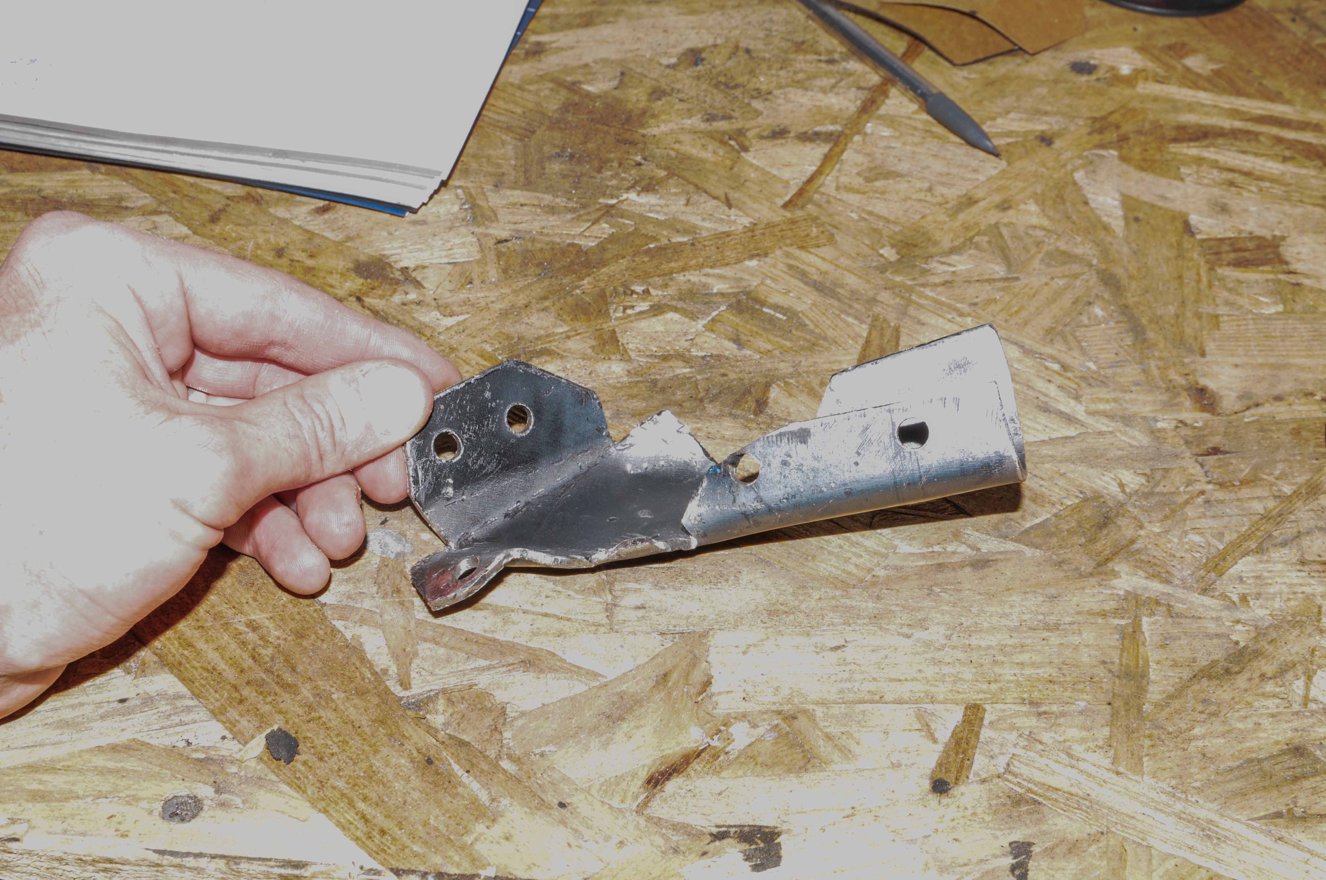

I went with the 12 gauge and found that it really wasn't too bad. Formed in one piece with a vice, torch, and BFH. The first picture shows my multiple cardboard forms and the 20 gauge sample/practice pieces.
Attached Image Attached Image Attached Image Attached Image Attached Image Attached Image

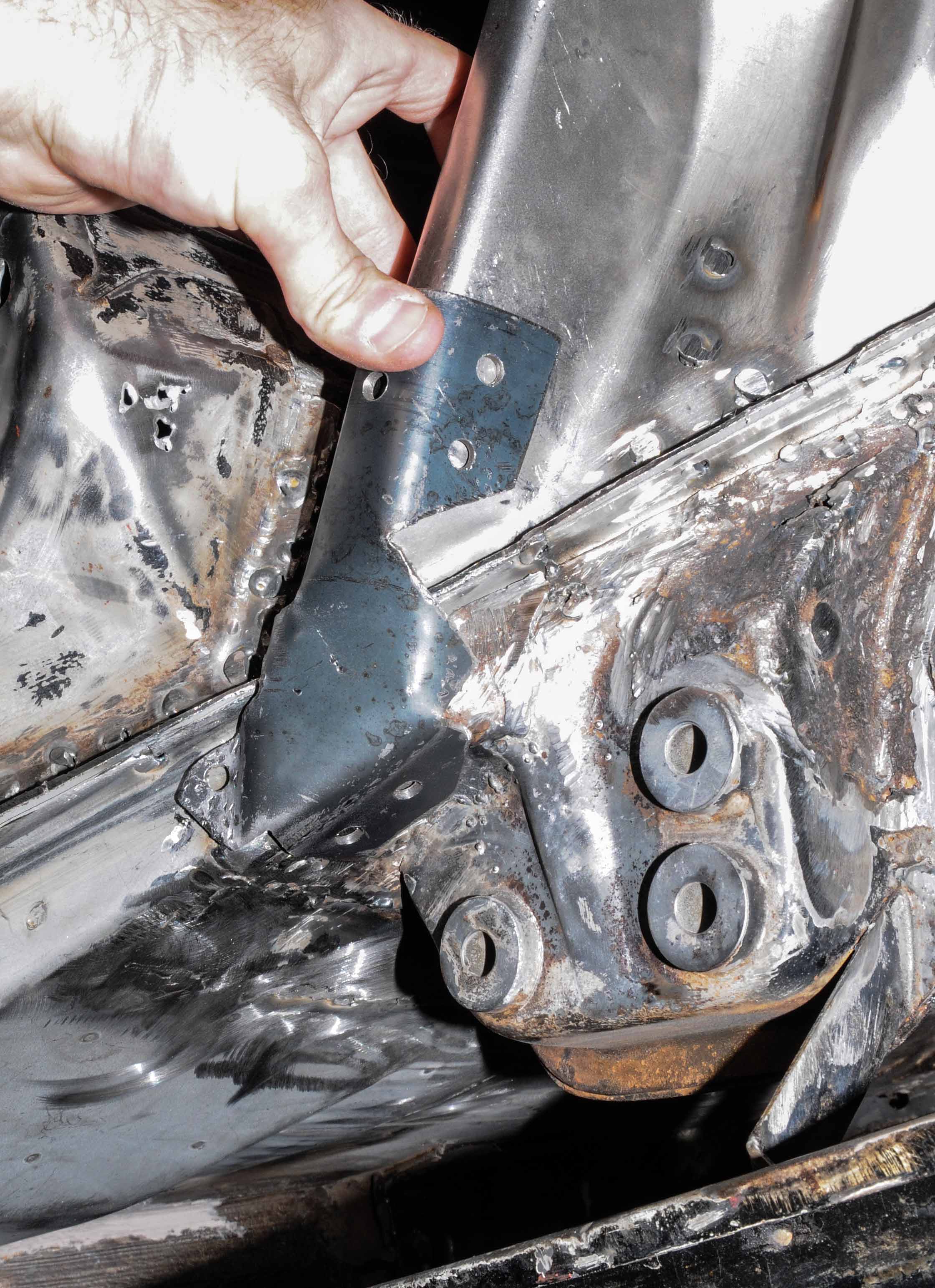

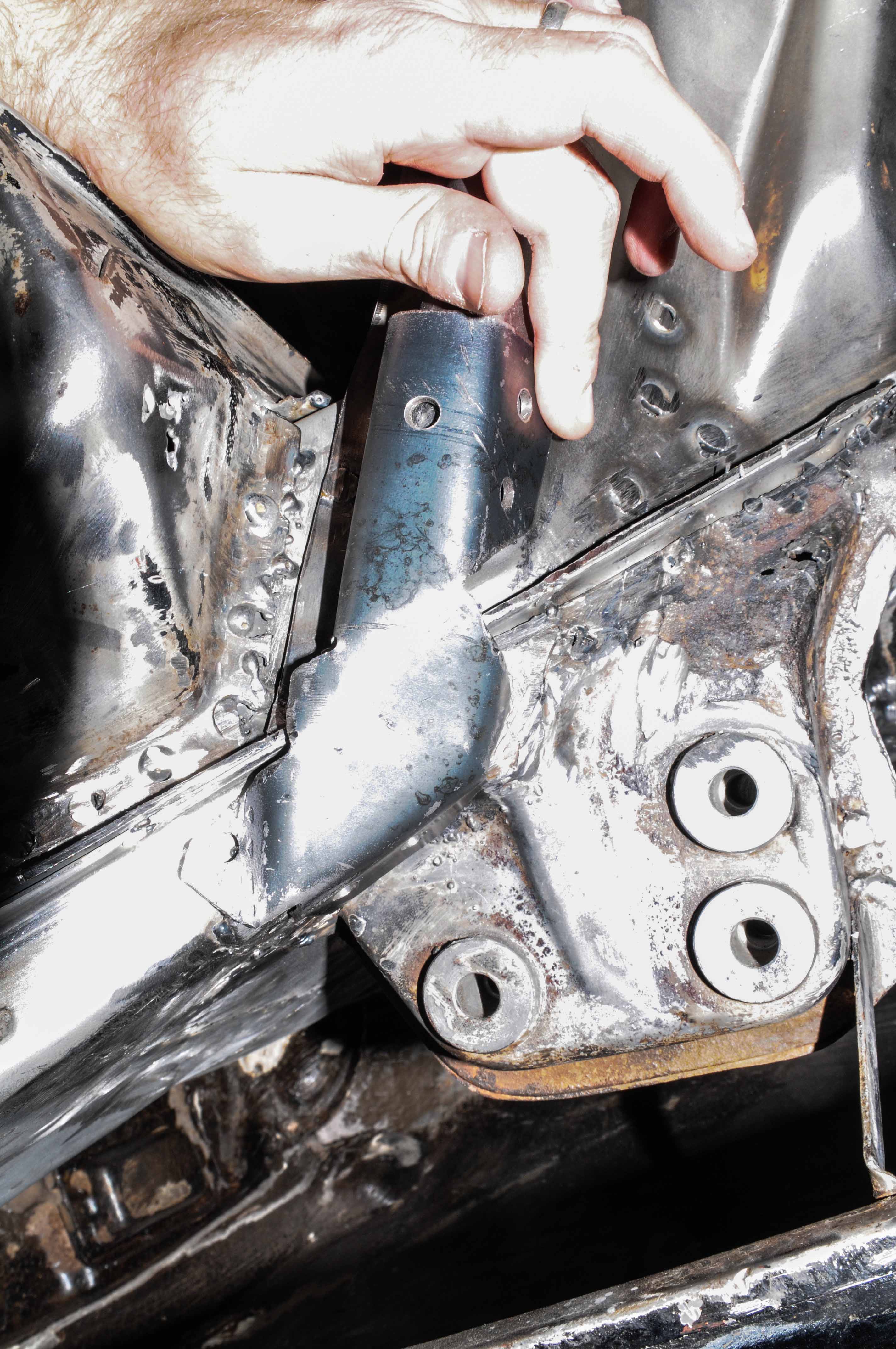

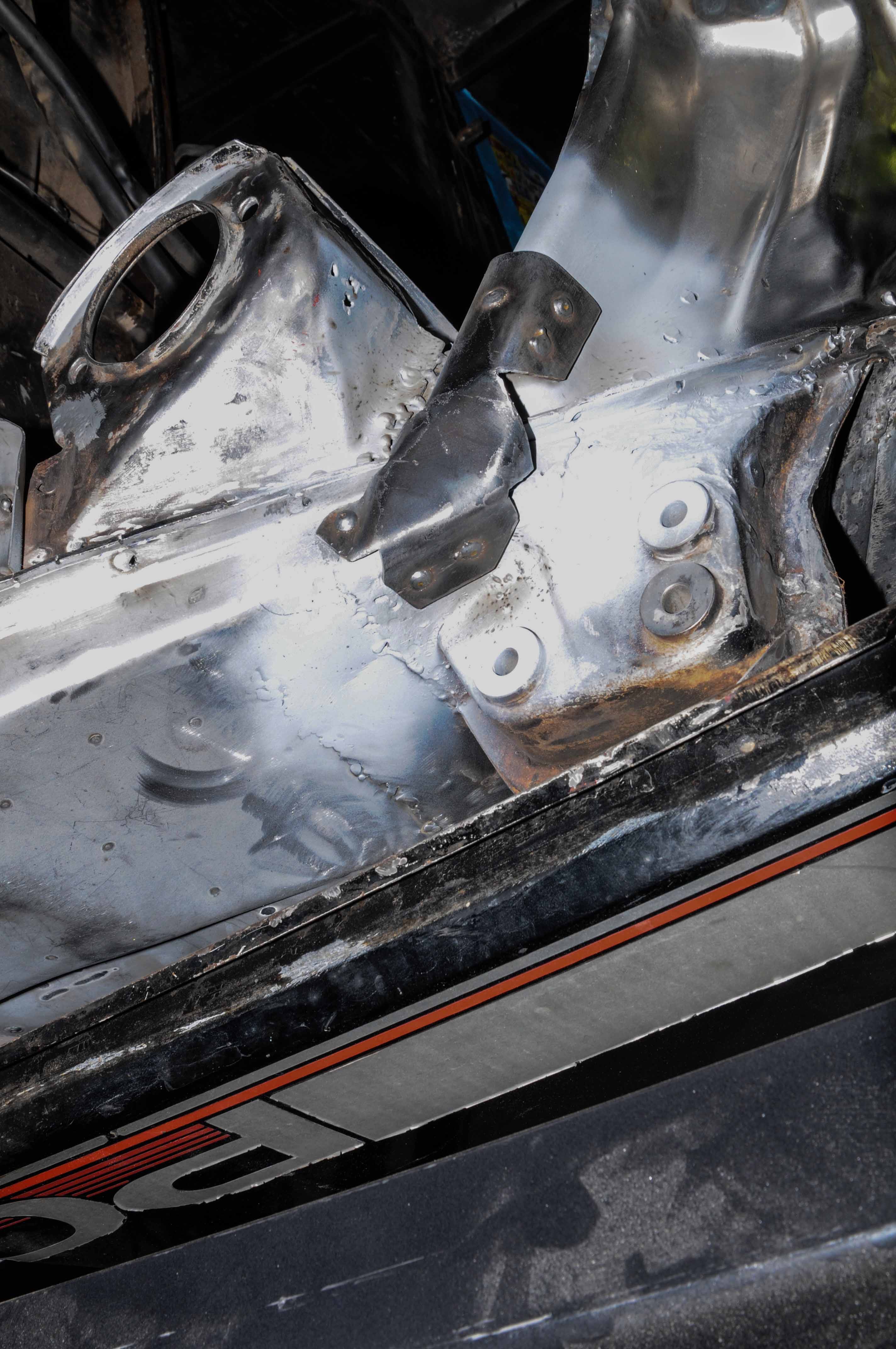

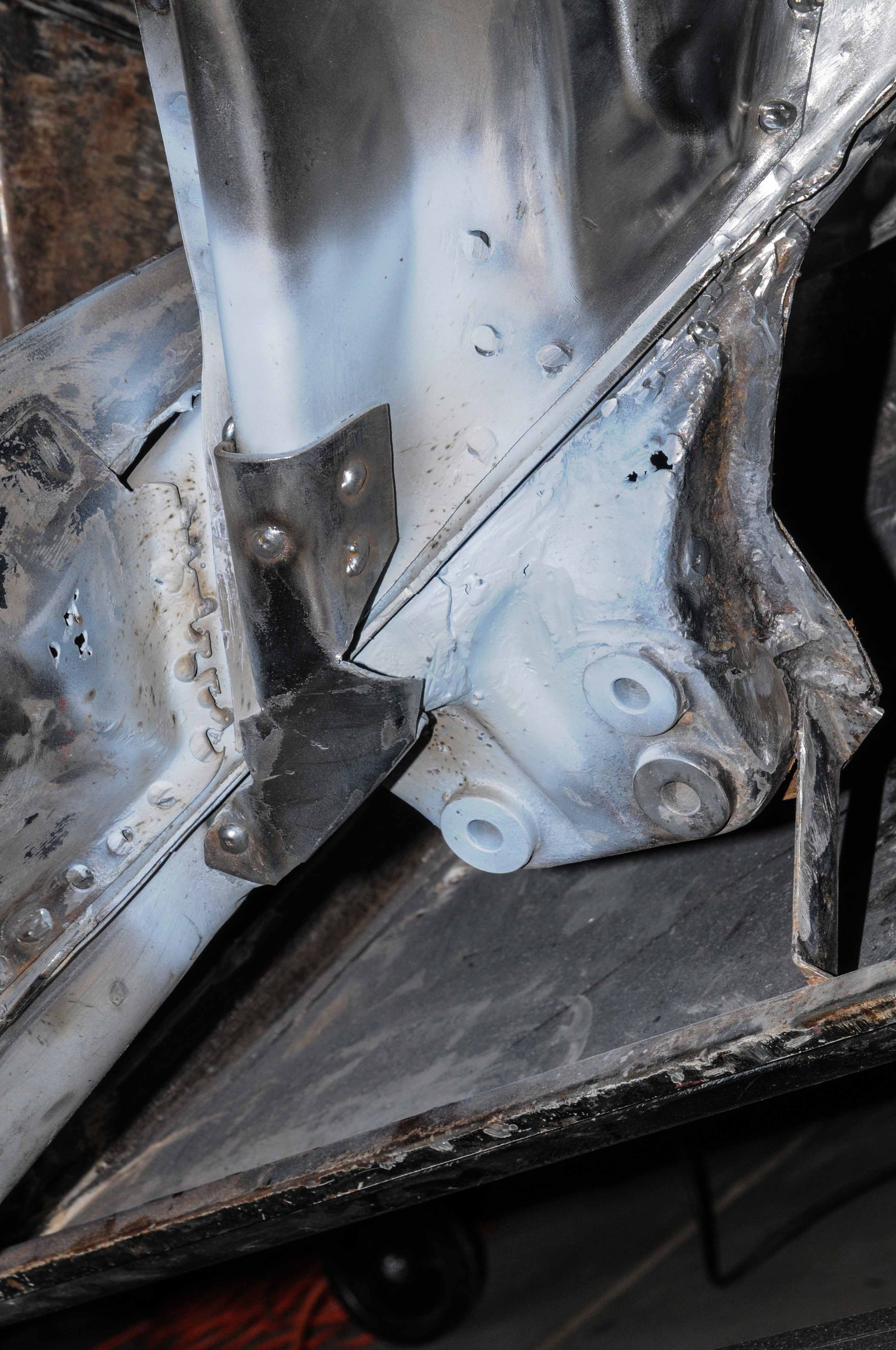

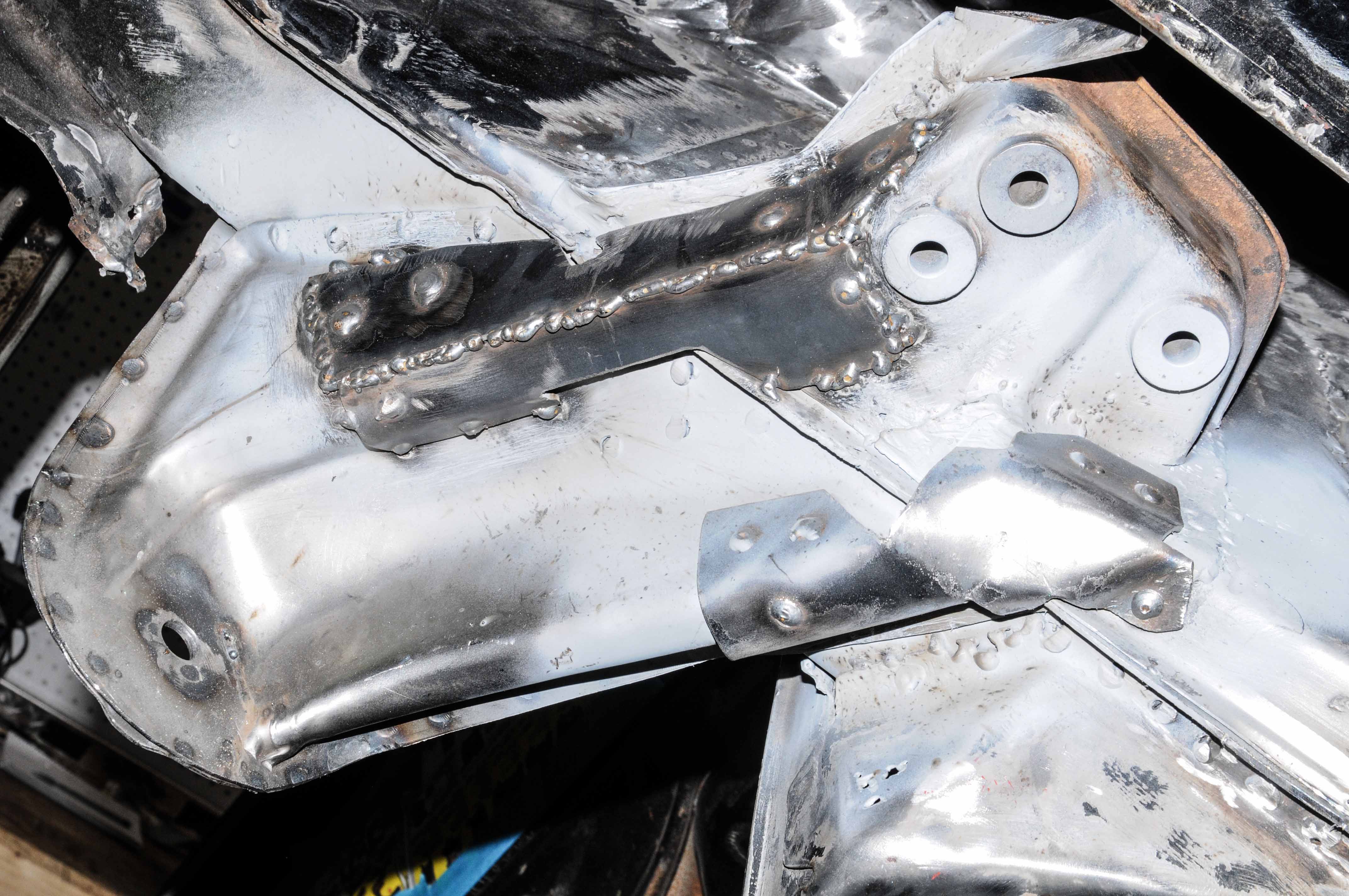

Some more pics. For the bigger tie I used the method as seen in the link.

Is it my imagination or does it look like seam welding could help the overall strength of this assembly?

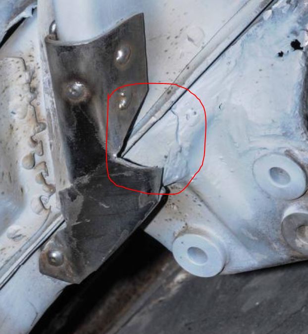

QUOTE(mgp4591 @ Jun 13 2016, 05:39 AM) *
I think you're absolutely right, I'm going to see what's up this weekend.
I'm also thinking about adding a little triangular piece in this area:
And an apology to mbseto, I should have known that as the early phone watcher I'd have nothing better to do at work this morning and should have brought the templates in to scan (I'll have to do them here at work anyways...). I'll try and see if I can trade an opening duty with somebody for later this week.
draganc
post Jun 16 2016, 08:08 PM
Posts: 725
Joined: 2-November 09
From: central new jersey
Member No.: 11,000
Not trying to be a dick, but your seam welds look like they didn't penetrate the metal.
The spot welds looks right on!
PS: great design/work!
