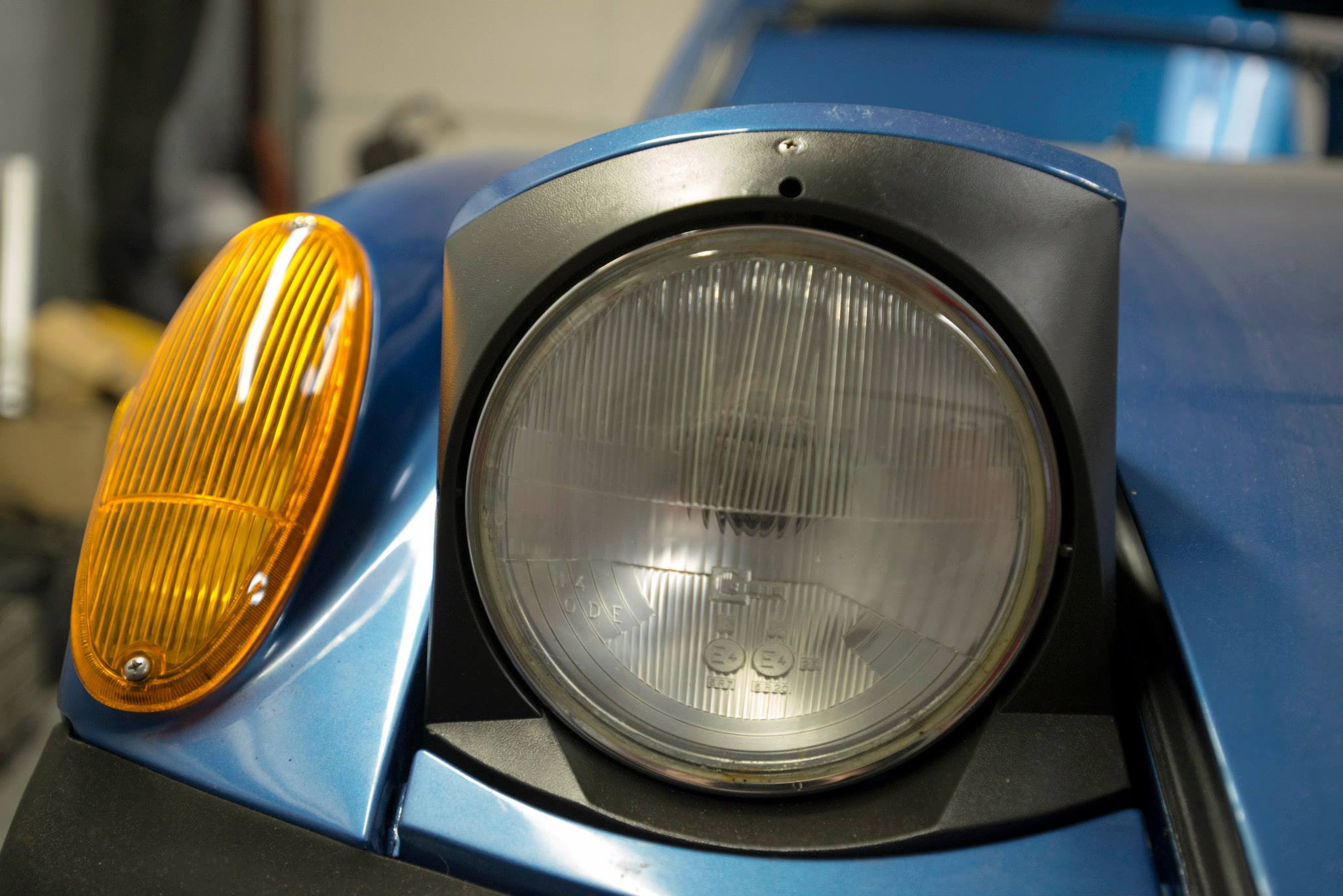

The BusDepot has good deals on the Cibie E-code copy ($35/pr) or Hella E-codes ($70/pr) plus bulbs.
http://www.busdepot.com/nl910ch4/
(IMG:http://www.914world.com/bbs2/uploads_offsite/cdn.busdepot.com-26-1467043928.1.jpg)
