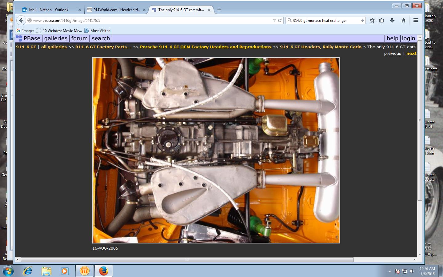

FYI I was looking at Armondo's 914/6 GT site and saw this picture of the Monte Carlo 914/6 GT's heat exchangers...never seen anything like them before. It must have been so they could run defrost etc at the rally:
http://www.pbase.com/9146gt/image/41939268

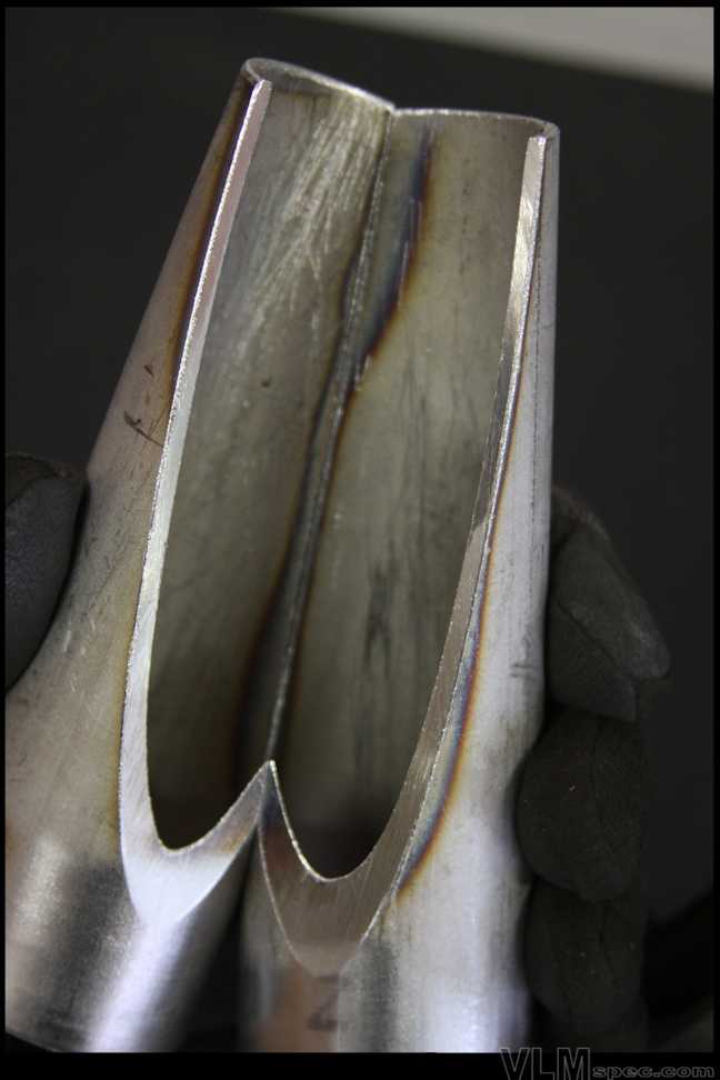

I think I know what you're talking about but do you have a picture or link handy? I'm visualizing the collectors you can readily make with a jig in a bandsaw/chop saw like these.
Yes exactly
