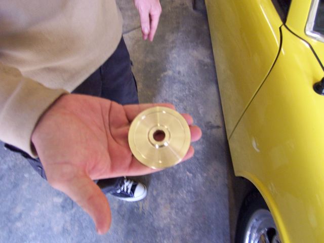

QUOTE(stugray @ Jul 31 2016, 08:22 PM) *
don't I recall seeing pictures of an aluminum or brass clutch pulley from somewhere?
Like this?

Series9 (Joe O'Brien) is responsible for the original in my photo. I am confident he can make one for you.

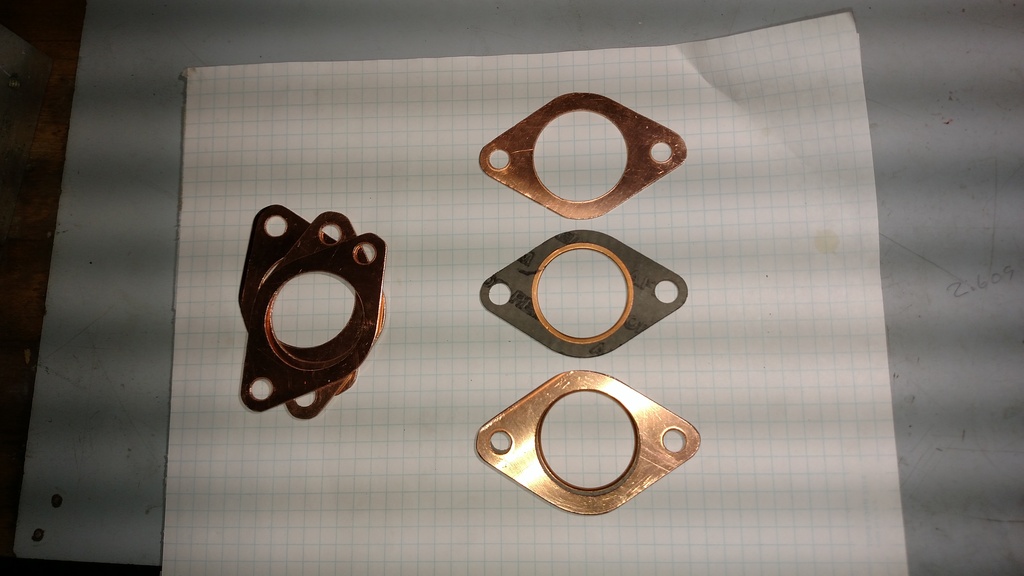

I would try the no gasket method if the flanges were out of the car and I could sand both sides of the interface flat.
But since I dont want to remove the stubs from the car this time, I bought a sheet of 14 Ga soft copper and spent a couple hours making these:
(IMG:http://www.914world.com/bbs2/uploads_offsite/i366.photobucket.com-10819-1470592579.1.jpg)
In the pic you can see the stock 911 exhaust flange gaskets have an OD that is just smaller than I needed.
The lower gasket in the pic is sitting on top of one of the OEM gaskets so you can see that the ID was too small for my 1.5" pipes.
I'll sand them flat and anneal them before I try em.
