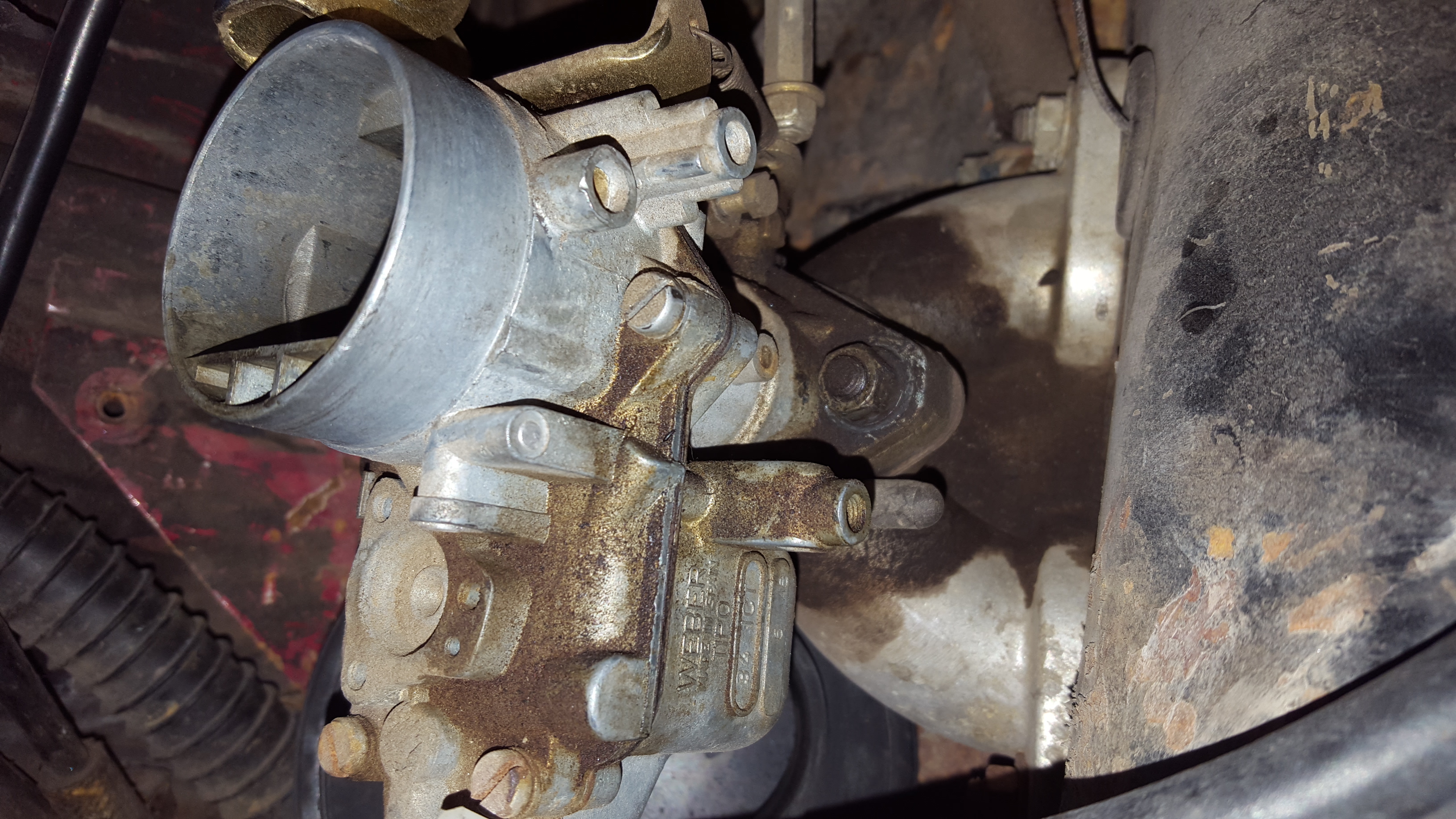

The beauty of Weber carbs or Dells is that they are easy to tune and quick to change jets. Learn this art form and be the carb guru for the next generation....there are several good books and tons of online tutorials.
First off, take a pic of your carbs and post it here so you learn what you have and then know where to start.

So they are Webee 34's. I would be curious if this leads to any other information thanks!

I'm personally not a fan of the ICT baby webers, I'd save some dough and get a set of IDF's.
The best tool is a wideband O2 meter, even a rookie can get near perfect AFR when jetting with a wideband. They are now fairly cheap at around $200, sometimes you see them on sale for even less coin.
