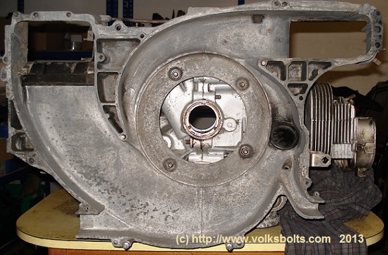

http://www.volksbolts.com/faq/cooling.htm
Maybe more info than you want..... but click the link and scroll down to TIV.
Plus the fan housing has small openings on the bottom. the air from the openings goes into the HE. There are little "gravity" flap doors that keep hot air from coming back into the cooling fan during idle. So if your flaps are stuck closed..... If you have removed a HE you can pinch them closed upon re-installation. They must be checked before the HE is too snug and tightly installed.
