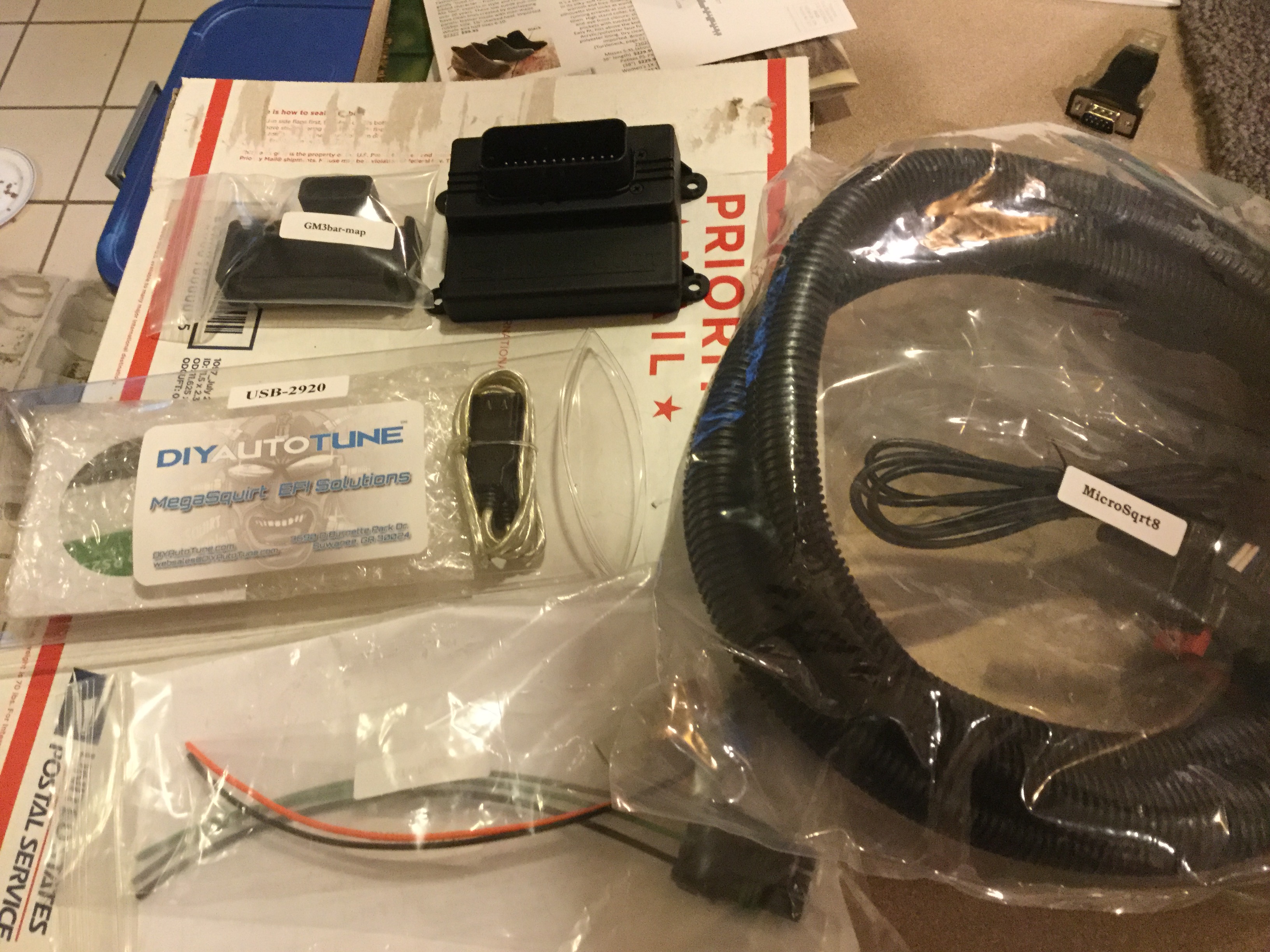

First box of goodies!

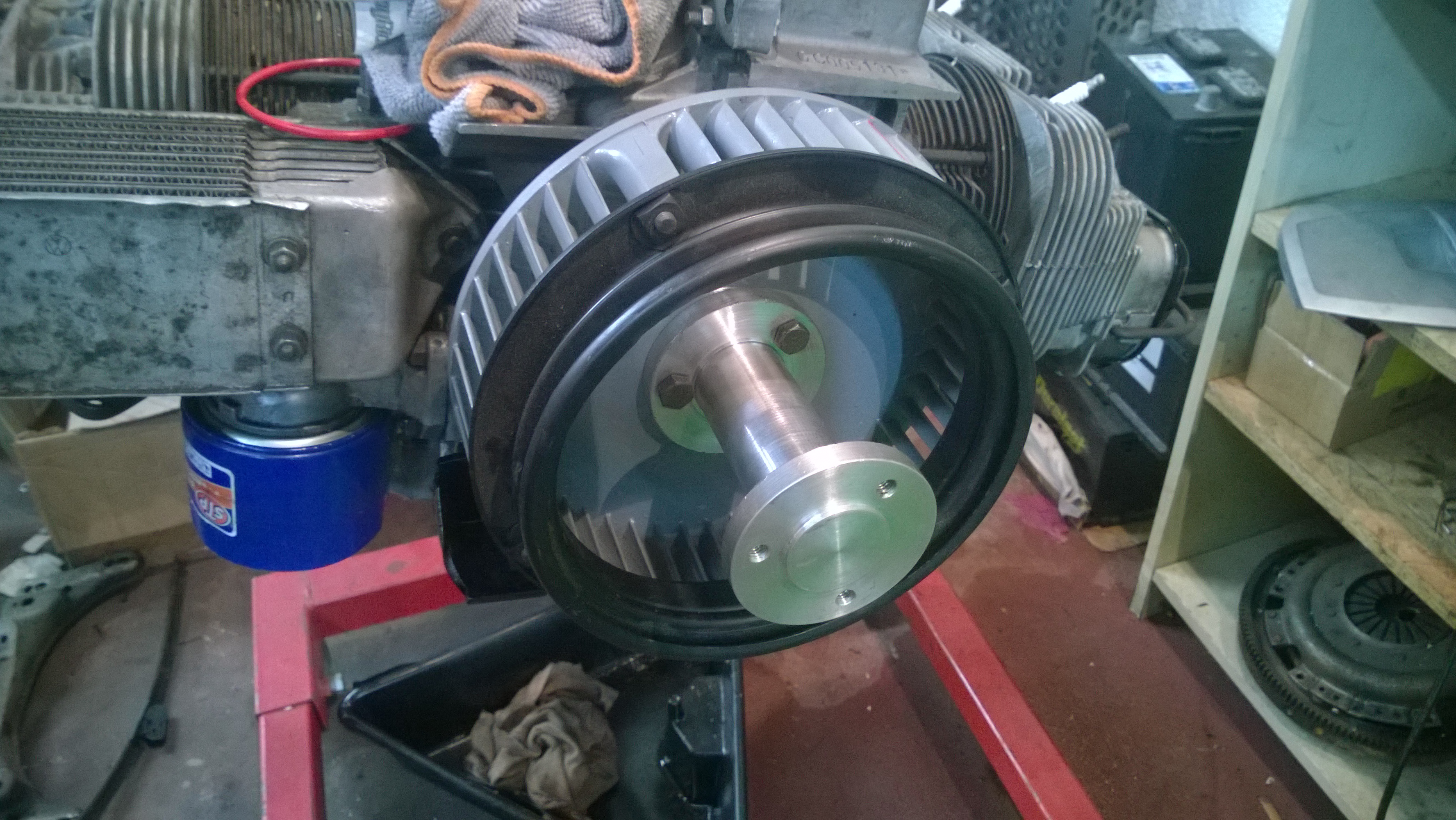

I think you started down this distributor road because of AC. I am 99.9 % certain that the stock AC pulley is not an issue with Original Customs trigger wheel setup. I either gleaned that here or discussed it directly with Mark.
I attached a pic of the AC adaptor that I will be using.

The crankshaft trigger wheel, either the DubShop's or Original Customs', goes between the crankshaft and the fan. It does not space the fan out farther so I don't believe it would have any impact on an A/C fan pulley.
Using the crank sensor wheel does give you the opportunity to implement FI first and add ignition later. A cam (distributor) based RPM sensor forces you to do both FI and ignition at the same time.

Maybe I am not picturing it correctly, but how does it go between the crank and fan and NOT space the fat out further?
It would seem a Dist trigger wheel could easily have two missing teeth and give you the same trigger as a crank wheel, but could also give you came timing should you ever want sequential FI and/or not run wasted spark.
P.S. Not arguing, just asking to learn.
jd74914
post Oct 7 2016, 11:26 AM
Post #60
Its alive
Posts: 4,875
Joined: 16-February 04
From: CT
Member No.: 1,659
QUOTE(N_Jay @ Oct 7 2016, 12:20 PM) *
There is a thick washer under the fan that gets replaced. (IMG:style_emoticons/default/smile.gif)
