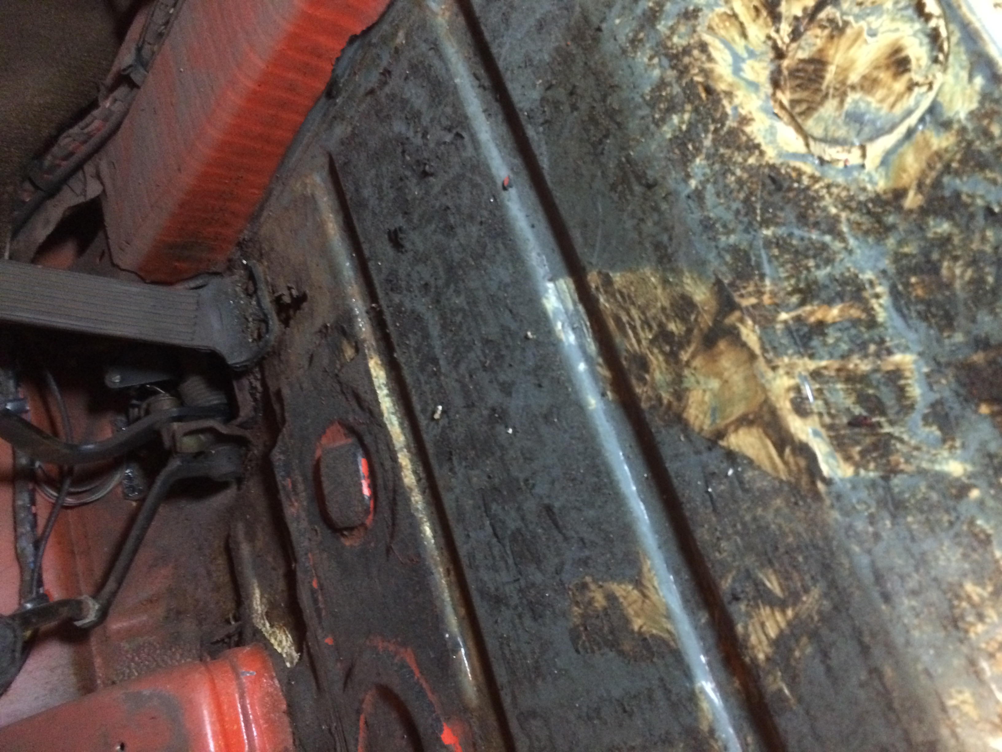

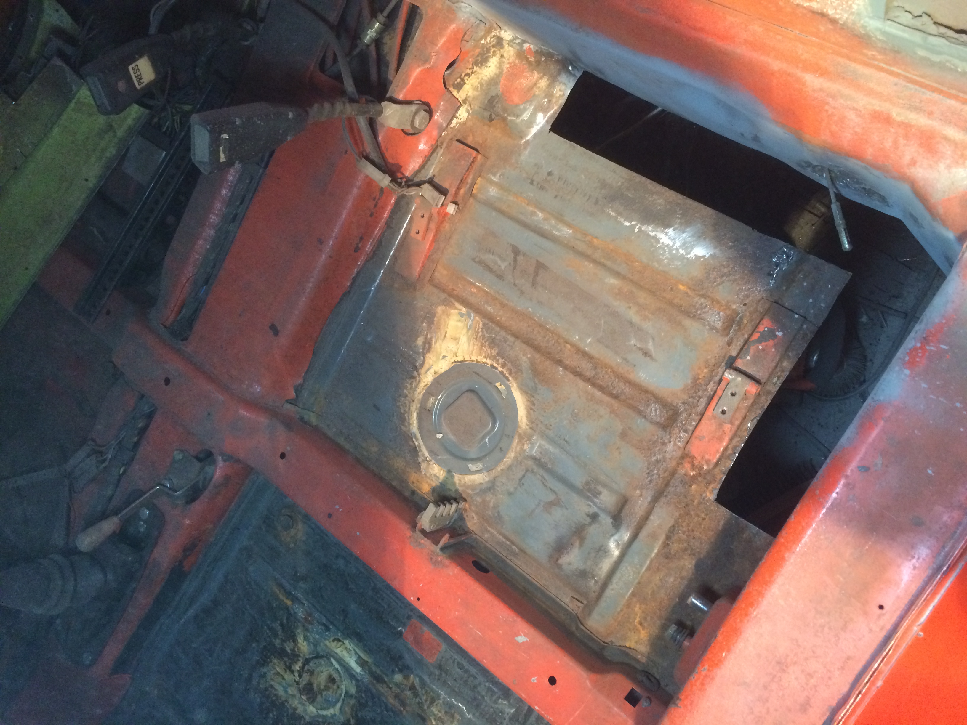

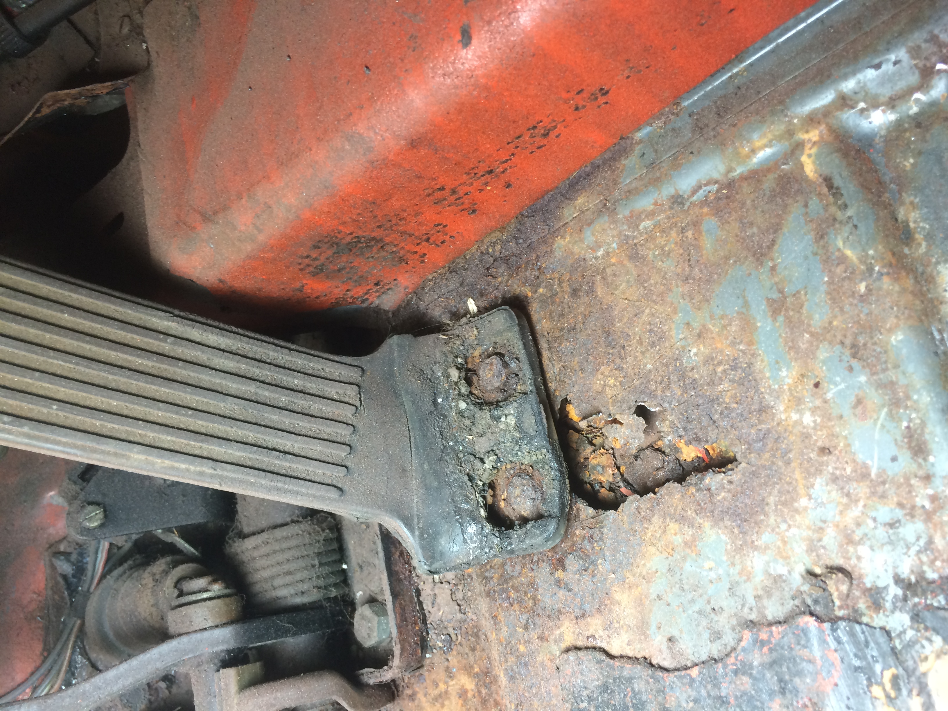

you may see like these under tar.
ndfrigi
post Oct 15 2016, 02:25 PM
Posts: 2,978
Joined: 21-August 11
From: Orange County
Member No.: 13,474
