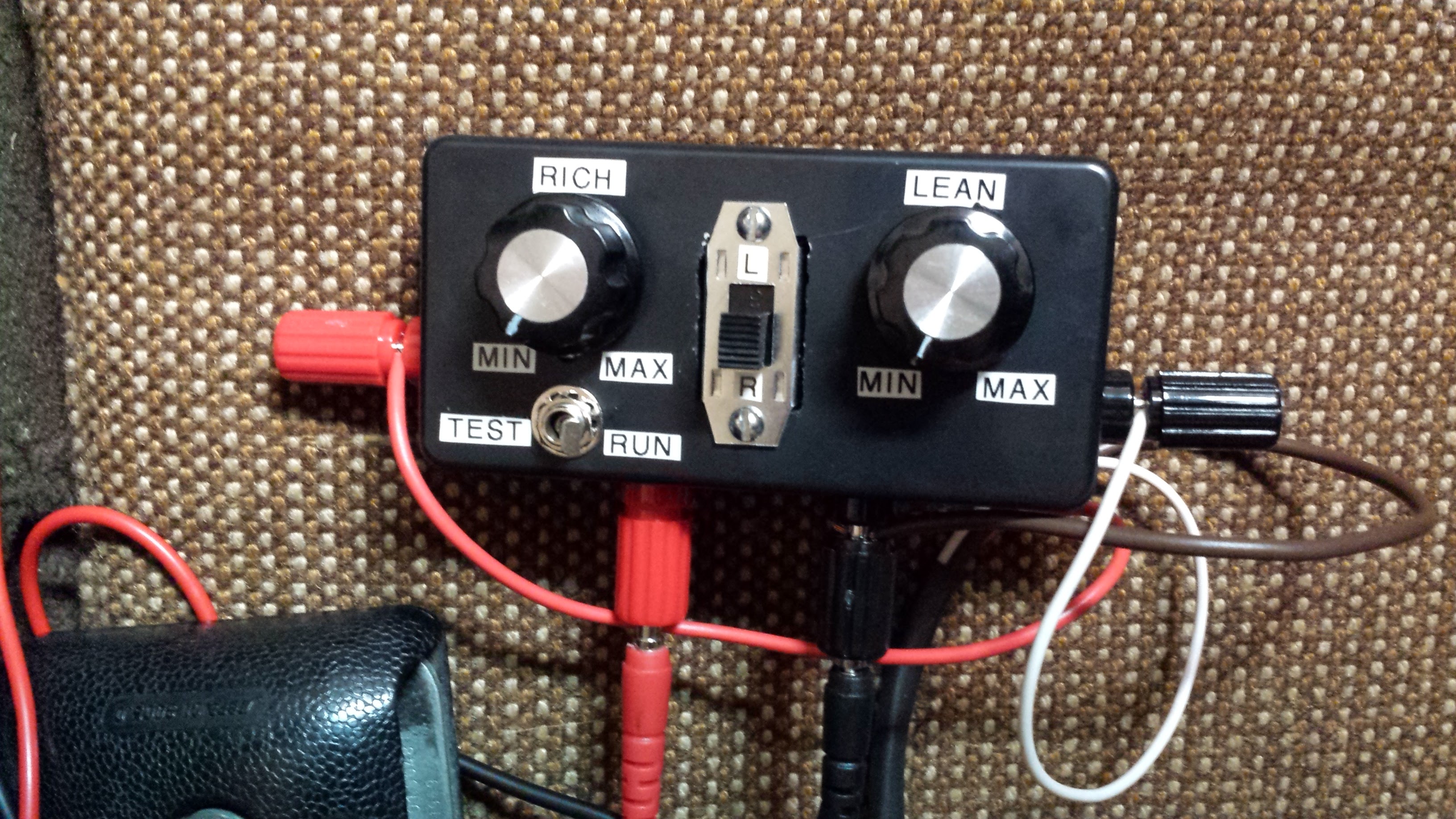

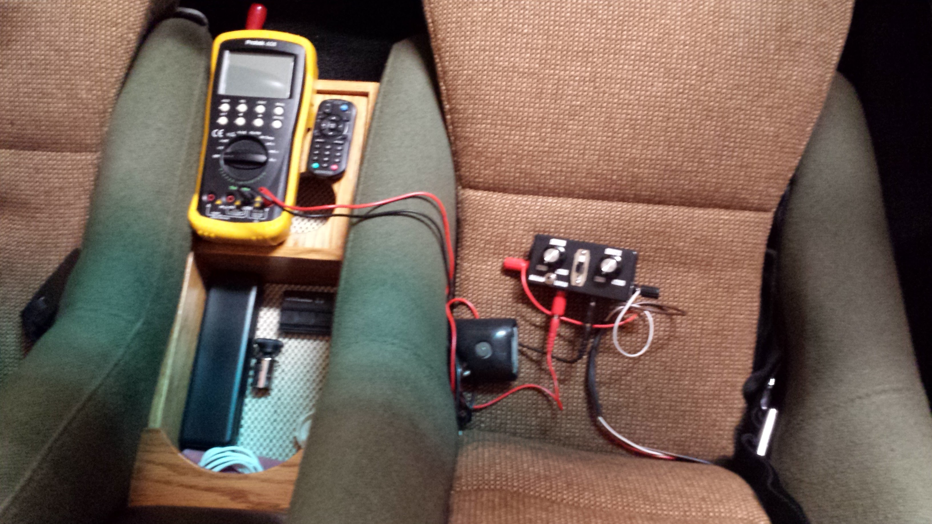

OK, a couple of pics of the setup. Right now, the cable from the engine compartment is just going through the side gap in the engine cover and coming over the roll bar.
This is the box, you can see it has two pots, one for rich and one for lean. The center switch chooses which function is active, and the switch on the lower left isolates the combination of the box and the CHT so that you can read the resultant resistance. When it's in "Run" mode, you can measure the voltage at the node. Connections from the engine compartment are the CHT (white), the wiring harness connection to the ECU for the CHT (red), and ground (brown, taken off the mount for the vacuum limiter and MPS). The red banana lead on the bottom test point, which is connected to the DMM shown in the next pic (black banana lead is DMM ground).
