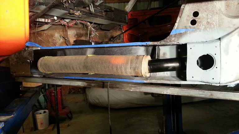

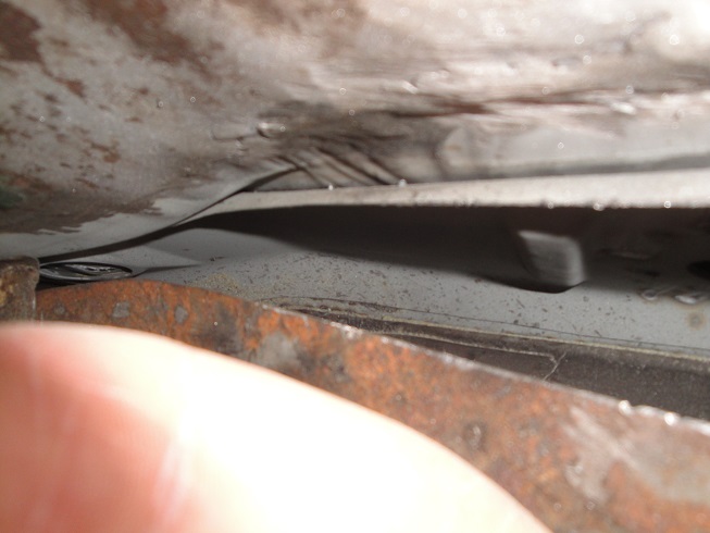

Here's a shot of the area your trying to tackle.
That primered area is the inner/stiffener layer of the outside of the long.
The backside stiffener goes up and lays under the seat belt nut.
Another looking down from the top of the hell hole.

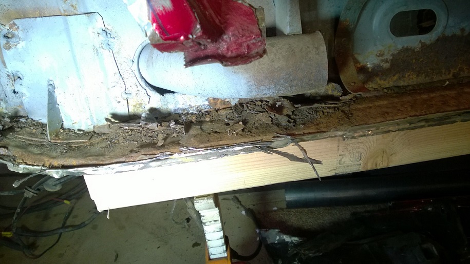

And here's what it may look like on the inside if you have rust issues and the PO did a sketchy hell hole / long repair job (IMG:style_emoticons/default/barf.gif)
I would think the interior frame coating products would help (couldn't hurt), but they're more for prevention of rust damage (or further damage). If you already have a lot of metal detritus in the longs (as shown below), you probably need to open 'em up. As mentioned, you can put a scope in inside and take a look (but you may not like what you see (IMG:style_emoticons/default/blink.gif) ).
The PO of my car pictured here didn't want to go inside to treat the longs. He slapped a Brad Mayeur kit on the outside of the longs (I didn't know about the kit then and it took me a while to figure out why I seemed to have three layers of metal at the seams). The Brad Mayeur kit did a good job of preserving structural shape and integrity even as the insides were rotting, but my goal is complete resto, so I wanted to get all this garbage fixed.
