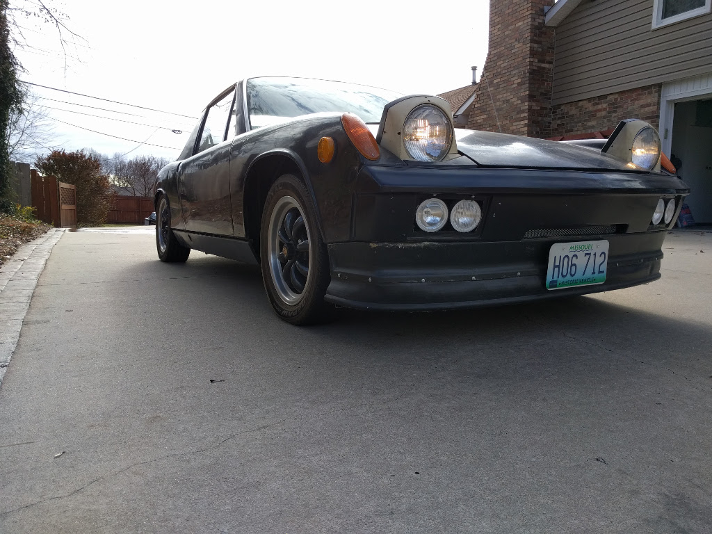

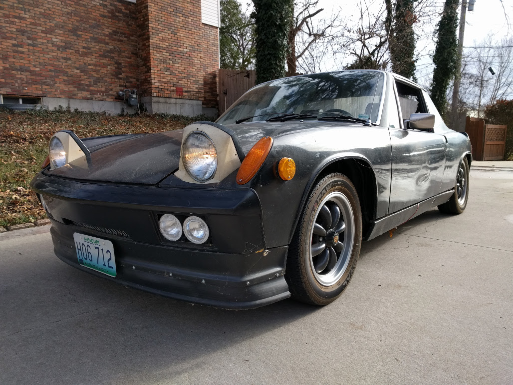

Long term: paint's rough, body has some dings and rust (and I need to examine the hell hole). It'll need more gofast eventually, but doesn't everything? (IMG:style_emoticons/default/biggrin.gif)
Left Side
Right Side
