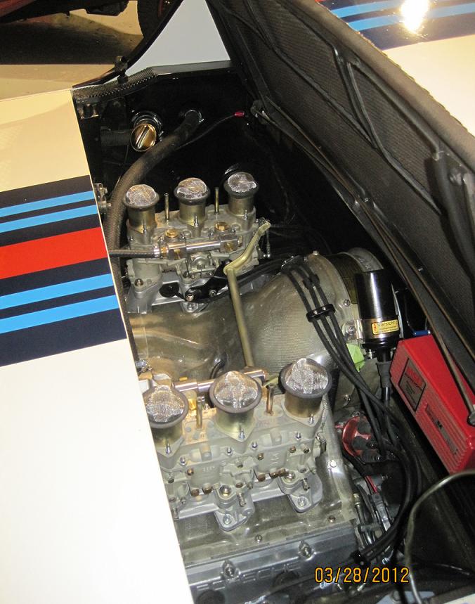

Mine from Getty Design is just as you describe and is $419.00 so there must be a market for it... (IMG:style_emoticons/default/dry.gif)

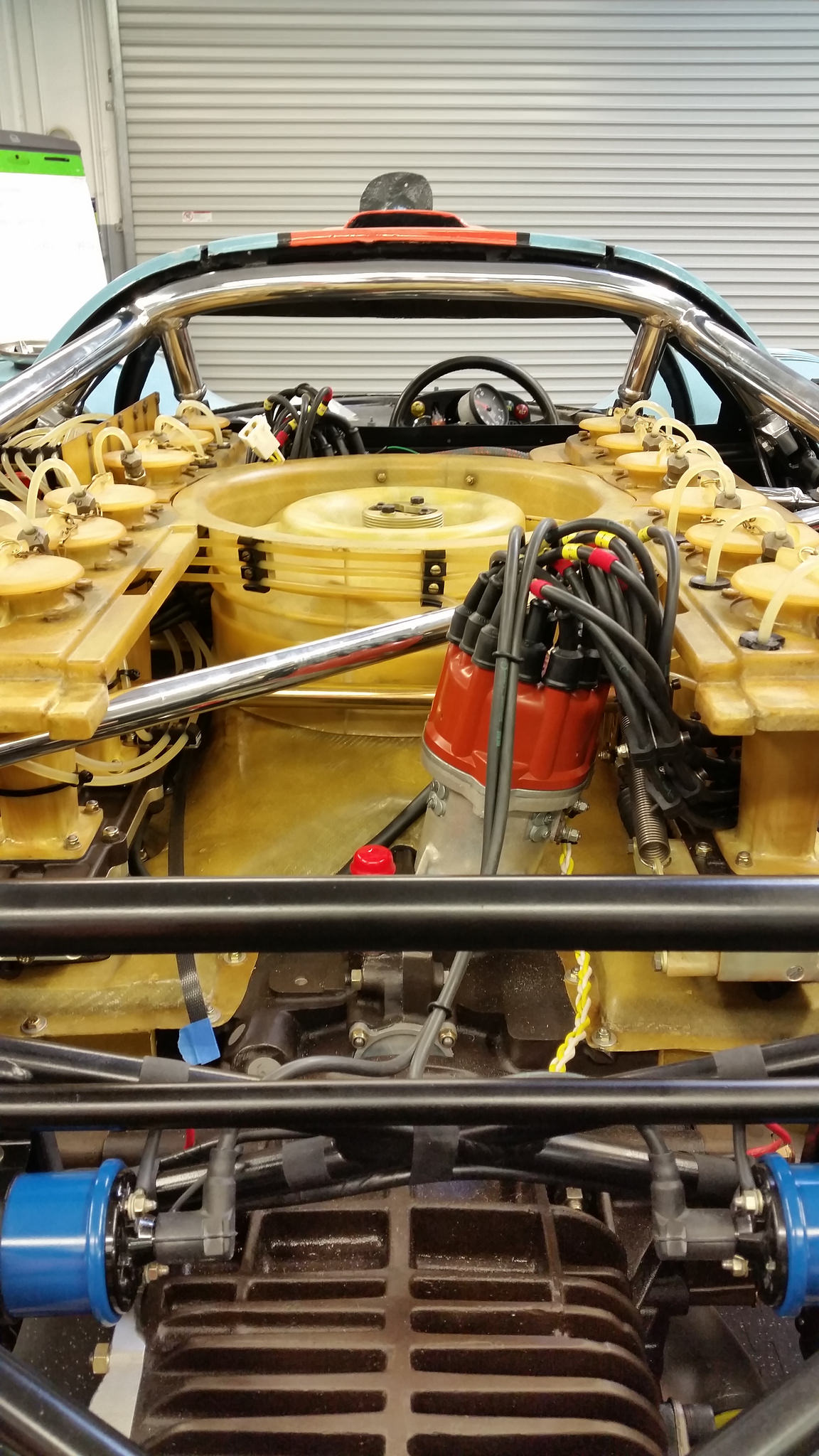

Cost was not a driving factor for considering making these. I want a set, and my dad wants a set, so it seemed reasonable that others would to. The $390 was a rough cost estimate based on supplies and time, but the goal is not to make money.
At the end of the day, I might be able to get them into the $200's for forum members.
This is the color that it will be. Doesn't get more authentic.
(IMG:http://www.914world.com/bbs2/uploads_offsite/farm8.staticflickr.com-9714-1468698516.1.jpg)

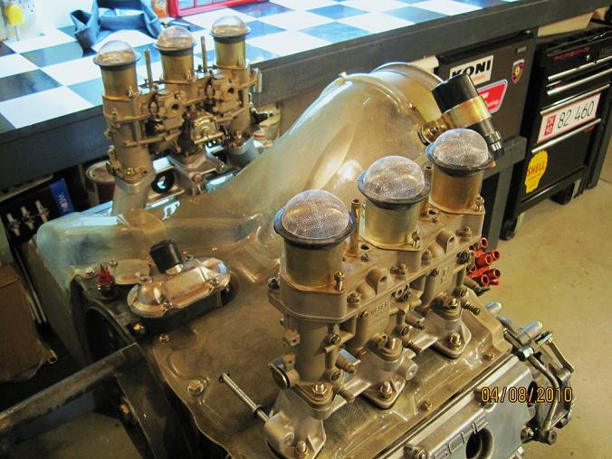

Mine were from Getty as well. fit was awesome less one block off, which they promptly replaced. I love that look. Good luck with the upstart. (IMG:style_emoticons/default/beerchug.gif)
I always wondered what the -4 engine tins would look like in the amber glass....

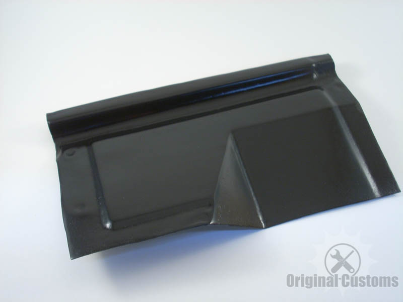

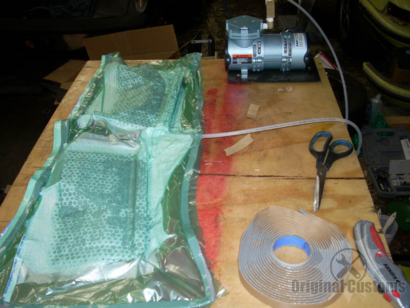

Vacuum bagging has it's own tricks to learn, but it's not complicated. Bought this pump for less than $100.
Heres the first bagged part I made.

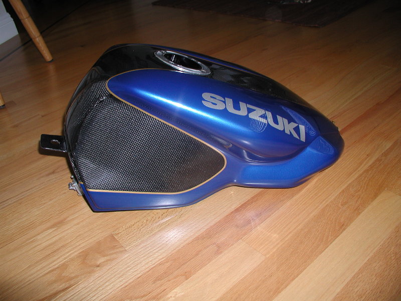

I did a fair bit of hobby composites, including a carbon fiber gas tank for a friend's race bike. Not Porsche content but here's the detailed build thread, if you're interested in wasting a few hours!
http://bayarearidersforum.com/forums/showthread.php?t=145975
I far prefer epoxy resin (I used West Systems, available a your local West Marine store) and got my fabrics through Fiberglast.com.
I got a small Gast vacuum pump on ebay for ~$100.
Take your time, particularly with the mold, and with a bit of practice, you can get a pretty nice result. Here's another carbon tank I made. This one was for my custom SV 650. Gotta say. I'm pretty proud of how it tuned out.
