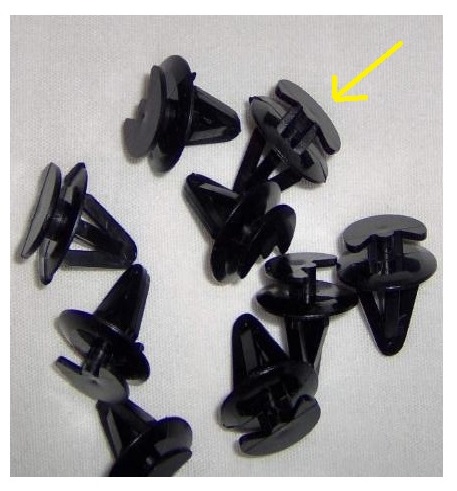

If your going to try and pull the door card yourself :
Now that I'm a professiona1 take apart guy. My only words of wisdom is get close to the clips before you unsnap them. Like mepstein said, some will break, SOP. What you don't to do is tear up the hole in the door card.
The yellow arrow shows the part that screws into the door card. The fiberboard in the door cards sometimes get soft (breakdown) from moisture over the years.
Photo stolen from 914Rubber

I've removed several door panels from various cars over the years but even with very careful use of semi-rigid plastic tools, a few at the front lower corners pulled through both panels. The culprit was large holes cut for speakers with no backing plate or vapor barrier behind them. In the past I was able to successfully repair the fiberboard holes to hold new clips with epoxy or polyester resin although several hardening glues would do the job, probably with less effort and mess.
