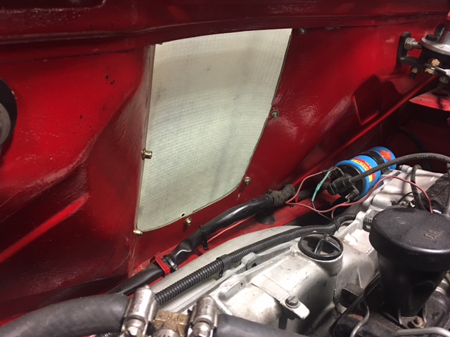

So if you want to "see" your pulley and case when timing, try this. Pull the hatch cover off with a few bolts, and aim your timing light.
Also, change the belt and adjust for tension while at it. .. shown on type 4 as my 911 engine is not yet in...
