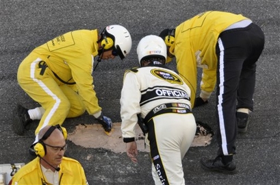

Bondo is also handy for fixing holes in the course before a race!

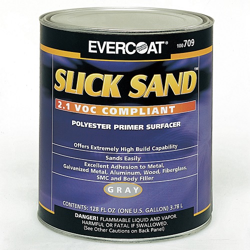

IMHO
This is pretty good spray-on bondo
Pretty easy to block flat.
You need a BIG gun to spray it though. You regular 1.8 primer tip won't cut it.
A 2.5 tip gun works good but you don't have a lot of time before it starts setting up. They say 30 minutes, my experience is it quits spraying at about 20 min. and you better hurry and clean the gun out.

Bondo thats Slick...rhymes with dick
