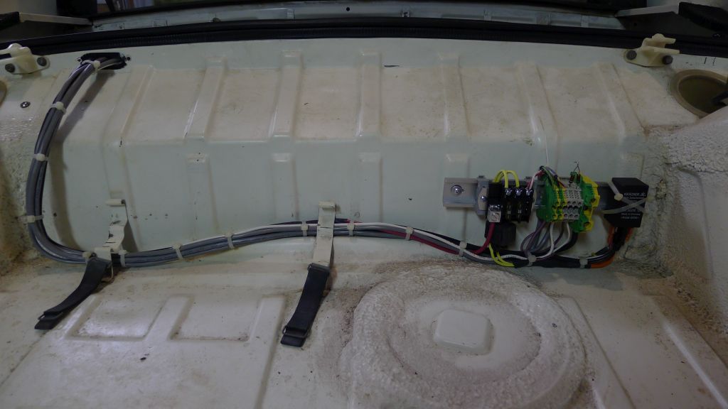

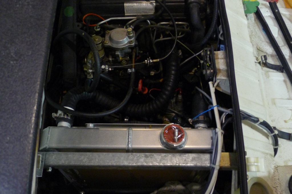

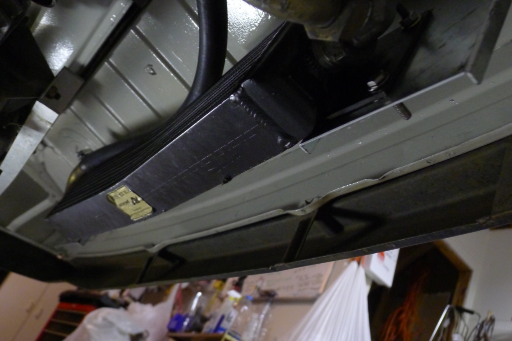

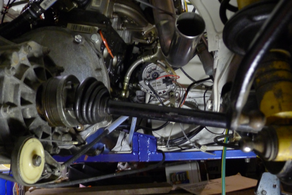

For the TD I was able to fit the radiator next to the engine. I added a second radiator in the back (RUF oil cooler) where the muffler used to be. The alternator fit with plenty of room on the back side.Attached Image Attached Image Attached Image

QUOTE(Bill D @ Jun 30 2015, 05:36 PM) *
I want to see more! Is this car running & driving?

Impressive that you were able to make that work! Adding additional cooling in the back makes perfect sense!
My project is no where near as ambitious as yours. Hats off....
The secondary radiator is plumbed just like a heater core in the stock application. There is a thermostatic switch mounted to the radiator. The plastic air deflectors were removed from the underside to allow air to flow naturally from bottom to top. The wiring is fairly simple.

As I understand it the diesel runs cooler than petrol, so would this system struggle to keep up with a gas engine?

QUOTE(matthepcat @ Jul 1 2015, 11:43 AM) *
I like it.
I had some help in sizing this radiator a while back and decided i wanted extra capacity as i was thinking of adding AC to the mix and wanted the ability to box the secondary radiator in the winter and duct it so it would work like the original heater with an inline fan. i have since decided on heating the seats and have a small electric heater for defrost. don't need much heat in NC.
it would be a guess but i think this setup could manage 200hp with the right air flow and maybe an external oil cooler to help.
i am not counting on a diesel engine running cooler. my old benz dt had a radiator at least as big as the gas version

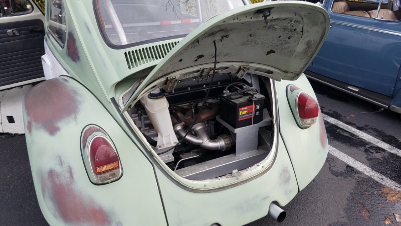

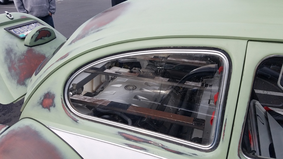

Not a 914, but I think close enough, went to small car gathering this morning and this Northstar V8 swapped bug was there.
Guy said no cooling issues with the radiator in the middle not too far from the engine.
Running rubber scoops up underneath the car.

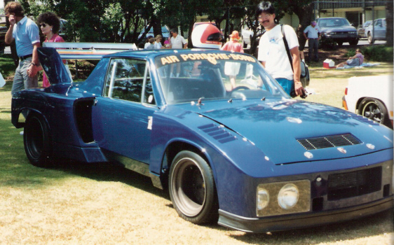

And there is enough room in the front of the 914 if you want to do it, but you loose the head light buckets and the pop up lights.
You could also just do the AIR 934 body and just run them in one or both of the side fenders.
I so (IMG:style_emoticons/default/drooley.gif) over that car as a kid. 934 engine in the correct place, full Aluminum roll cage. half a 904 sitting in the background of the VW & Porsche mag article. (IMG:style_emoticons/default/wub.gif)
