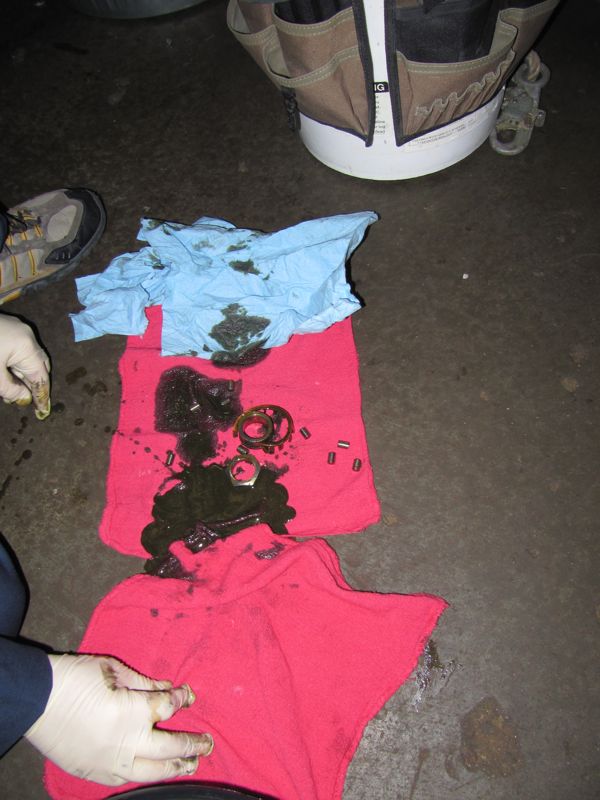

This is what I found when mine started whining on my 6!

QUOTE(Jeffs9146 @ Mar 22 2017, 11:22 PM) *
Bummer, but all the bearings look good. It's got to be a mesh issue, and most likely the pinion / ring mesh.
