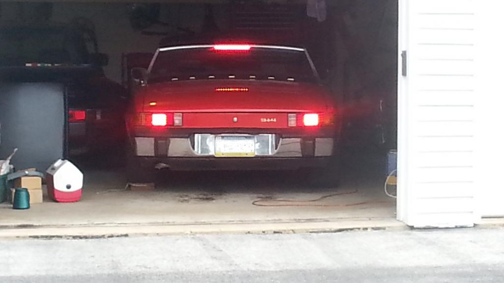

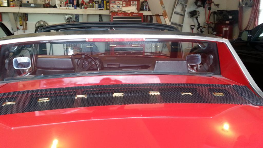

This one is 38949B at Summit Racing and is 12 inches long and 0.625 inch high. Mounted below the roll hoop it is not visible from the rear view mirror.

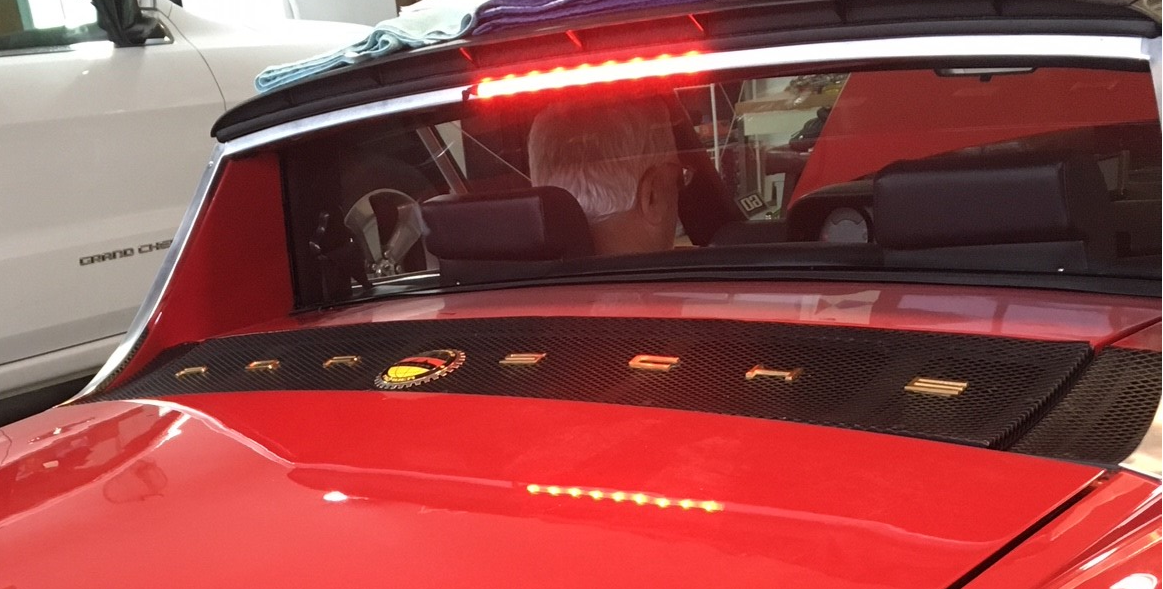

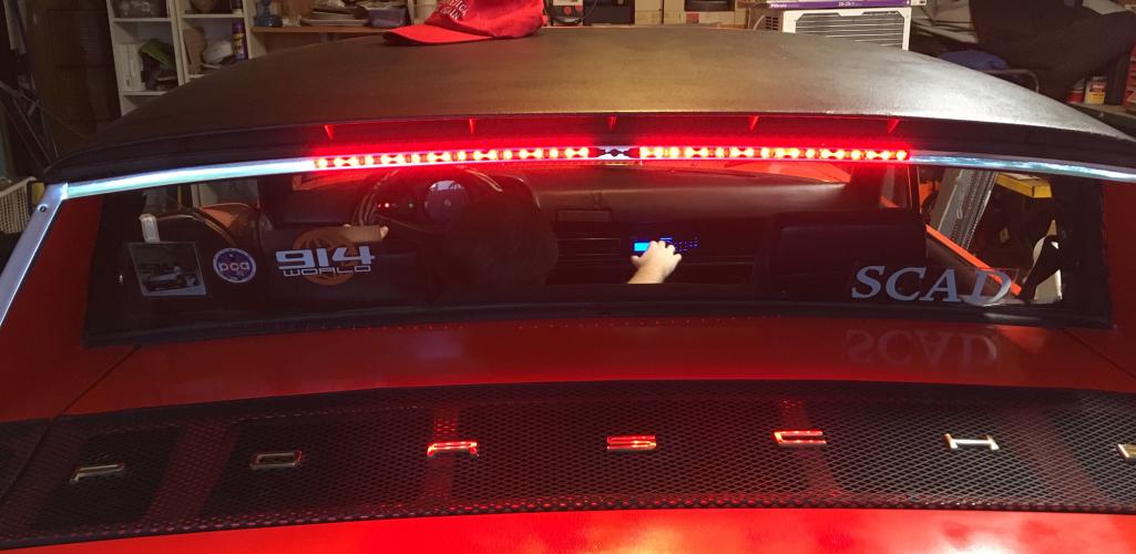

Lots of 3rd brake light threads. Here's mine. 24" across the targa bar. Autozone LED stick on lights. Still stuck down tight since 2009 on the car. Routed the wire through the chrome strip, down the sail trim, and into the trunk and wired into the brake light. Very bright night and day and I know it's saved me a few times.

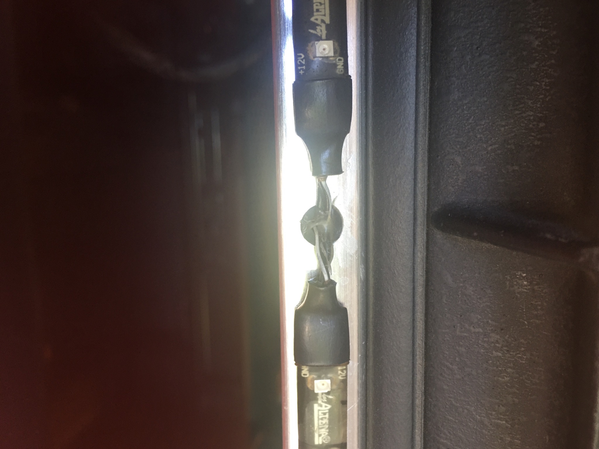

Someone asked about how the wires went through the targa trim. One simple hole with a rubber grommet.
