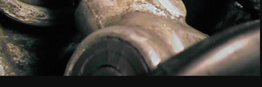

(IMG:style_emoticons/default/sad.gif) so way back in Nov my 914 stop going into gear?
I finally put it up on my lift. and found that the fire wall coupling bushing falled.
I looked at Pelican, just can't find that part?
any idea where to get one?
OK NOW THAT THE BUSHING IS IN IT FEELS LIKE I DON'T HAVE A 3RD?

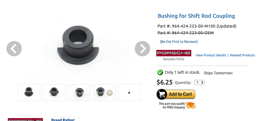

QUOTE(arne @ May 8 2017, 10:08 PM) *
No I think this is what I need,Now I just need a how to video.

DON'T BUY THE PORSCHE GREY ONES!! The OEM replacements are made for a 911 and have some slop built in. The black aftermarket ones are a better replacement.
