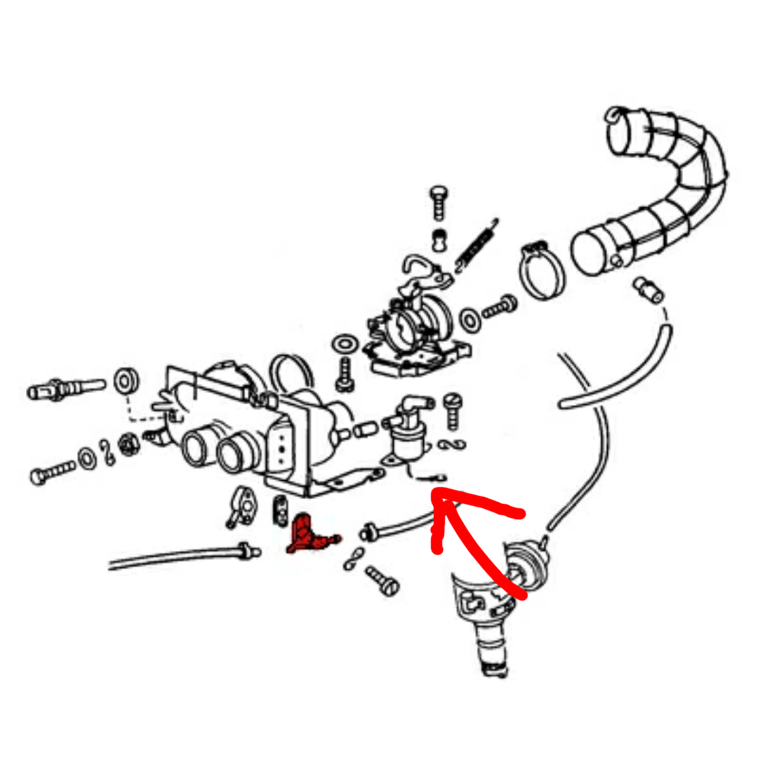

Awesome I'll connect it to a gauge then. Is the cold start valve next to the oil filler neck correct? Also here's a pic of one of the spark plugs, if that leads to anything.

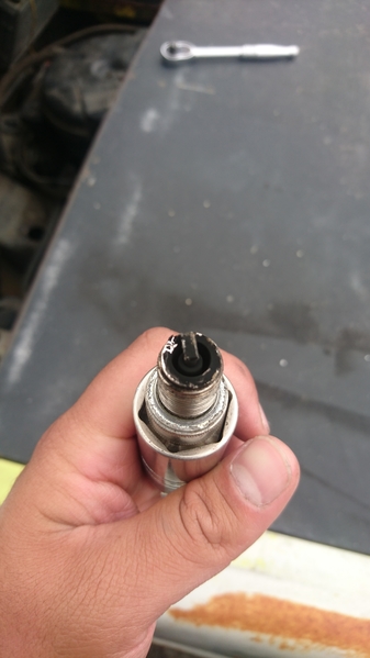

QUOTE(averagejoe71 @ Jun 7 2017, 10:19 PM) *
The plug looks like you're running rich. Was is dry or wet?
... and yes, the cold start valve is attached at the front of the air plenum near the oil filler - it has two fuel hoses running to it (red thingie in the pic) (IMG:style_emoticons/default/rolleyes.gif)
(IMG:http://www.914world.com/bbs2/uploads_offsite/www.pelicanparts.com-7300-1496940530.1.jpg)
You can unplug the electrical connector and see what happens, and if that doesn't help, physically bypass it by removing the hoses and joining them together with an appropriate sized tube and tighten the hose clamps.

They were dry and I'm trying to find the valve right now. Also what is this since mine is disconnected.

That's your Auxiliary Air Valve (AAR) or sometimes called supplementary air valve. That lead is what warms it up so it will close after about 10 minutes of engine running. It is there to provide additional air the engine needs when cold (it is sort of a controlled vacuum leak that shuts itself off after roughly 10 minutes). If yours is disconnected your AAR isn't going to close (or at least not as fast as it normally would). That means you'll have a higher idle for longer than necessary. Given you're probably running too rich, that's probably somewhat off-setting the AAR not closing quickly (assuming the engine will run that long). Also, I believe if you ground that lead (hit it against something else) it's going to blow one of your fuses on the relay panel (IIRC) (and then your fuel pump won't run). I may be incorrect, but that's what I seem to recall. In any event, either hook that lead back up or don't let it ground with the car running.
The plugs look sooty. My guess is still too rich. I think the cold start valve is possible culprit (or one of them), but it's more likely CHT, MPS, or fuel pressure. Those just seem to fail most often and/or cause a rich condition that will actually kill the engine as it warms up.
