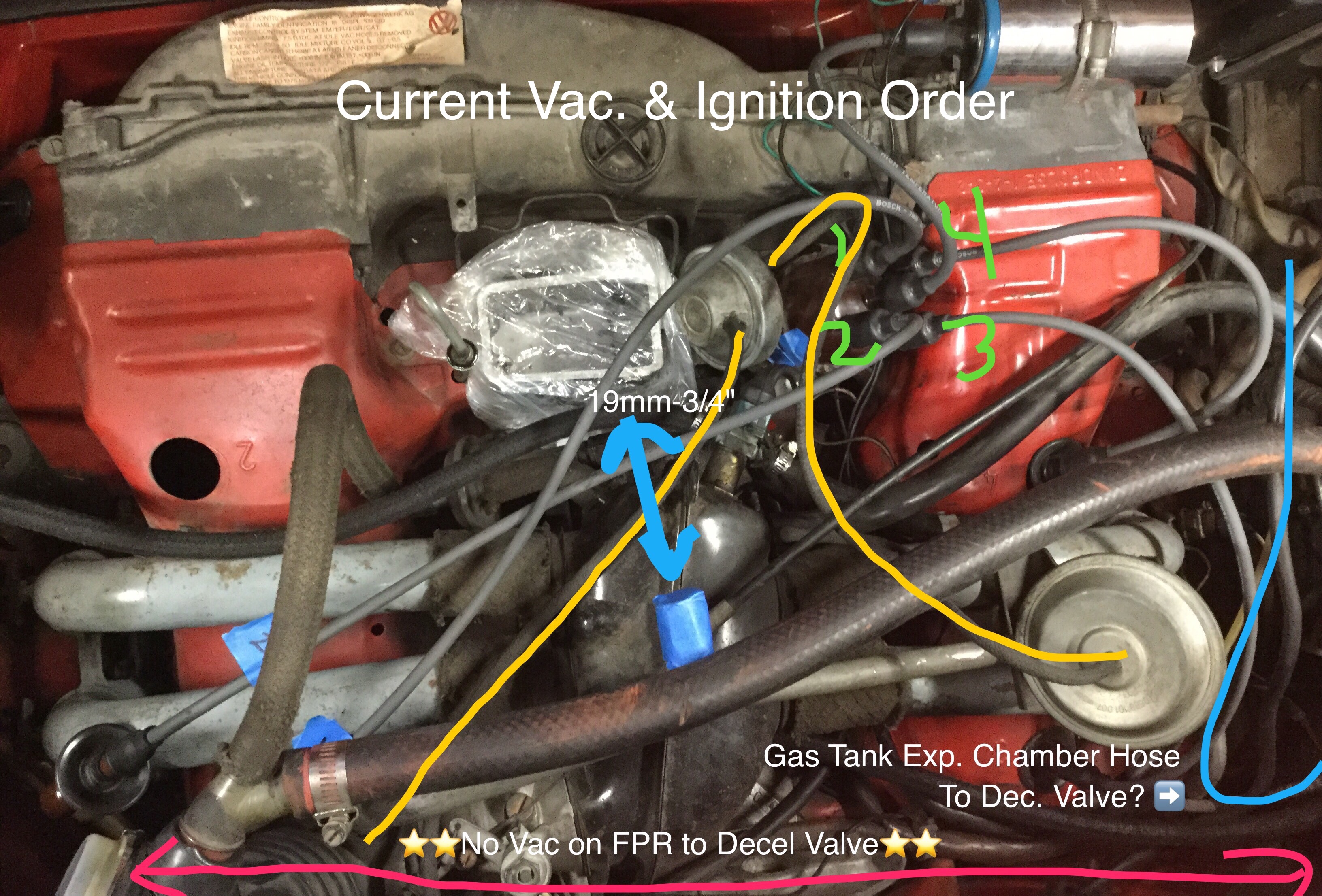

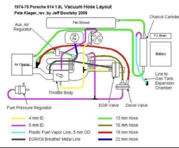

Tried to search the forums and Haynes and got some info. but still need some answers. I need some advice or some 1.8 l-jet owners or knowledgeable enthusiasts to look at my work before I place an order. Long story short several vacuum lines are routed wrong , there is no charcoal can, and cannot find spark plug wire order.
1) What are the negative effects of having a no charcoal can? Fuel consumption? I hear the l-jets are sensitive to hose leaks so can I plug those that are attached to the can?
2) Spark plug wire order. I want to double check if they are routed correctly.
Ed_Turbo
post Aug 9 2017, 05:34 PM

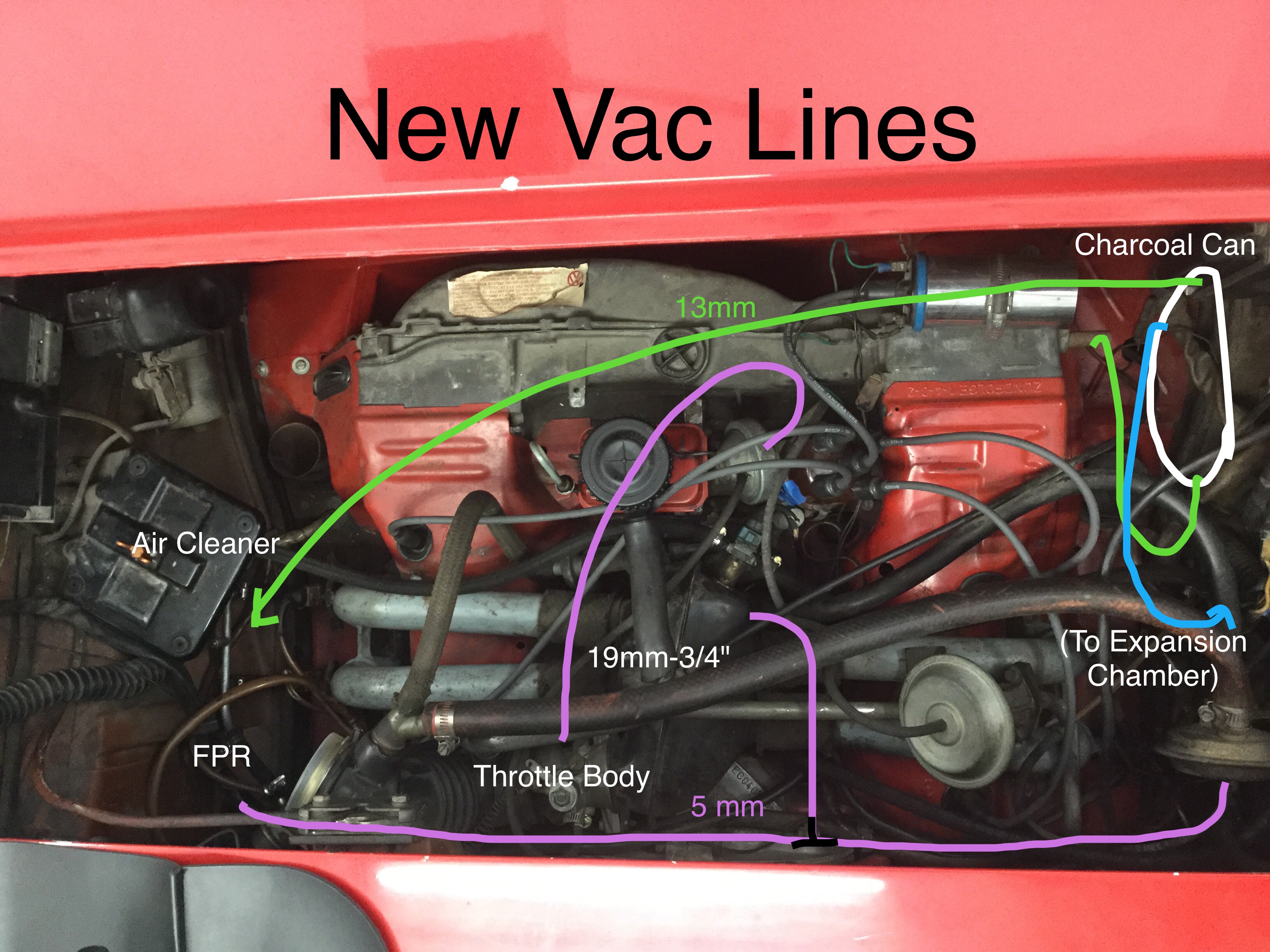

New routing diagram:

QUOTE(ndfrigi @ Aug 9 2017, 09:36 PM) *
Yeah that is where I got my info. from (IMG:style_emoticons/default/clap.gif)
Anyone know about charcoal canisters? Can someone check my spark plug wire order? I think #1 and #2 are wrong.

QUOTE(Ed_Turbo @ Aug 9 2017, 10:29 PM) *
1. Charcoal canister is ok even without it. Does not affect the engine. It is just to lessen or remove fuel smell. That plastic (expansion tank) on top of your tank has a small diameter hose that connects to the charcoal canister (for 1975 it is at the engine bay). two larger rubber hose In and out of charcoal canister. In side goes go upper right of fan shroud (blows air going to charcoal canister and other side (out) goes to air filter.
2. Your engine picture with your number markings is correct. Assuming your TDC (#1) is in the right position.

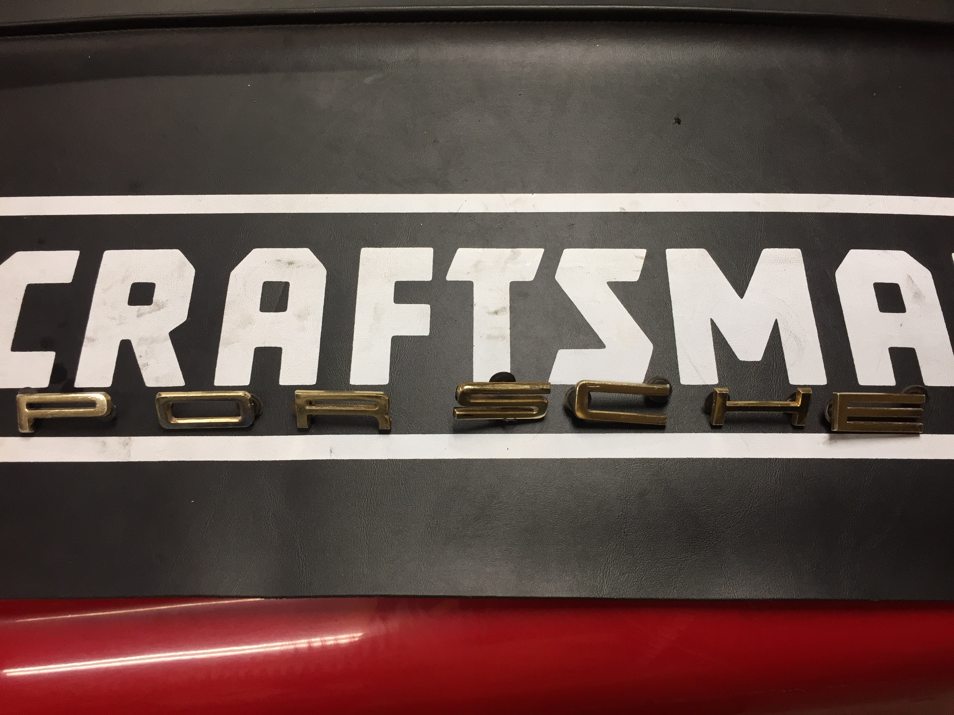

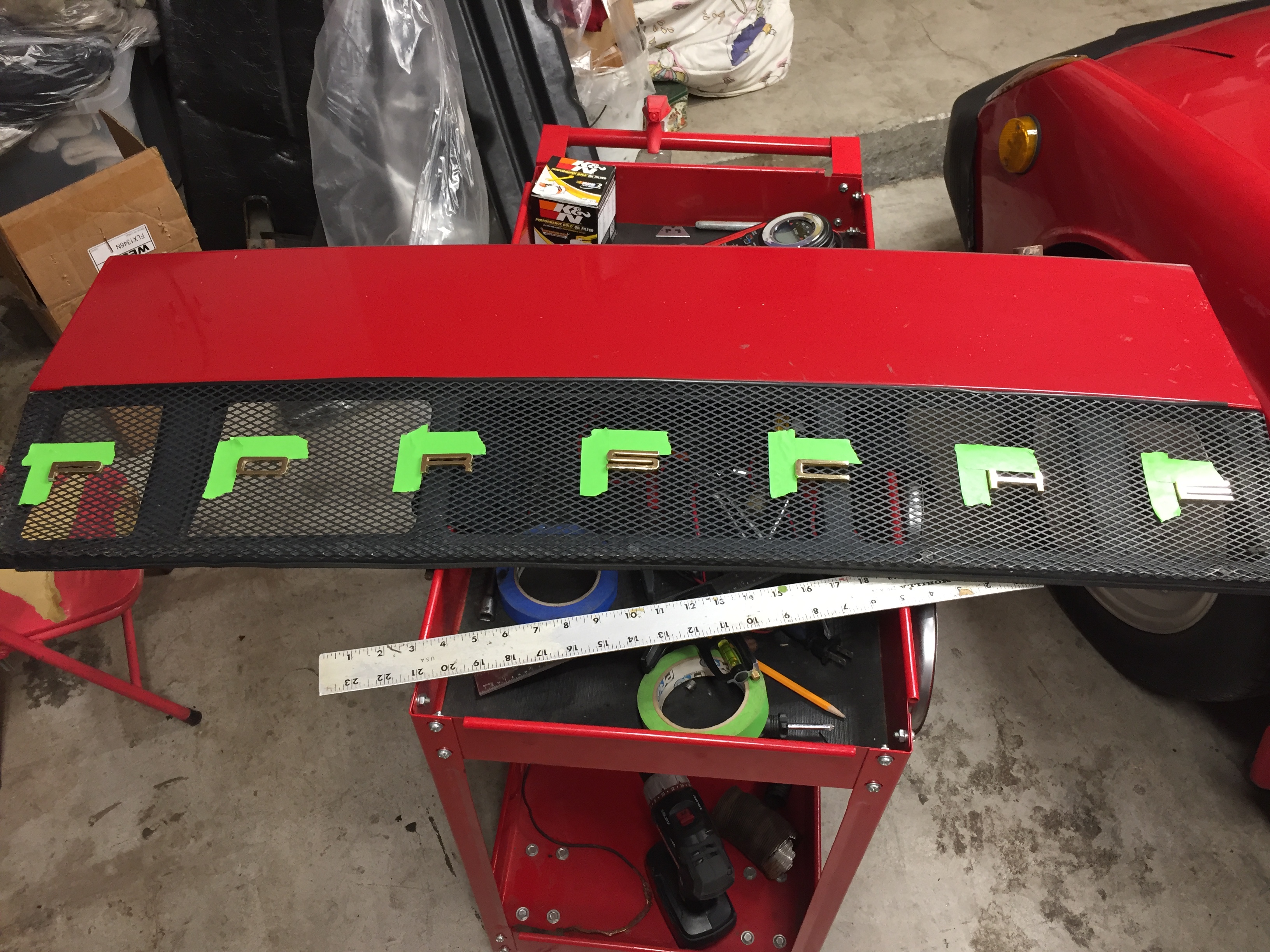

Great news! Got the bad boy running. Changed FPR and fixed vacuum lines. Also, I found the emblems for the grill. Check them out! (IMG:style_emoticons/default/drooley.gif)

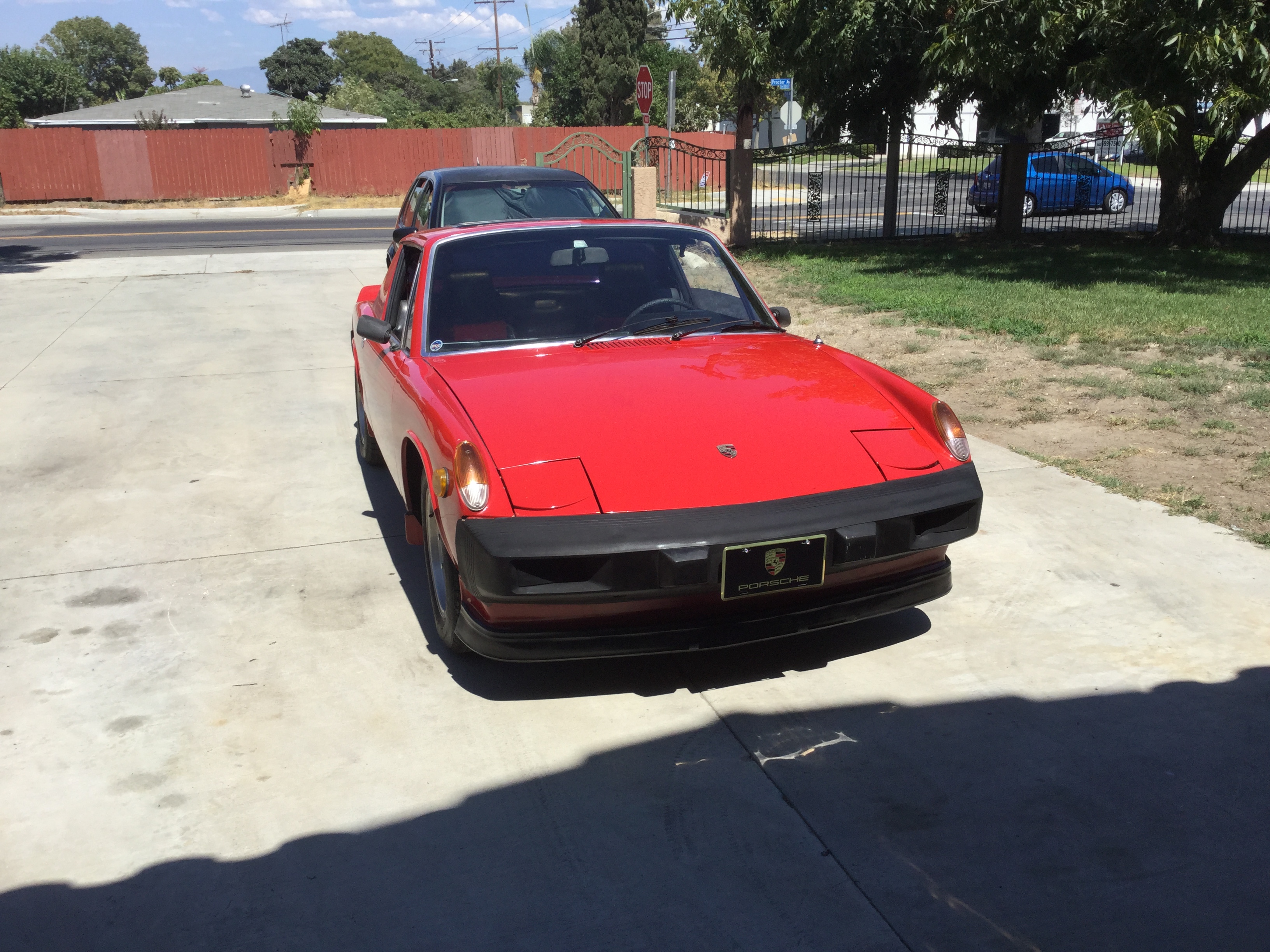

Quickie update because the heat is killing me working in the garage (even with the fan on).
Changed a bunch if stuff like window crank, pulley , and gas pedal. Waiting for several parts in the mail. Going to put that in my checklist for next weekend.
Adding the emblems and attach the grille soon:

Also, before I forget we gave the car a wash and two stage wax: 1) Unltimate Compund (color & clarity restorer) and followed by a wax.
