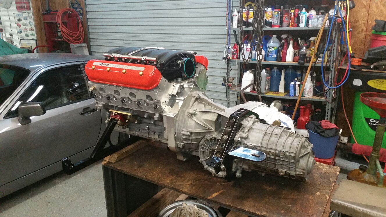

What about this option,
https://www.wevo.com/Products/TransmissionP...15SideShift.htm (IMG:style_emoticons/default/lol-2.gif)
Cracker
post Oct 12 2017, 03:52 PM
Posts: 2,148
Joined: 2-February 10
From: Atlanta (area)
Member No.: 11,316
Ron,

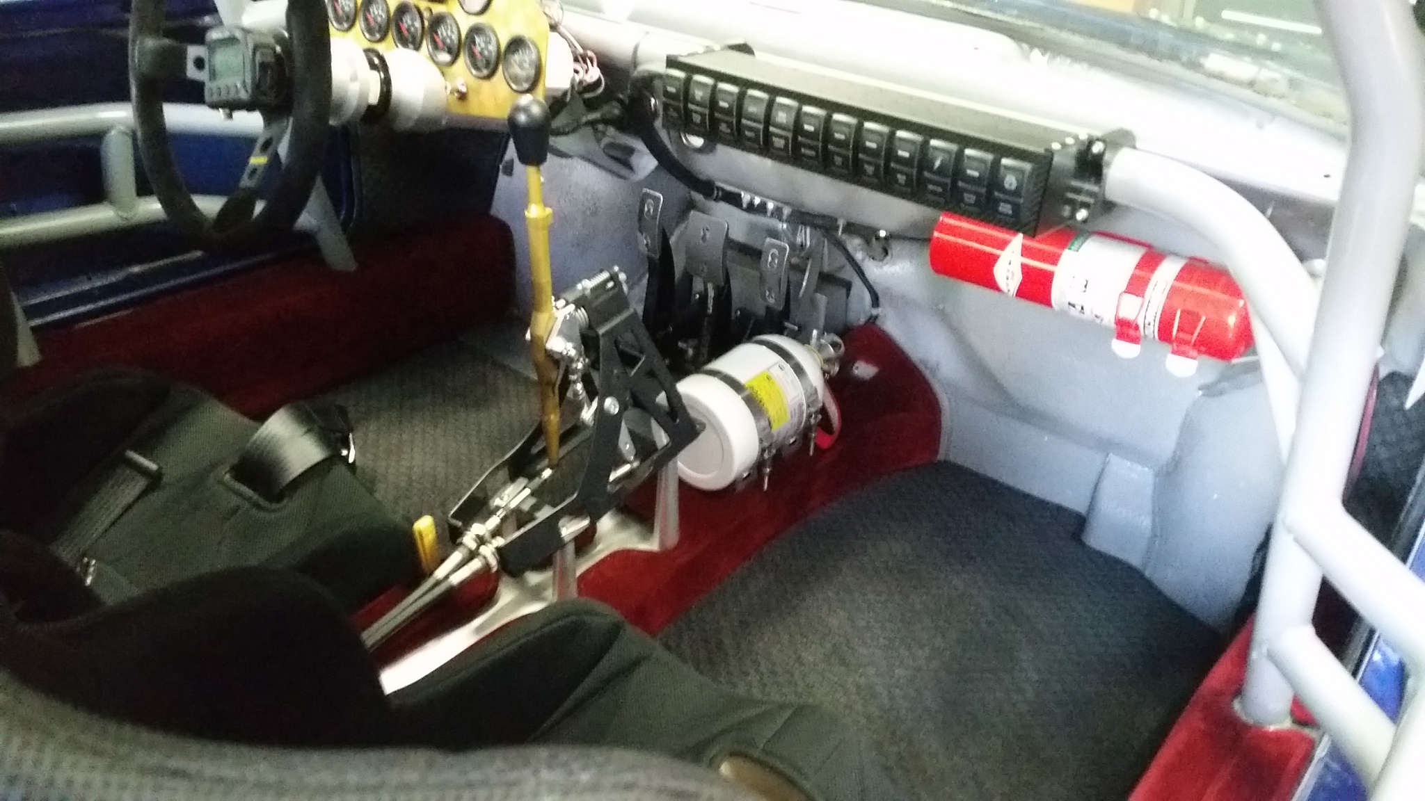

Converting the shift method that was originally a mechanical rod system to a cable system does not make it shift better - rather, just different. What inherently creates the poor-er shift is internal - not the method. I currently own a G-Box prepped G50-52 box inverted with all the bells and whistles - it still shifts like an old box regardless. I have attached a video from our first track weekend and check out how QUICKLY and EFFORTLESSLY they occur - that simply is not happening with a 915. I have had this video "locked" for quite awhile now - it is no public. However, based upon your inventory of 915 bits, I would think it makes sense to just stick with that moving forward. It was fun at least to think about...
Regarding my set-up...the actual shifter is made by CAE out of Germany. Since the G86-20 actually can easily be adapted to my engine - it is a no brainer - not so easy for you.
The reference to AC engine = Air Cooled.
Tony
https://www.youtube.com/watch?v=pTgOCuiczAE
