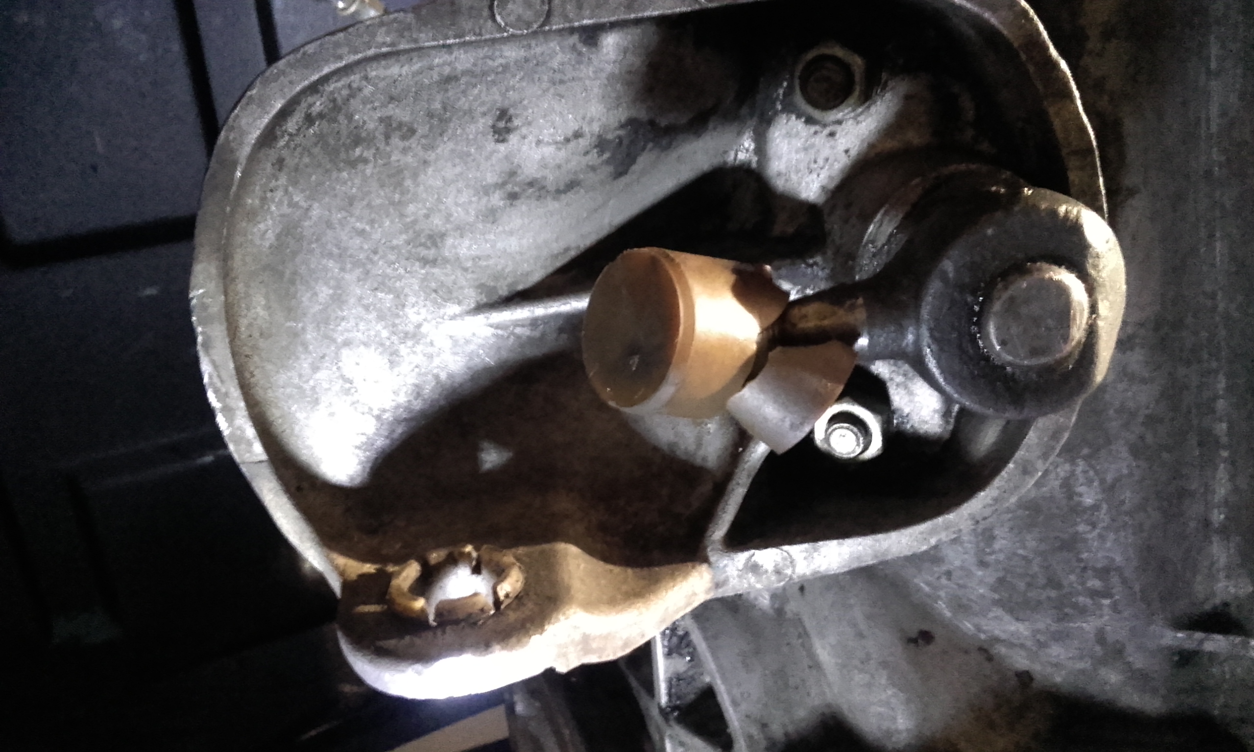

Is the crumbling part pictured, part number 914 303 121 01?

This might help. (IMG:style_emoticons/default/smile.gif)
http://shop.914rubber.com/91142413900-Ball...91142413900.htm

Replace the other bushing in the housing wall while you're at it. (IMG:style_emoticons/default/wink.gif)

Looks crunchy .................. LOL

At $3.20 pick up a spare. (IMG:style_emoticons/default/biggrin.gif)
Also have all the other parts cheap. Might as well replace all the bushings too.
Looks like the guide bushing is bad too. Oh they're $2.99.
Neaver been cheaper.
I'll put together a package for ALL the late side shifter bushings for $20
2 -911.424.139.00 ball cups
1-914.424.224.02 trans mount bushing
1-914.424.224.03 firewall bushing
1- 91442423902 side shift bellows
2-911 424 223 03 shift knuckle bushings
I'll also offer the ability to add the cover and band for another $20 if you add to the GB $40 total)
Only catch need 10 takers for a GB.
I'll post up a thread.
