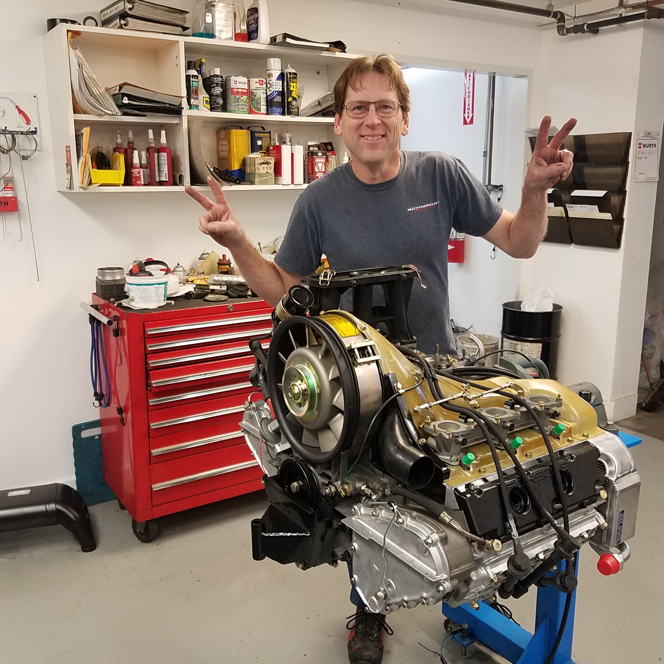

Look who's in the #1 spot in the Rothsport Racing engine room. (IMG:style_emoticons/default/biggrin.gif)
Jeff said the intake/induction goes on tomorrow.

QUOTE(cary @ Oct 3 2017, 07:14 PM) *
Now that got my attention big time...

QUOTE(cary @ Oct 4 2017, 03:18 PM) *
Jeff Gamroth, owner of Rothsport, in the flesh....
Not much this shop can't do.

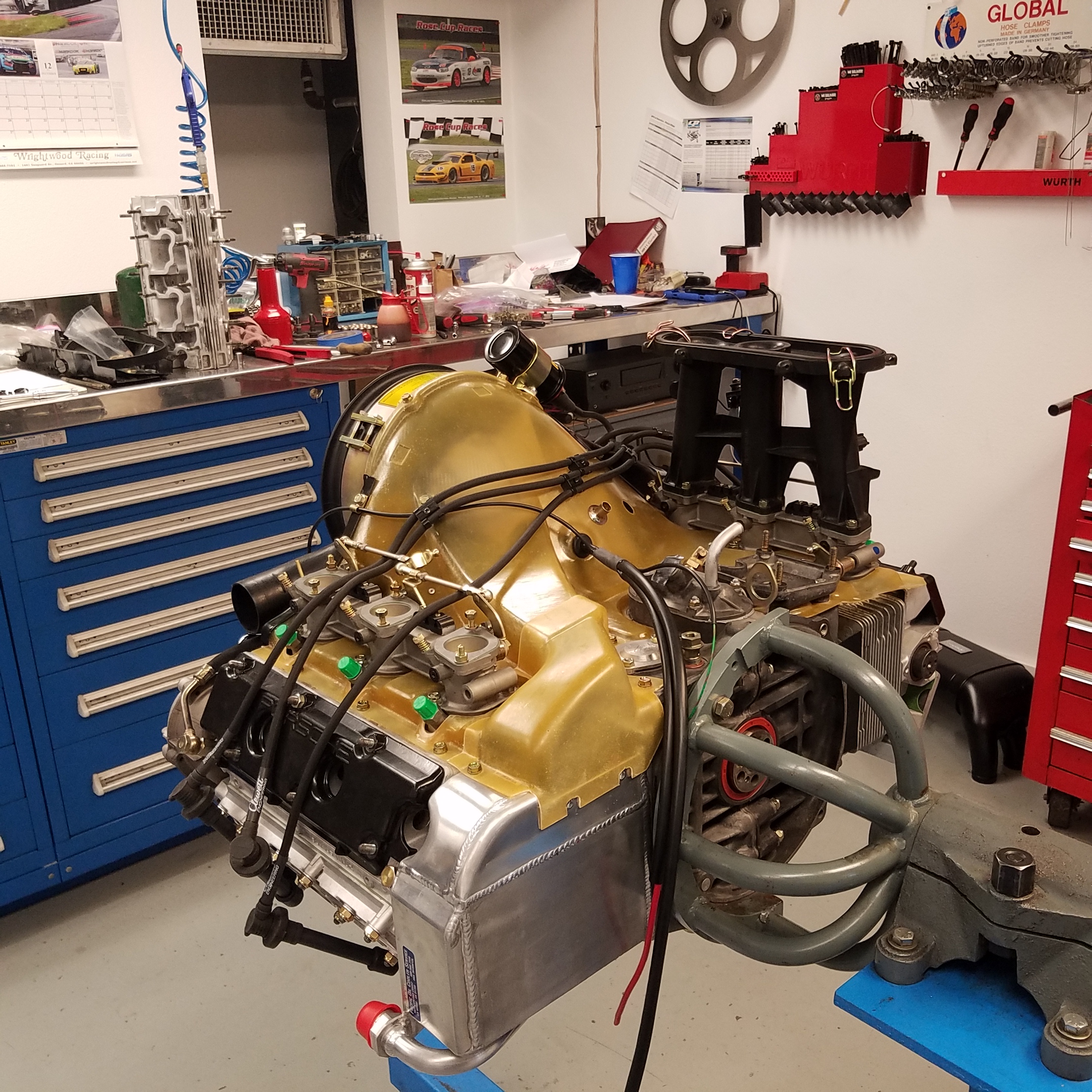

More Rothsport porn ..................

QUOTE(Cairo94507 @ Oct 4 2017, 03:50 PM) *
O yea that is a thing of beauty.
Bob B

Member No.: 17,068
THAT'S not a complicated induction system.
Looks so gorgeous.....!!!!!!!
