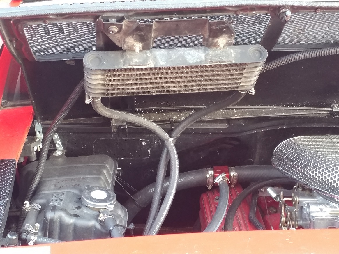

I wanted to give an update on how I DRASTICALLY improved the cooling efficiency of my car. No electric water pump or 4 core radiator needed.
My engine originally came with an oil cooler installed (Chevy pickup). Unfortunately; the cooler was ruined after the truck wrecked. I kept the oil cooler adapter installed on the block and just capped off the ports on the adapter.
Fast forward years later and after combating a constant run hot situation on my car; I decided to go through my parts bin and install an oil cooler I had from another project.
What an incredible difference! My car is now running a consistent 20 degrees cooler... without touching anything else! It's a miracle I tell you!
Anyway; I have it mounted on my engine lid right now. Is there a better place to install it for more efficient cooling?

More details... Right now, I have the fan set to come on at around 170 (I will be adjusting this). Driving around town or at freeway speeds, the temp has yet to go beyond 185, which is OK with me, especially compared to what it was before. Twenty degrees higher and it was fast approaching the danger zone!

I'd put some muffin fans under the cooler blowing upwards. Maybe wire them into the rad fan circuit.
These fans are those square fans found on computers and other stuff.

I'd probably fit 2 maybe 3 fans. Find a fan the same dim as the small dim of the cooler.
There are tons of electronic surplus places, I'd hit them up first. Along with a place that scraps out computers. I've seen Dell towers have a fan that looks to be sized right, not sure of voltage though I's expect 12V

Granted, I could tidy it up a bit; somehow but everything there is what's needed... expansion tank; heater core for our cold Idaho falls and springs.
It will stay like this for now. Next summer; if the coolant temps get too high when it's 100 degrees out; then it will be time for a 4-core rad and electric water pump setup! But considering where I came from with my constant run hot issue; the addition of the oil cooler definitely made a huge difference!
